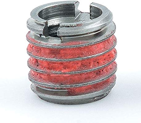

  21. I heard that man, variety is the ****e of life :) have you ever used these inserts? 51ZdR38orZL._AC_SY400_.jpg

  23. Stephen Barrett
    Joined: Sep 24, 2019
    Posts: 878
    Stephen Barrett
    I haven't but I think I might need to use Big Serts in the hole because it's so messed up. At least from what I can see the stud isn't broken off in the hole so I don't have to deal with that. I'll let the machine shop deal with it. My main goal now is get the new motor in.

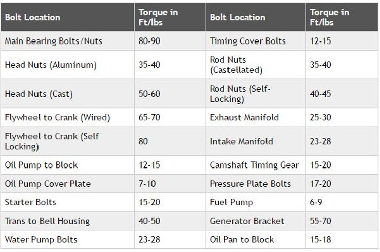

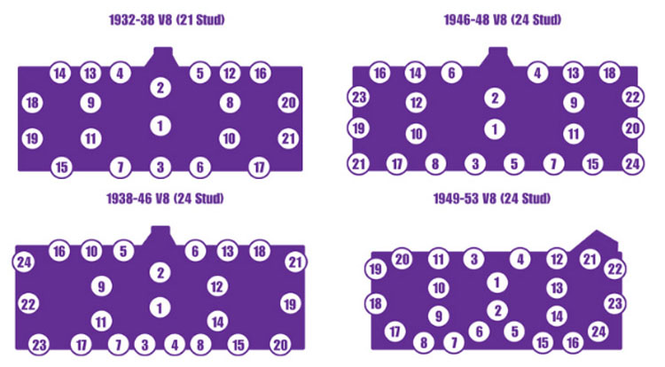

  26. What's the head nut torque specs on that flathead?
  27. Stephen Barrett
    Posts: 878
    Stephen Barrett
    Found these very helpful. 325_ArticleSection_XL_8e82bca6-e843-487f-af7d-ded7214bcd75.jpg 3115_ArticleSection_XL_a2dad57c-a6c8-4166-bf03-a25b7b8152f5.jpg
