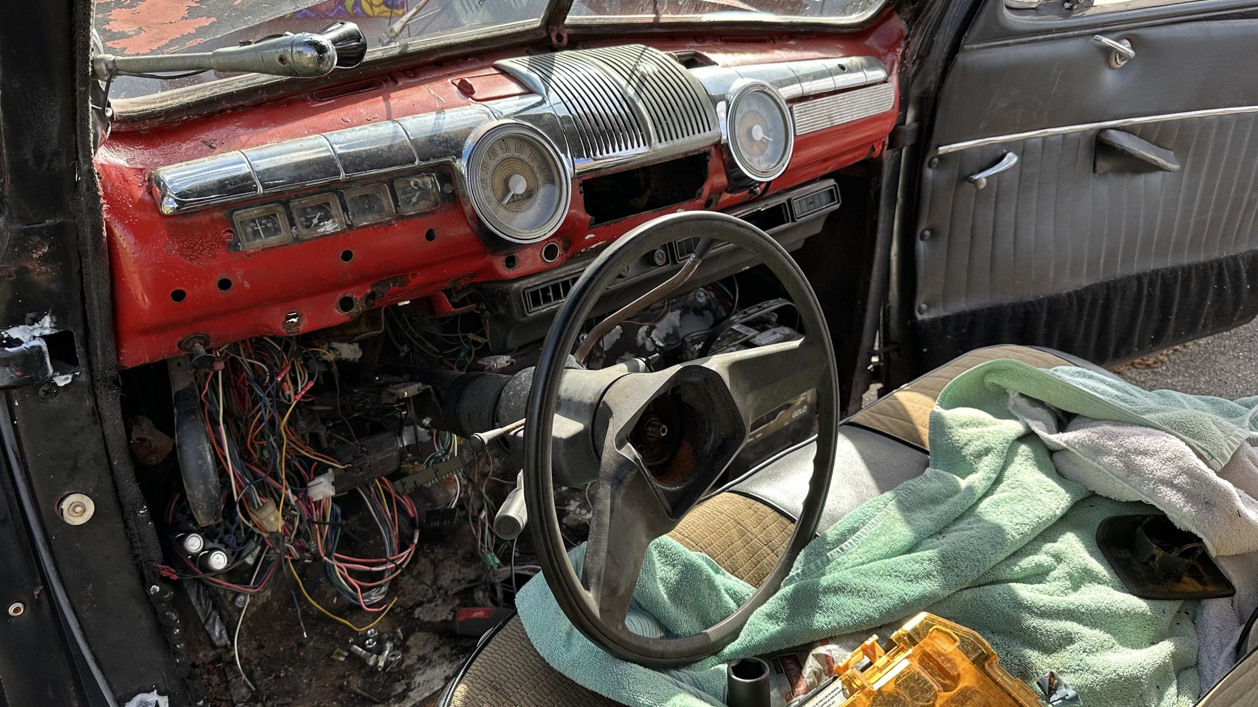

    I’m trying to figure out what the front clip is out of. It’s GM, has disc brakes. I figured the steering wheel would be a good indicator. Any ideas?

    [​IMG]The steering is in front of the crossmember too.

    Chevy G van?

    Damn! You’re right, that’s a G20 steering wheel. I doubt that front clip is g20 though.
    I guess I need to dig more and get more details.

    Chevy van front ends actually unbolt fron the body(/ frame ) I can’t remember the width, some could be installed easier than a mustang 2 . Get some pics . It was common to use a camaro , nova , etc front subframe and weld the old frame to the subframe.

    `That's funny thinking the steering wheel ID's the sub. My cpe has a Nova sub, Buick FWD column and a Lacarra wheel

    Yeah, I just figured it looks like this car hasn't really been touched since it was pieced together, but I know what you mean which is why I included pictures of the actual clip. The steering column is definitely squarebody which is good to know since I'll need to rebuild it. The plan is to get it roadworthy on close to nothing which it's pretty close. The PO said it was a camaro clip, but I'm not sure, he also got it in on a trade. Any ideas on how I can ID this clip?

    This is why I figured looking at the column itself might give me a good idea of what I'm working with. My guess is that everything came out of the mystery donor car although I've had no luck of identifying that fuse box.

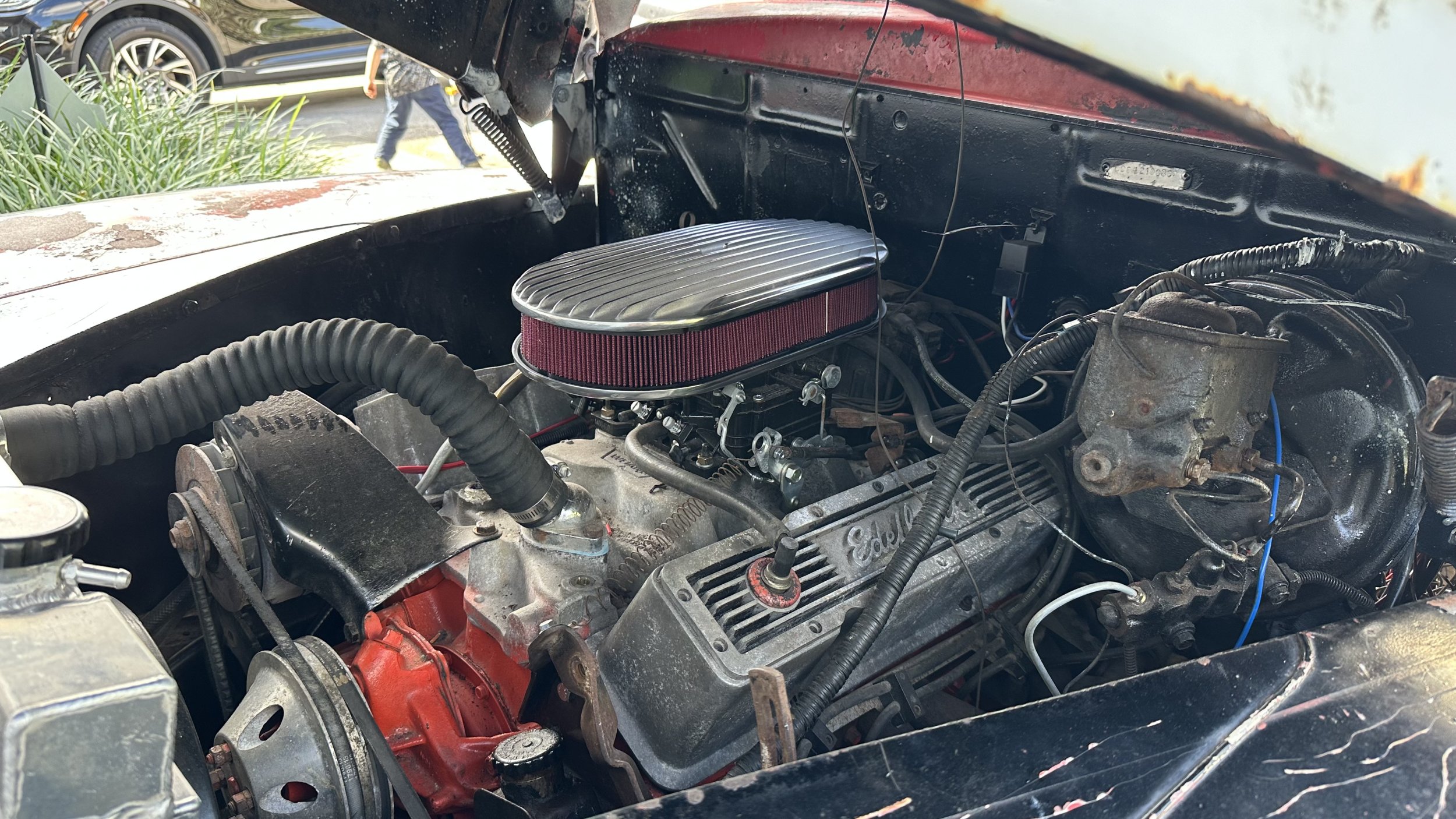

    Deuglification/rewiring/rust repair has begun! I need to buy a new welder as my old Miller got mice a while back and they chewed it up pretty good. Picked up this air filter, now I’ll need some valve covers to match! In time I reckon. Let’s get that dash cleaned up and the car rewired.

    I bet it’s a van subframe. The steering wheel isn’t exactly square body chevy that I’m aware of, but it’s close. The blinker cruise control stalk is more or less identical to a 1985 Buick park avenue (my mom had one). Best guess mid 80’s van
