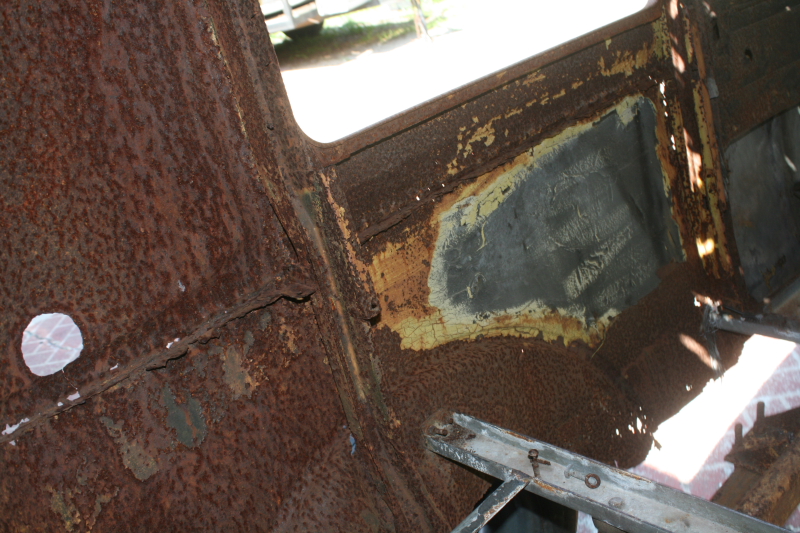

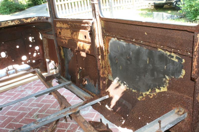

    Well here it is, its mine! It is very rough, I have not done anything that needs this much work. How do I deal with this body sand blast, Ospho and body filler. Any suggestions would be appreciated. It is very pitted and the metal seems thin but still I have not done a car this old. I have not touched a car this old. Imagine that never touched a car this old. WOW :eek:

    If you are going to sand blast, I would set the air pressure real low. You can consider the use of fiber glass cloth over (or under) the existing metal to maintain the shape and then use filler to smooth. Good luck. Keep us informed.

    Here is what I would do. I'd get me some wood pallets and make a sort of hillbilly dippin' tank. Get some thick plastic and cover the pallets. Throw the whole rusted works into it. Fill up with some water and pour in some molasses (but be sure to clean off all the oil and dirt first). Soak it for a few weeks, take it out and insta rust free A sedan :) The molasses mix with only eat the rust and unlike white vinegar will not keep eating at the metal. It takes a bit longer but I think when your dealing with thin metal it is best to find a gentler approach to it rather than blasting it or grinding it.

    Advice? ...don't spend a dime on any parts until you make some progress on the body. What I mean is not grabbing cool gauges, driveline and other stuff first.
    I'd blast one quarter inside and out, then see if it's too far gone to weld panels on. If you save one quarter, keep going. But don't even think about buying anything besides what you need to patch the body shell.

    Been there, done that. Sell it and spend the money on a solid body. Trust me.

    I hate to discourage anyone from doing anything they really want to do, but I have to side with Rob on this one. The pics clearly show that it's unfortunately a cheese grater from top to bottom. Too far gone for anything short of an extremely rare car.
    On the question of methods of saving something is this condition, careful media blasting small areas and following with spray weld to build it back up seems to be the most current method. That is, if we were talking about a Pierce Arrow.

    The dash rail looks great! The rest? Well, not so much. You will have so much time and money in it that you'll regret it in the end. Move on, and find a better body. Good Model A sedan bodies aren't that rare.

    Yeah, for a guy who has no experience with old cars, you got yourself a HUGE project. I've been welding and doing body repair for decades and I wouldn't touch that car with a ten foot body hammer. Cut your losses and find another body without big holes all over.

    Looks the most solid part of that car is its shadow! Id look for something a little better.

    I wouldn't media blast it. I would wire wheel the back of the panels to remove the flaky rust. I would then soak the steel a small section at a time with Evapo Rust. Once I had clean steel, I'd butter the back thin in the worst areas with MAXIM fast set body panel adhesive epoxy. I usually mix it on a board and spread it like bondo filler. That might save you a lot of steel reconstruction. Evapo rust is @$20/gal, the epoxy is @$30 for a caulk gun size tube.

    If you already own it, nothing would be wrong with taking little bites at it. Just remove one panel at a time, replicate it or repair it. Might cost you more than replacing it in the long run, but nibbling away at it for $50 a week wouldn't seem so bad. I've bought a $100 sheet of steel that's kept me busy for weeks. 1" tubing structure would be a must either way, so why not. If it was easy, everyone would have one.
