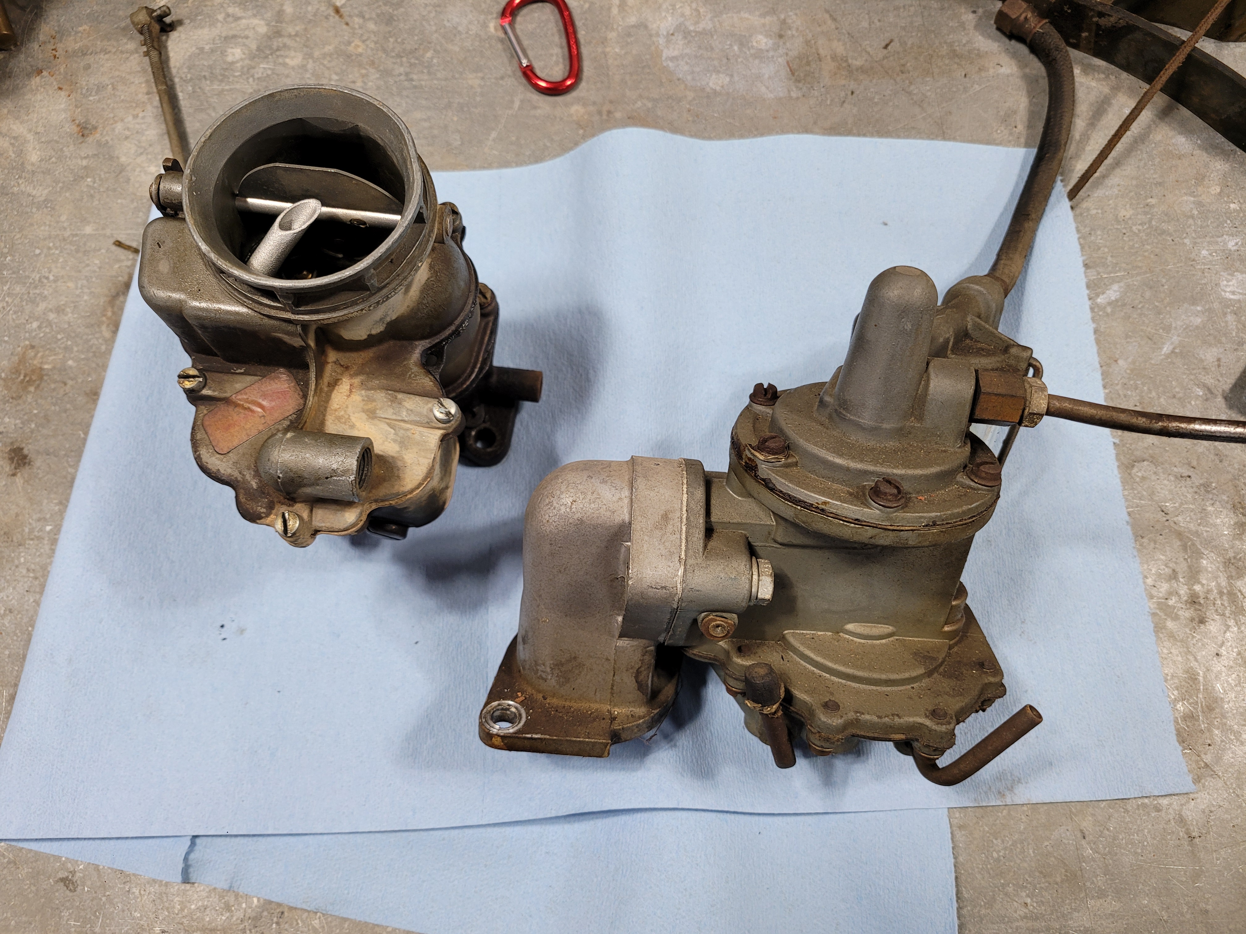

    Pulled the carb and fuel pump tonight. As expected there was no push rod under the pump. I plan to just plate of the fuel pump hole and go straight to the carb. I have a non return fuel pressure regulator on the way as well.
    Also I'm trying something new...mostly because I'm desperate but maybe it'll be a good learning experience. All the years I've been playing around with old junk I've seen guy use electrolysis to pull rist from gas tanks and all sorts of stuff. Well I'm going for it on this tank and see what happens. I degreased it and threw a fused setup together. After the first hour it seems like it's working.
