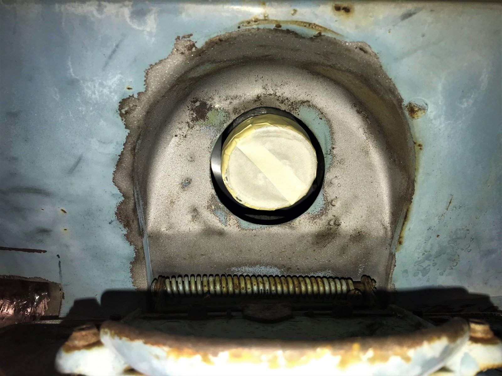

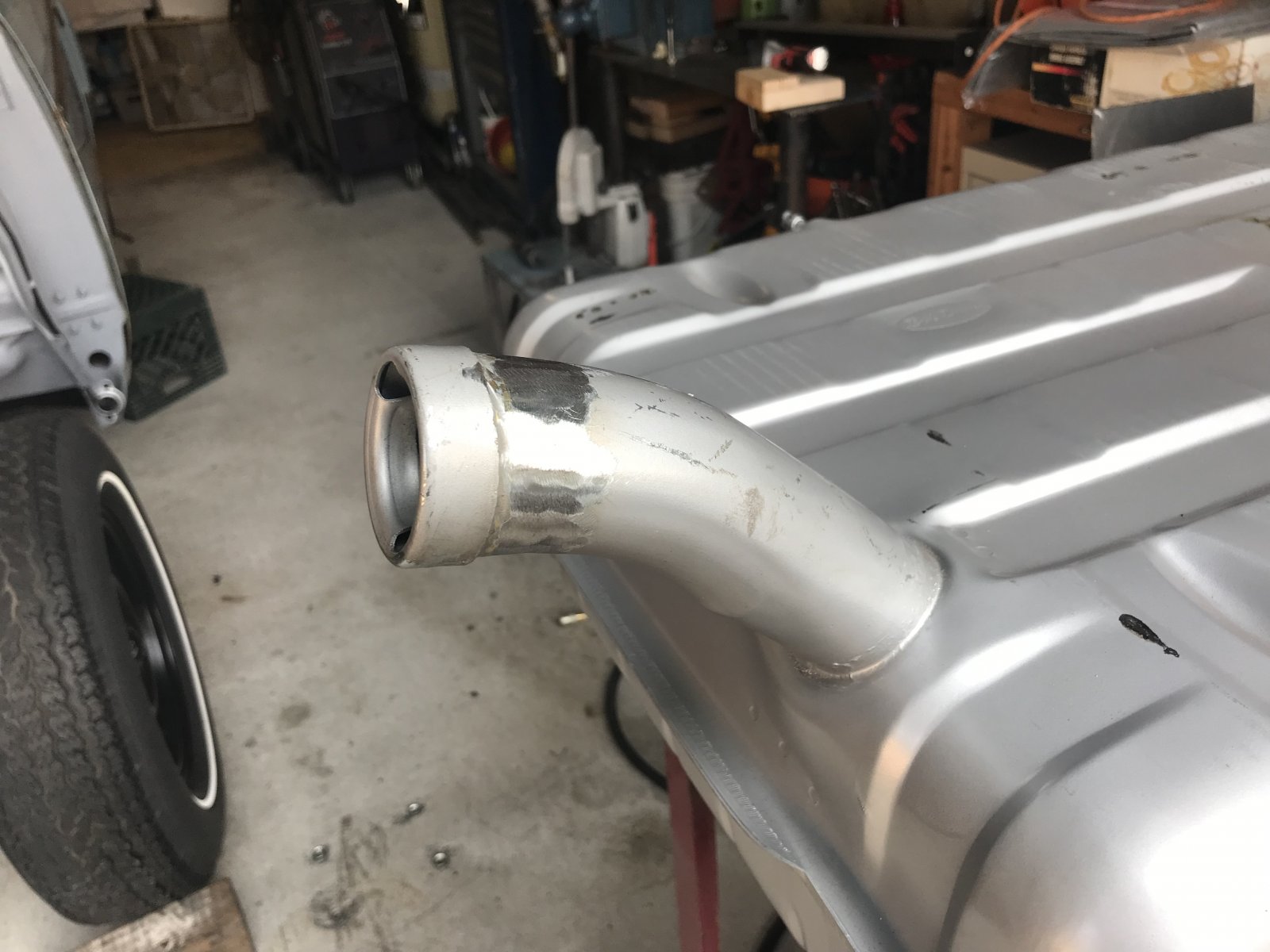

    A cheaper way to replace the gas tank is to go with a '55 tank. $230 vs $400.
    https://bobdrake.com/products/1955-car-gas-tank?_pos=2&_sid=c3ea701b5&_ss=r
    The '55 tank is slightly larger, 1/4" longer, 3/8" wider, 1-1/2" deeper plus it holds 19-1/2 gals vs. 17 gals for the '52-'54 tank. The '55 tank comes with an electric fuel pump provision but it also comes with the block off plate. Mounting is fairly routine. The mounting straps need to be extended. Just shove the tank up in there, use your original mounting straps plus the straps that come with the tank and weld the two together. Also, the filler neck will extend just a tad too far out and needs to be shortened for the license plate door to close. I did this on my '54. Easy, peasy!

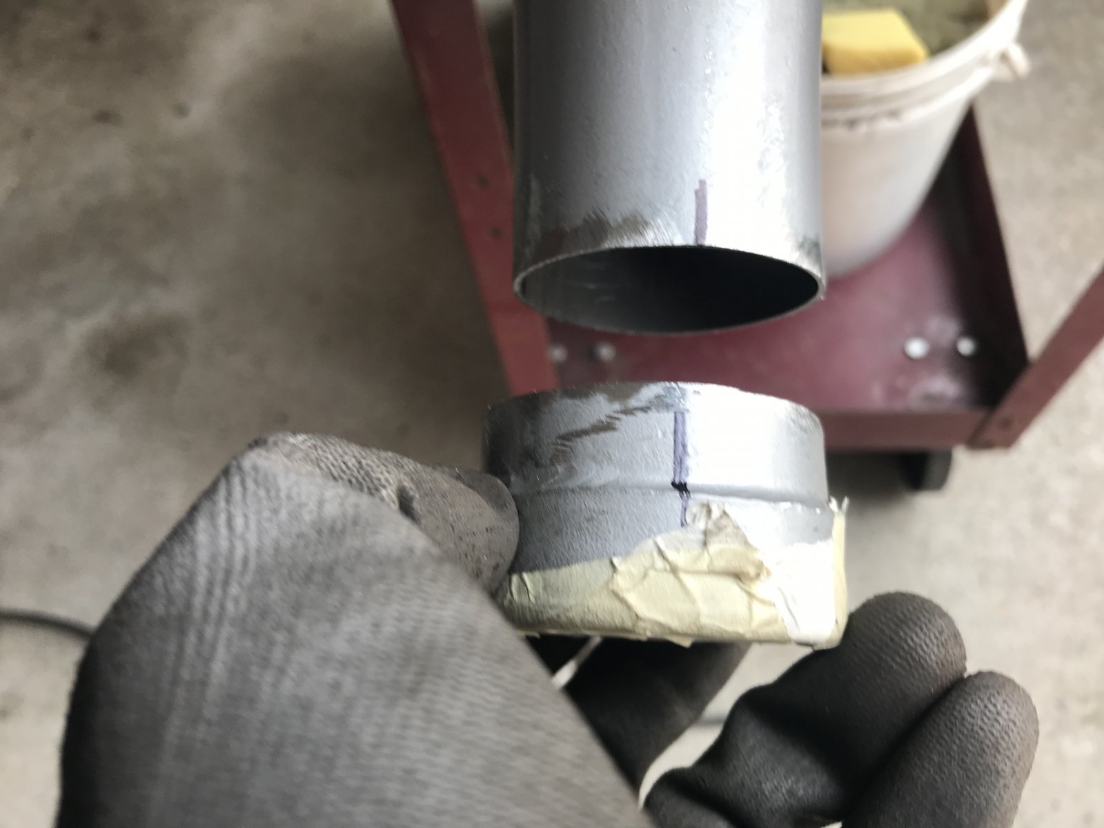

    You are a lifesaver! Shortening the filler neck will be easy work for me. I appreciate the help.

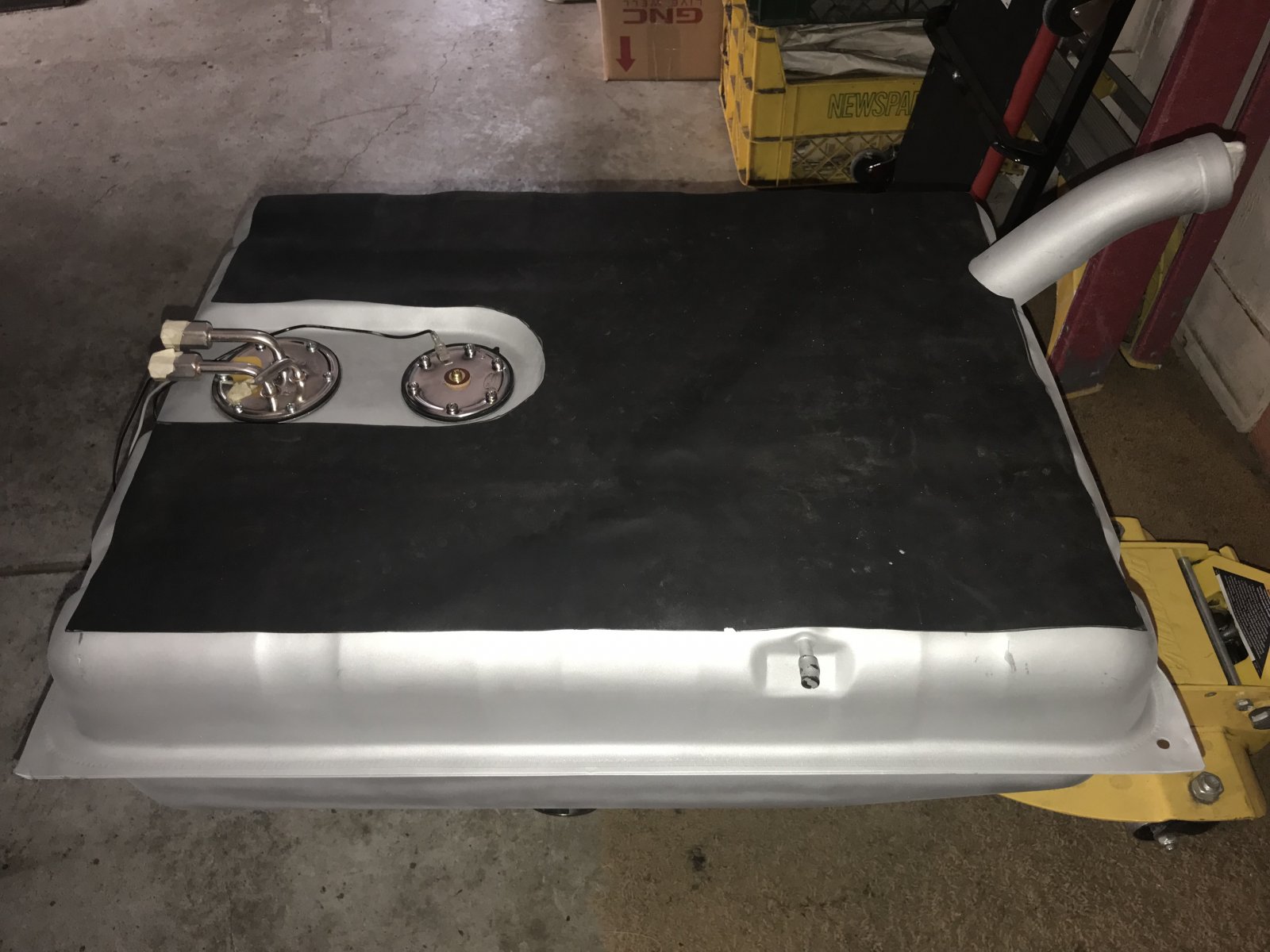

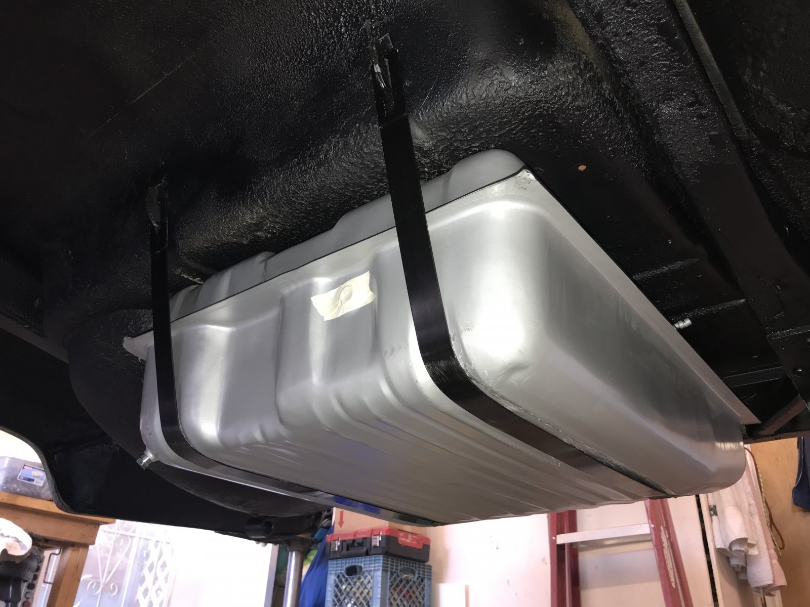

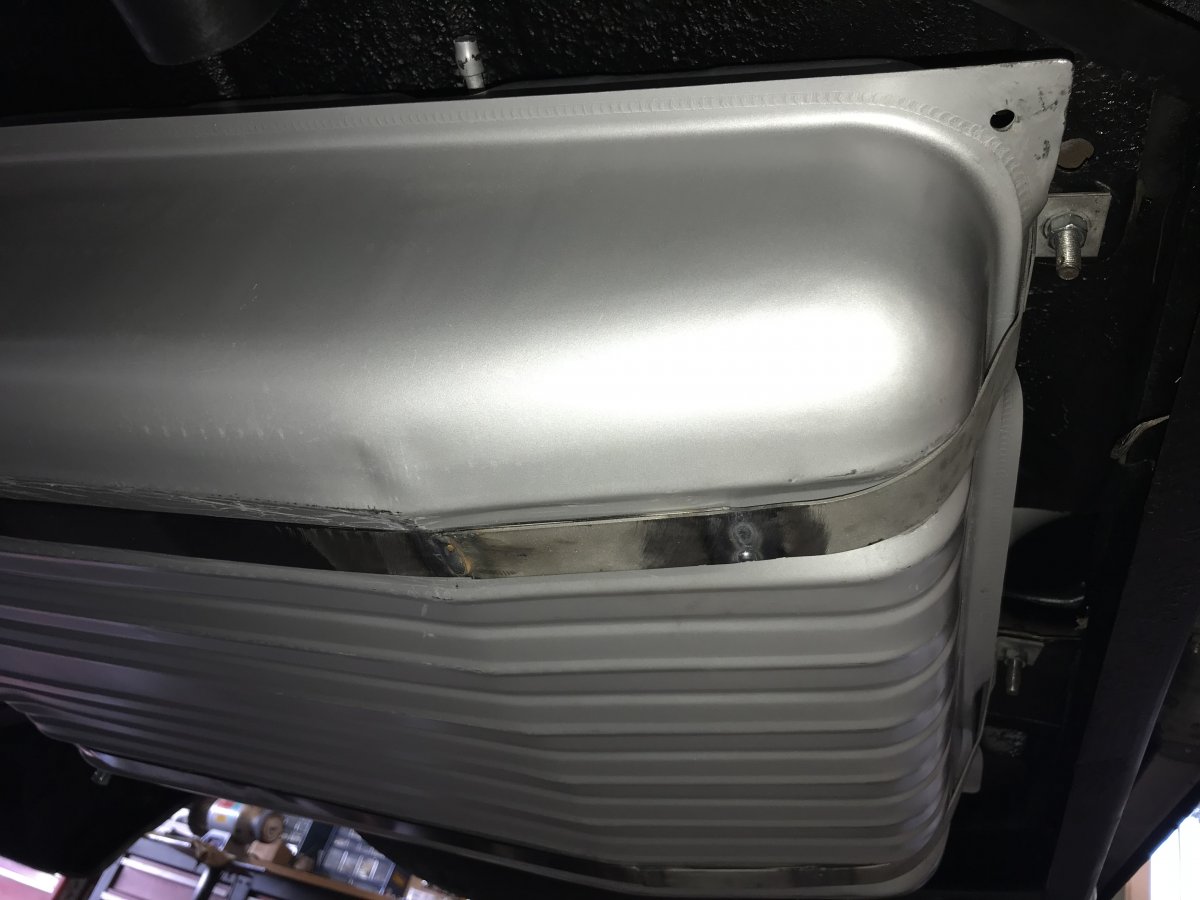

    Fuel tank is in and new fuel lines from the tank to the carb. All 3/8 steel. Fuel pressure regulator in and set to about .5 psi while running. Had some stuck in the needle on the first fire and flooded the engine pretty good. Solved that and still can't get my cheapo Mr gasket fuel filter to stop leaking. Figured for 12 bucks what the heck right?
    I decided not to place the regulator on the block off because of the way plum info would have worked out. It just would have been neat looking. I need to get another filter on the way and I'm in the hunt for an old school fuel pressure gauge to replace the one I have. Also the choke cable all bent and not adjusting easy so that needs to be delt with. A little bit of carb tuning will be in order but for now she's starting and idling on her own will power so that's progress.
