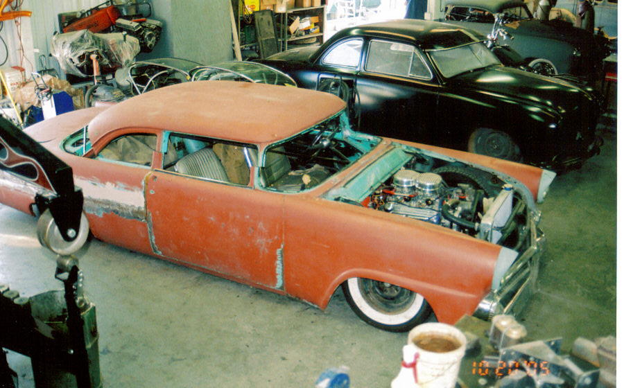

    Did you ever finish that sectioned 55 Ford?? That car is bad ass!!

    It's not done but it's drivable. We took it to the midnight mass 50 chevy took some pictues I will try to post some. Scott

  11. How much was the chop and is the glass cut from the bottom or top?

    4" chop but we cheated and sunk the glass. If we cut the glass I think we would have to cut from the top. because the glass would get to small for the opening. I have allways had glass cut before this car. But it 's my partners car and thats the way he wanted to do it. Scott

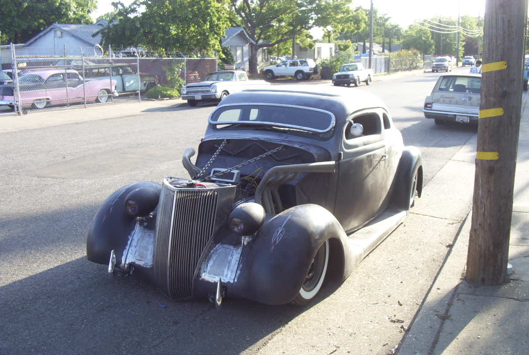

    Did that guy ever change the headers on the '36 coupe?

    Yes I did a one peice hood on it and and had the headers droped below the belt line. Then droped the exaust through the fenders and ran it out just in front of the rear tire. I don't have any pictures of it but it was at Billet proof there could be pictures of it on his website. Scott

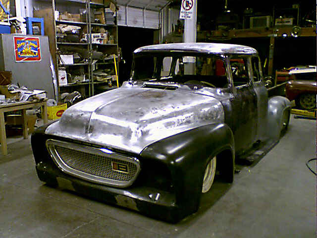

    sup Scott!!! what's the story on the truck. Extended cab? That thing looks crazy! I love Phil's ford too! He's got a great eye for style (obviously)

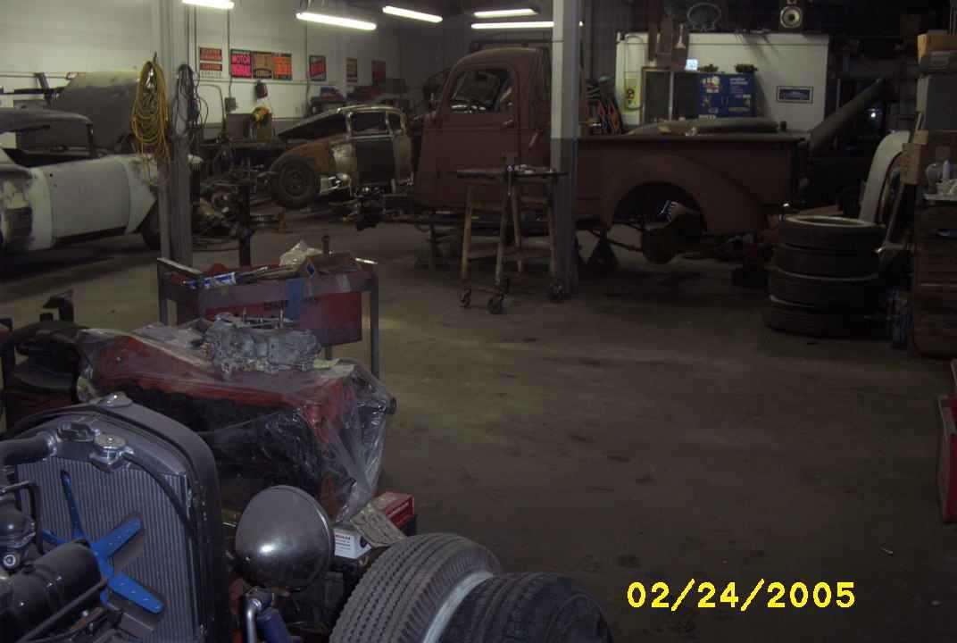

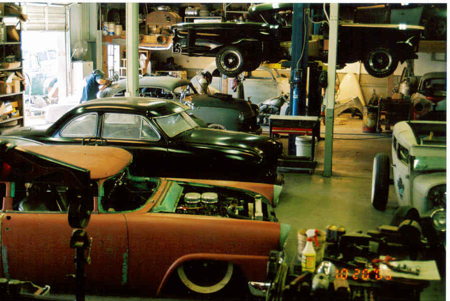

    hey scott-
    good to see pics of your shop and sh*t!
    Looks like you got a real chop shop goin on in there.

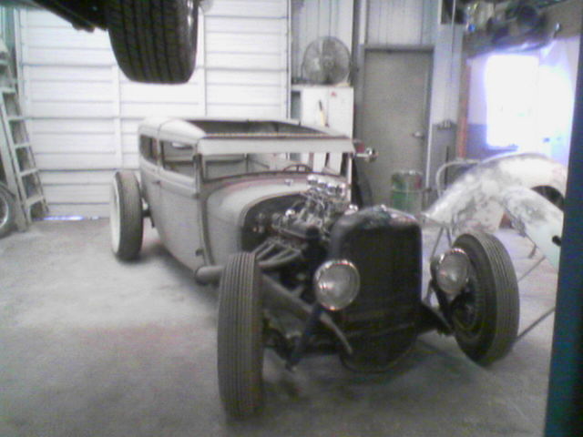

    You guys anti-chop that sedan?

    I havent touched for a while but here are the latest pictures.

    Thats pre chop I 'm going to angle chop that one. That car has a Injected Hemi with a 700r. It should be tons of fun. when it's done. Good to hear from you. Scott

    Here's one I took at Billetproof

    Thank you for posting the picture. I didn't have any pictures with the hood and headers done. Scott

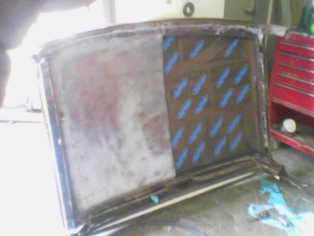

  27. the way you sectioned the pillars for the chop was freaking cool, how did the headliner turn out?

    The headliner turned out cool. We are going down for the cow palace show we are thring to finish this 56 ford truck for the show.

    Man you guys are buildin some kick ass stuff look forward to seein that ford in a side view see how the extended cab turned out!
