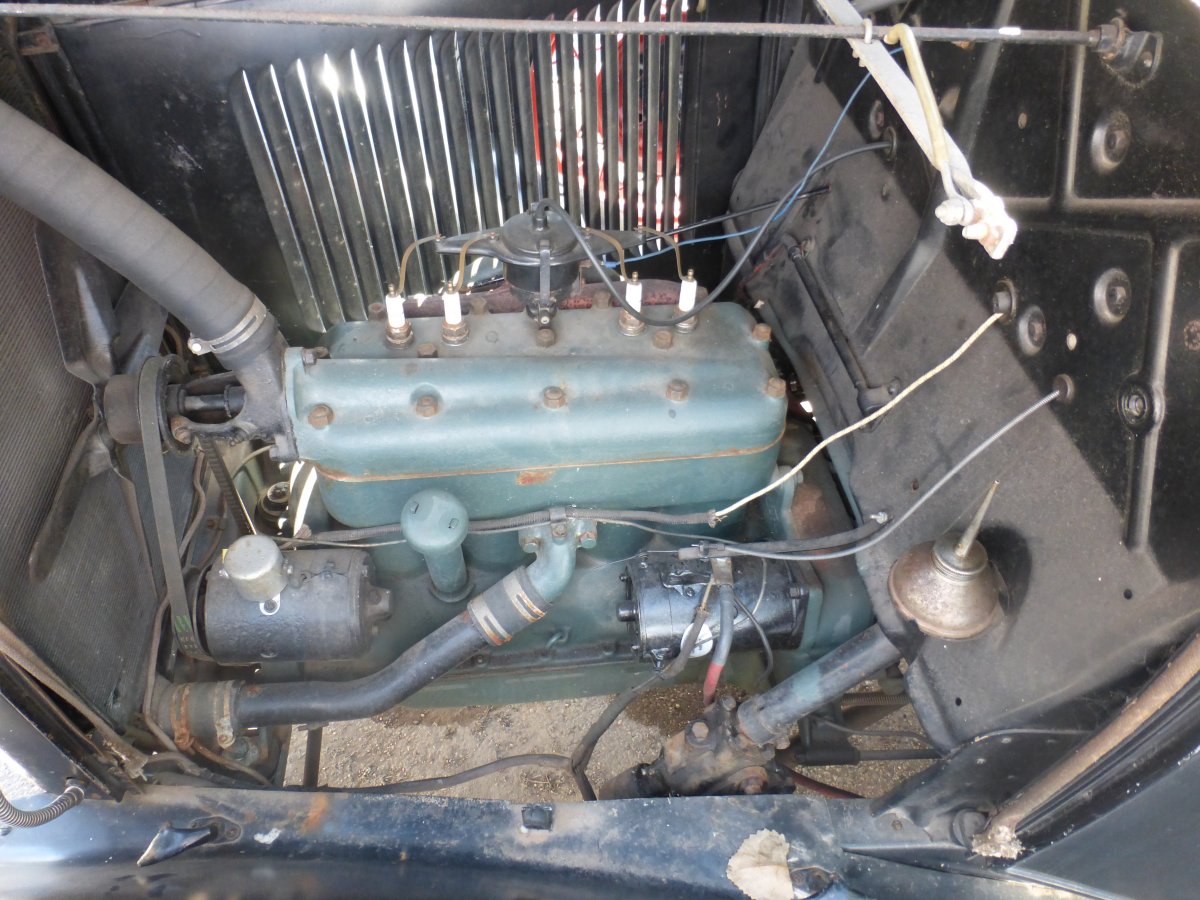

  7. Kiwi 4d
    Joined: Sep 16, 2006
    Posts: 3,861
    Kiwi 4d
    So when in1932 did they start adding the firewall to block engine steady/damper. Ours does not have one and i see no sign of it ever having one.?
    Plus its got the recess where the oil can is for the intended vaccum cluctch that never eventuated, when did this indent stop?
    3W JOHN and HOTRODPRIMER like this.
  8. HOTRODPRIMER
    Joined: Jan 3, 2003
    Posts: 64,593
    HOTRODPRIMER
    Your firewall appears to be a early one,I don't have my reference material here but I think there were as many as 8 different variations in the overall design of the firewall,probably a result of the different suppliers.
    The divot in the firewall was designed for a clutch assist that never made it into production. HRP
    3W JOHN likes this.
