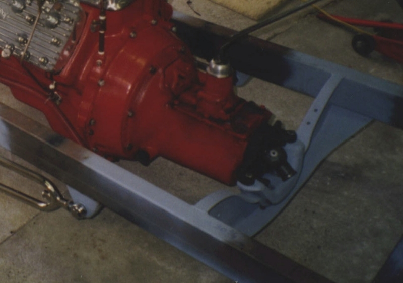

    Got the f1 trans mount today, I have an f1 crossmember I'll be using in the build.. Anyway what do I have wrong here? The holes are off, & is there supposed to be biscuit style spacers between the trans and the mount?
  3. Hitchhiker
    Joined: May 1, 2008
    Posts: 8,507
    Hitchhiker
    Don't the early mounts have narrower spacing?
  4. 510madmav
    Joined: Dec 29, 2009
    Posts: 814
    510madmav
    Not sure. I do know I have a 35 transmission.

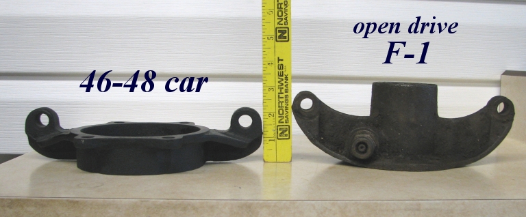

    If you want to use that 35 ******, you will need to change the rear bearing retainer (which is also the trans mount).
    That saddle mount you bought for your F1 crossmember is the same used on 46-48 Ford cars. The rubber vibration dampener is molded to it so you don’t need biscuits on the ends.
    Are you using a closed driveshaft? If so, the 46-48 trans mt will do the trick.
    Just keep in mind that if you change your mind to go “open drive” later, the F-1 trans mt for open drive extends the length of the ****** by about ¾ inch (as shown in the pic) which changes the location of the crossmember also.

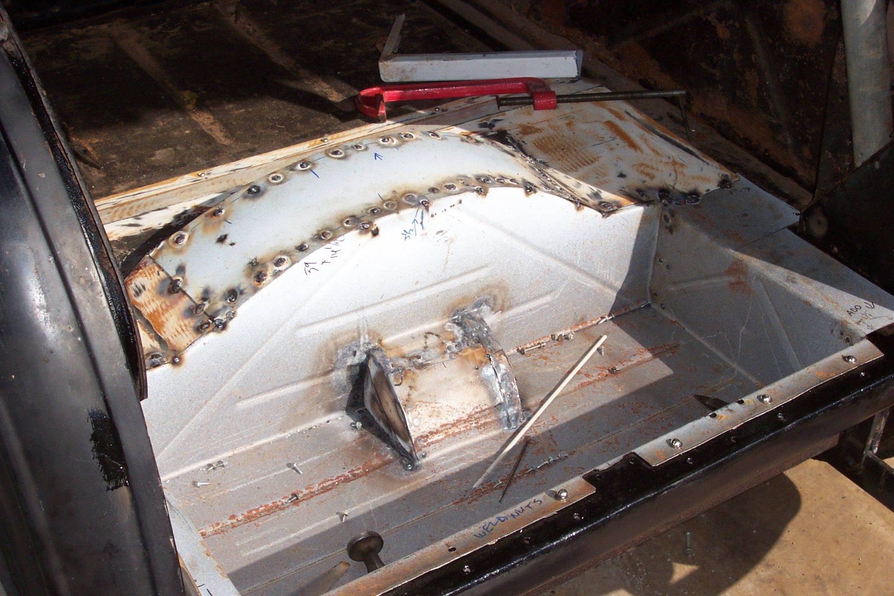

    When I made the floor for my trunk I dropped it for extra storage

    Finally got my correct trans bearing retainer/mount. Got it bolted on and now I'm ready to rock.
