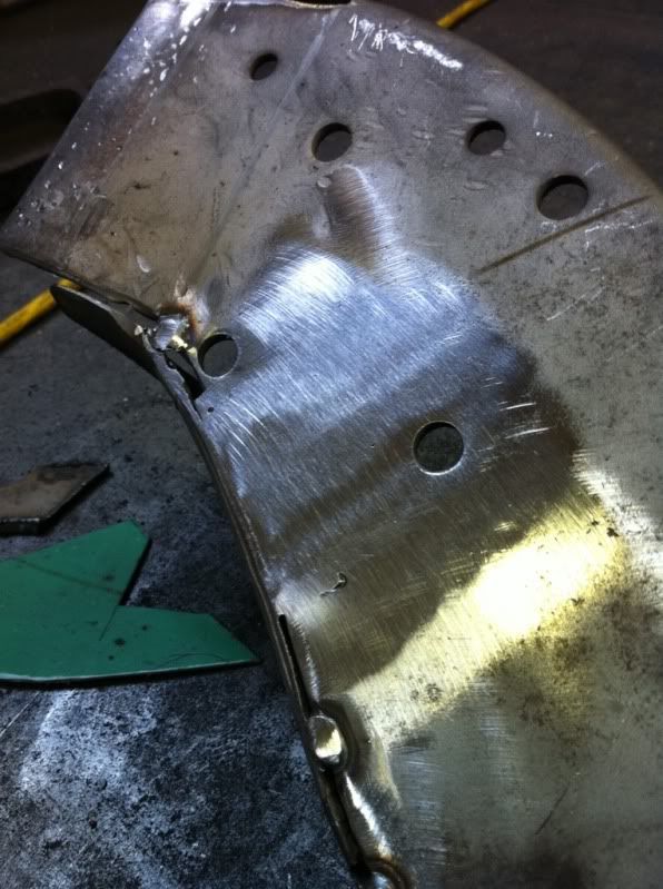

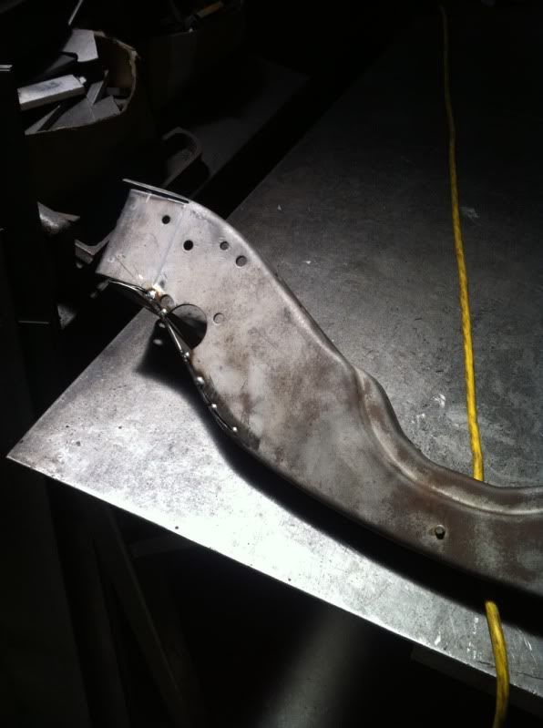

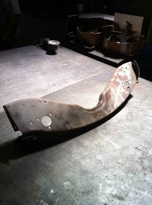

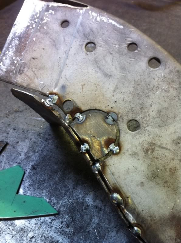

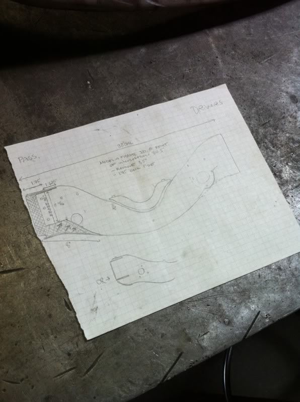

    Took my F1 crossmember to work, And got started on it at lunch..
    blasted & ready for layout..
    Sketch I did last night.
    Little bit of marking action going on..
    Cut cut cut
    sectioning the passenger side
    Fill that hole
    No Mo Ho
    Working the drivers side. Keeping pedal mount in stock location, should work out.. I wanted to keep a nice mounting flange equally around the pedalmount, so I sectioned much less..
    Bending my inner frame bolt/rivet flanges..thats one way to do it..
    Nice flow i was looking for..
  26. 510madmav
    Joined: Dec 29, 2009
    Posts: 814
    510madmav

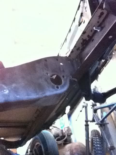

    Keep in mind, I didnt have the frame with me at work, this was solely based off my measurements from last night.. Well lets take it home see if it works...
  27. 510madmav
    Posts: 814

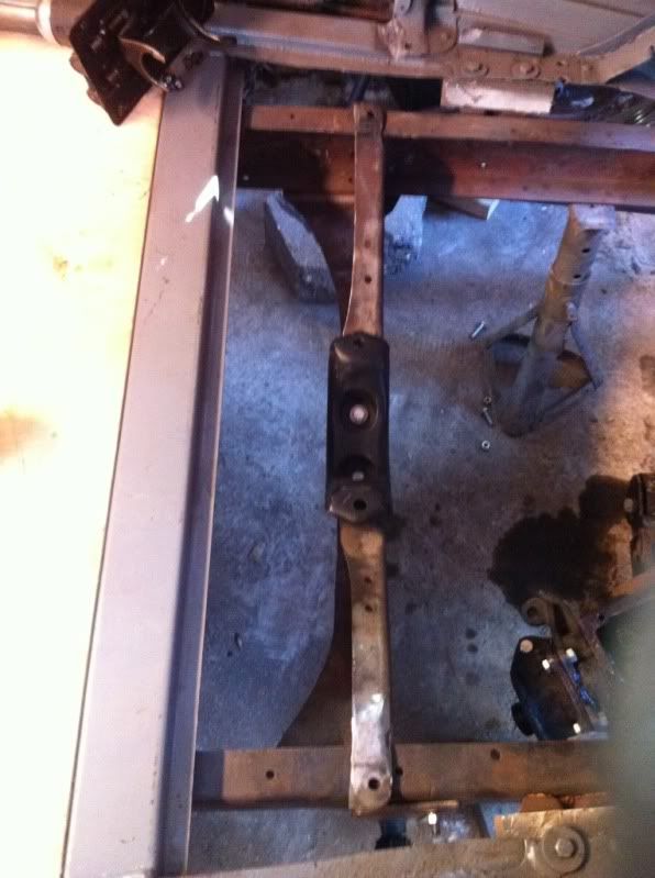

    510madmav
    It Fits like a glove! Factory holes are utilized..this is exactly how i imagined it'd come out..
    Bam.
    Everything bolted back in..
    couldn't be more happy with the pedal location
    VRRRRRRRRRRRRRROOOOOOOOOOOMMMMMMMMMMM!!!
    Fits me perfect..
