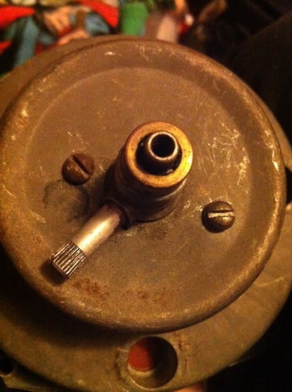

    Anyone know what this might be out of?

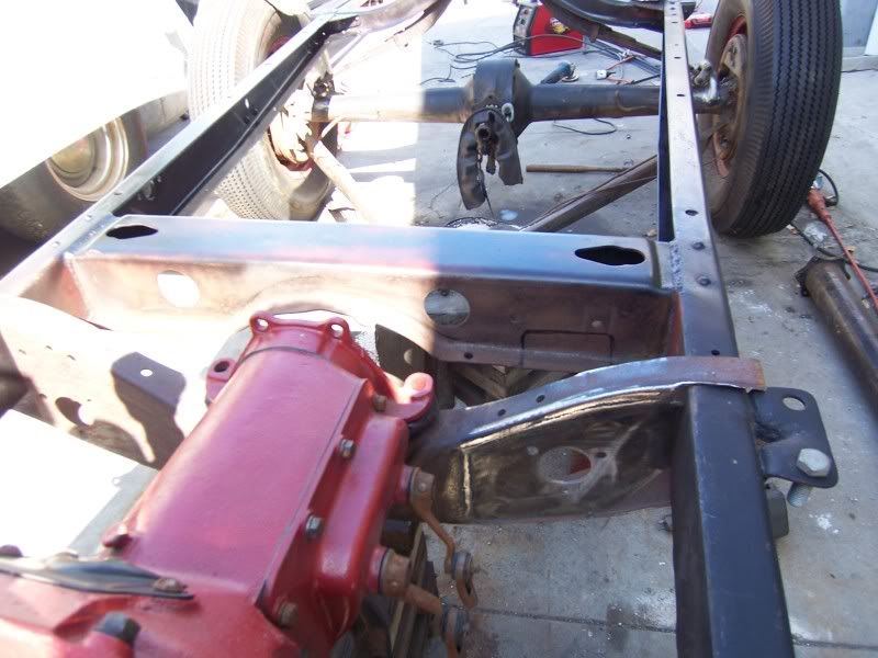

    Great job on the F1 Crossmember. Love how you rounded under the MC. Very nice!

    great build so far, with the F1 crossmember install will the torque tube clear the stock center crossmember?

    That speedo is out of a dodge pilothouse truck from 48-53. Yours is in very good condition. Great progress too, I'm liking your setup!:D

    Probably not, I haven't put It back In, since I took It out to install the F1..

    Wow! Nice call. Thanks, though I doubt I'll use It in this build..too new..

    here's how my crossmember is coming out, I still have to final weld it in and fab something up for the wishbone ball thing, but you get the idea. I dont think I would use an F1 again after all the t******* etc. Might as well just make one from scratch..

    Nah, you have to trim the stock center model a crossmember..
    You can kind of see where i marked mine, but I hadnt cut it at that point yet.

    I DIG how this one is turning out. Really. You did a great job with that F1 crossmember..

    You formed that cross-member pretty damn good, fits like it is meant to be there. Funny how we are all going that route now days, damn good pedals.

    Thank you very much for those F1 pics. That's one of the better installs I have seen.

    I also am crazy about the F-1 cross member, you made the lines flow sooo gracefully.
    Equally proud of the way you tied it in.
