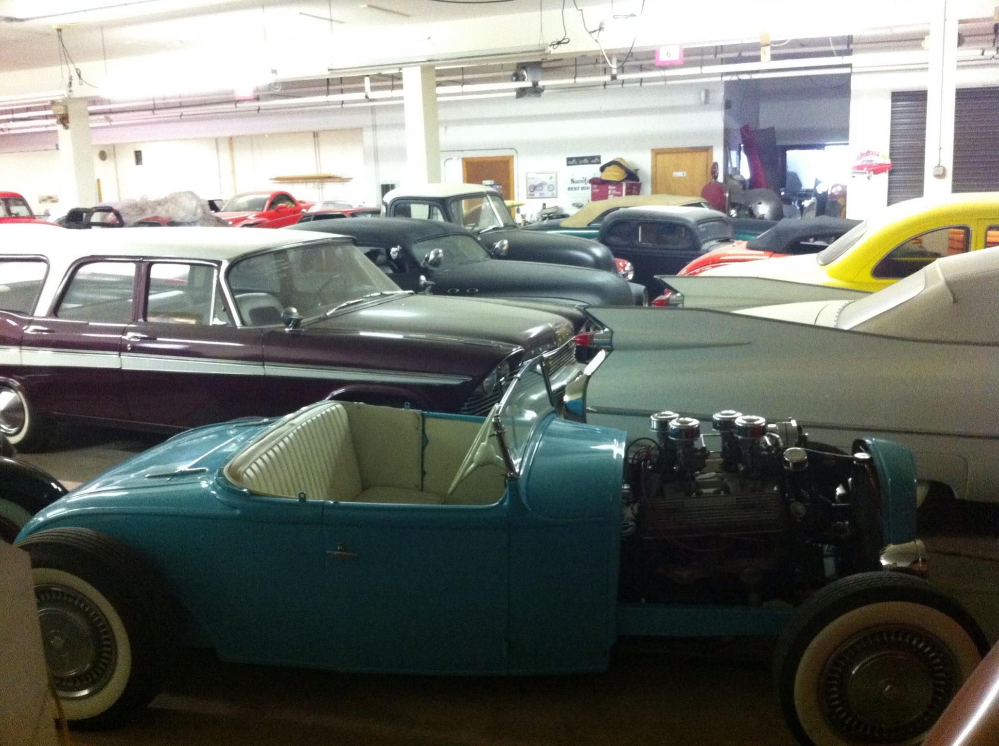

    One day I'll be brave enough too start a roaster project from scratch as of now I bought this 31 roadster from a collector Hasn't been touched except too get it running since the late 1950's.
    Subscribed!

  8. Austinrod
    Joined: Jun 14, 2012
    Posts: 2,375
    Austinrod
    from Austin
    Found a website mostly all metal cars about 60-80 cars in there I didn't want too leave

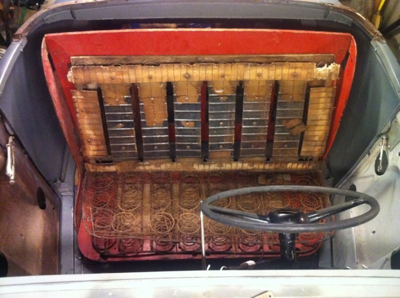

    So I got this seat... Supposedly from a 30/1 coupe I believe. Anyway thanks again Ed!
