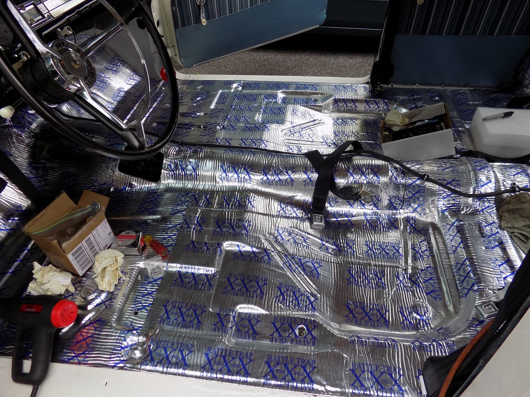

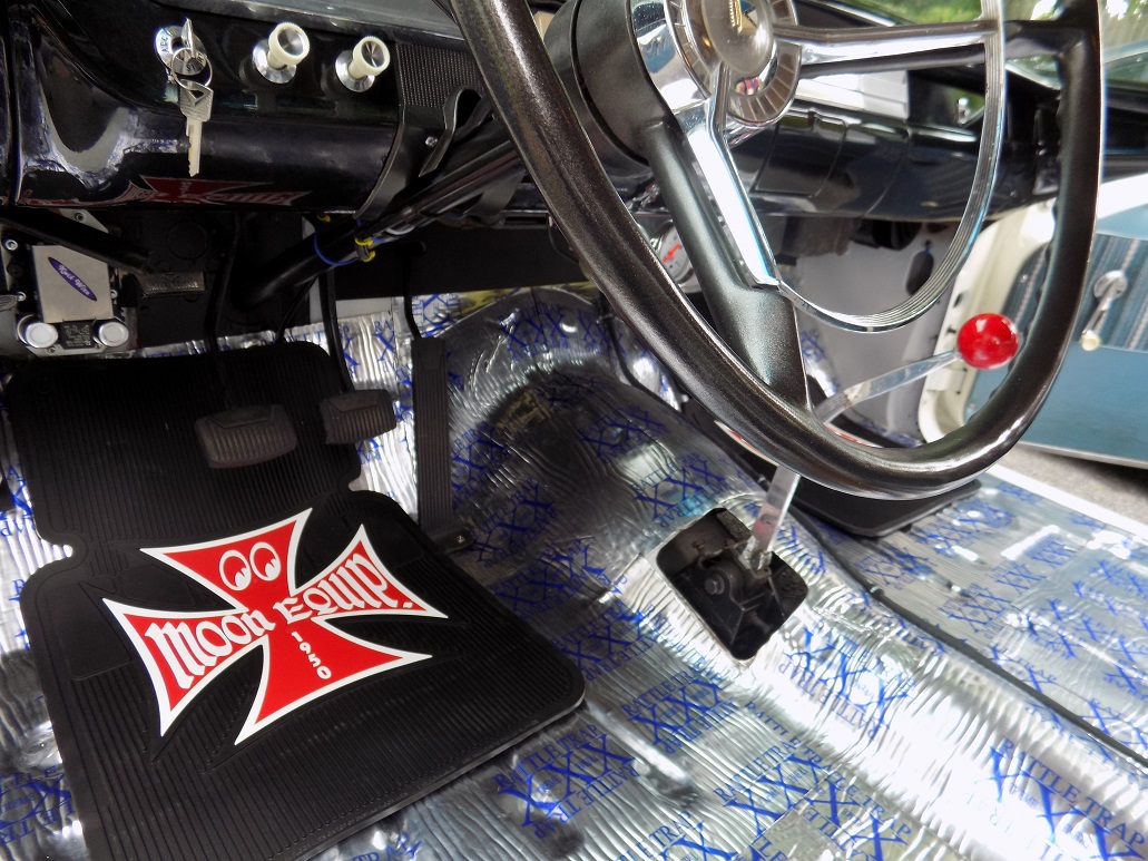

    I used Fat Mat Rattle Trap in my Ford. It went down nicely, but it is fairly thin. It doesn't seem like it will hold moisture.
    dtwbcs likes this.

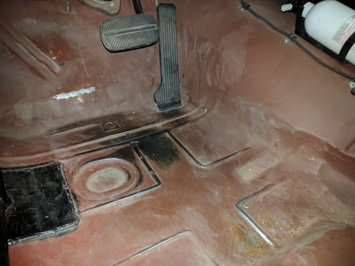

    of course, my "race car" (with over 18k miles on it now) has a nice plain simple floor covering...red primer. It don't bother me.
    Chuck Craig and bobss396 like this.
