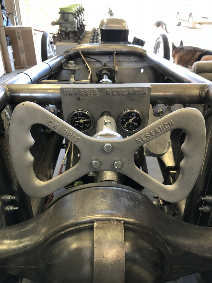

    F92FDB72-A2CD-443A-B805-6C098B07707E.jpeg 382A917E-B357-429B-971C-2B310433F4B8.jpeg Gauges - genie winged Stewart Warner’s look right at home in the Ch***is Research panel. I decided the cowl needs to be trimmed down a bit. I plan to keep the same radius’s but get the cowl flush with the gauge panel.

    I decided to trim back to cowl a couple of inches to open things up a bit.
  24. Countn'Carbs
    Joined: Nov 8, 2006
    Posts: 990
    Countn'Carbs
    from CO
    This puts the cowl more in line with the gauge panel.

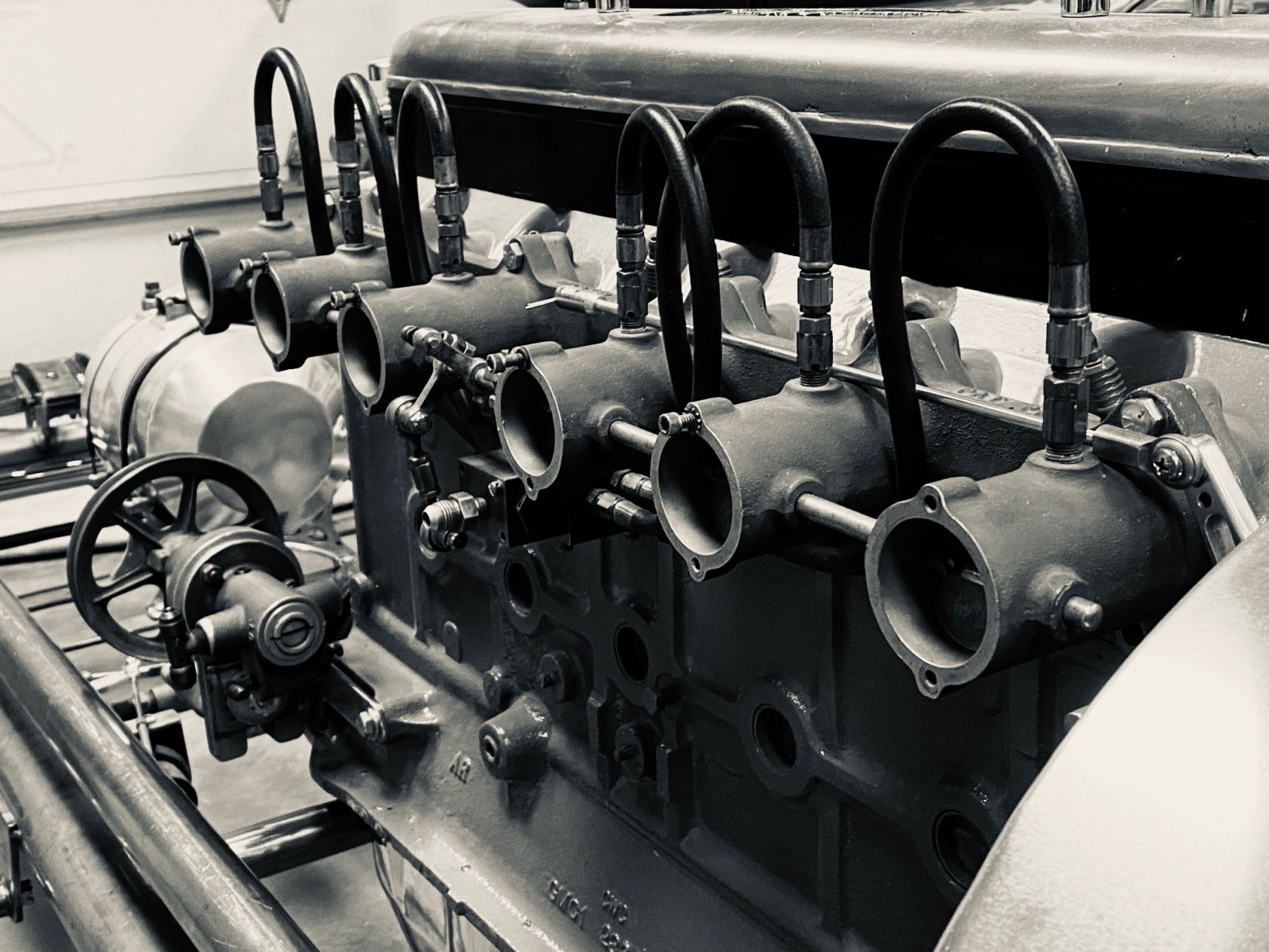

    I haven't updated this post for awhile due to life but figured I'd provide some updates. A big change happened in this build as I was able to score a Hilborn /Travers Injection for this Fisher Head. You may recall Bill Fisher cast about a dozen or so of these heads and as I understand it the injection units were around 15 or so.

    In wanting to stay with the early parts as much as possible, I was then after a Hilborn BL420 pump and a way to drive it. I lucked out and found a rebuilt pump and a decided to go with a V Belt setup instead of the later cog style.
    I found a 6" diameter V belt drive and modified it to work on a 6 cylinder and then took a general 3" diameter crank drive V belt kit and cut it down to line up the pulleys.
