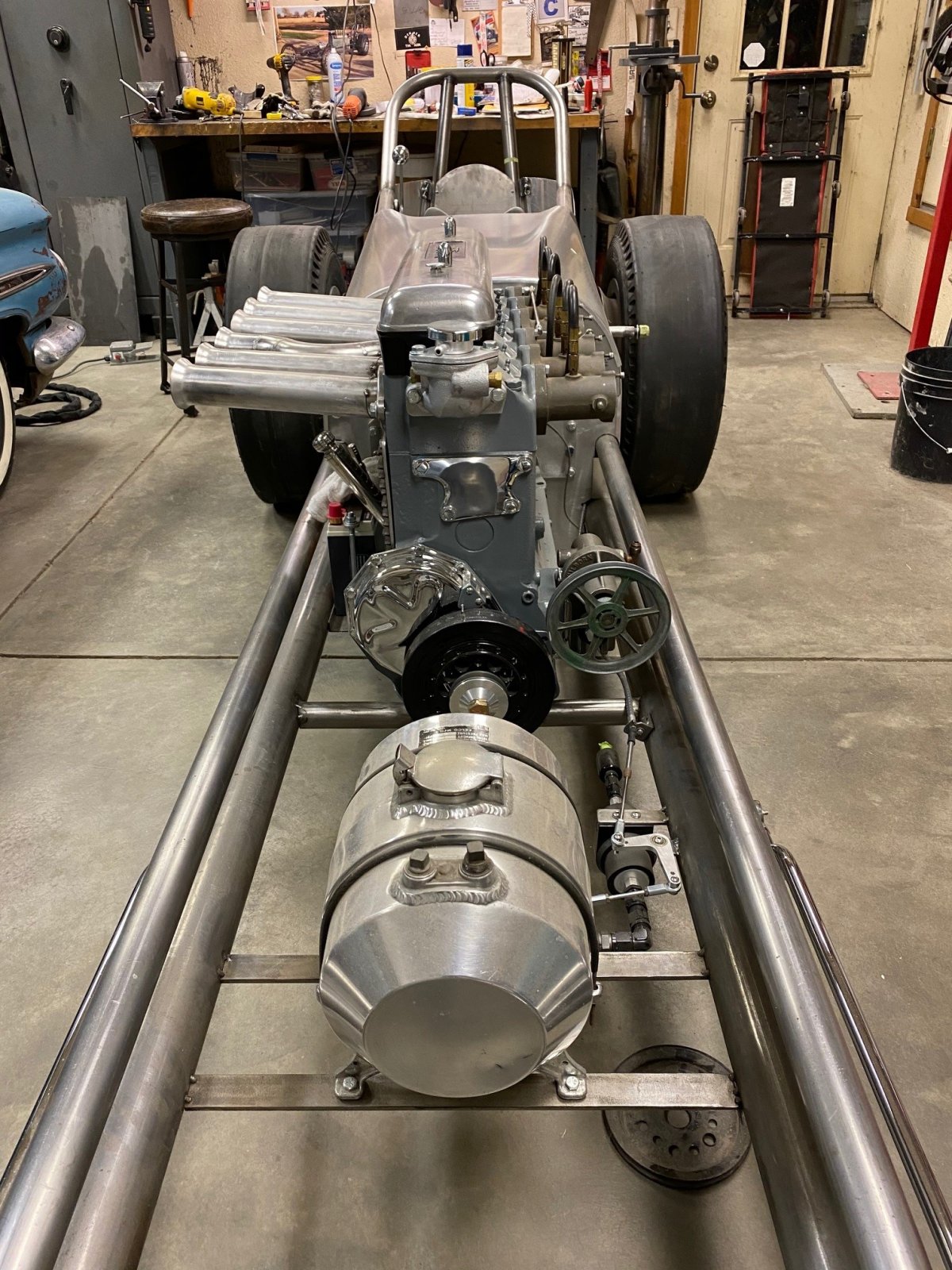

    I also enlisted the help of a very talented individual named Thomas owner of Lead Edge Machine & Design https://www.leadingedgemad.com/ to help design and machine an exhaust flange for this thing. I think he did a great job on it. The first one I was struggling with maintaining the same angles on the tubes. and Thomas took care of all of that.
    With the magneto ending up between header pipes 3&4, it took me a bit but I ended up modifying tube number 3 in hopes of it not getting the mag cap too hot. I think it will be okay but time will tell.

    Thank You Marty. Certainly not to your level of workmanship but I'm trying. Gotta push them outside once in a while to see what you have. The front end is a bit higher than I expected but I think it's more about me raising the rearend in the car. I had to go up and back in the ch***is with the rearend in order to use the mid-plate as a firewall and to have room for the shorty glide and coupler. Just hope the car doesn't want to come up on launch too much.

    That's it Harv and Thank You for your help with that. This pump that I found is set up for CW rotation so it worked out well being on the same side as the injection plus to get away from the exhaust.

    I Love this car! Please change the pulley on the fuel pump. Those cheap cast sheaves are failure prone and looks very out of place.

    Couple of comments . . . When I got my pump, the instructions said it would turn in either direction. That was true. But it would pump in only one direction. We found this out after wearing the battery down trying to start it, then pushing it up and down squirting gas over the windshield to no avail. But if you rotate the pump innards (somehow? -- been a long time ago) it will pump in the direction wanted. For aesthetic purposes, you might consider going to a smaller pair of pulleys.
