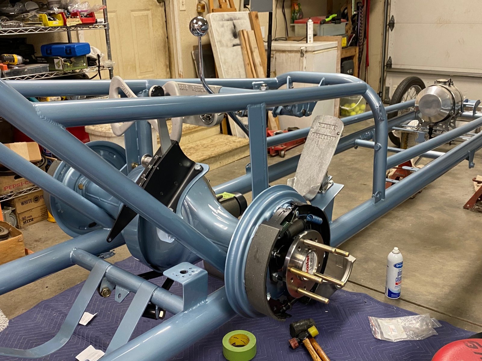

    I went back and forth on this a bit but in the end decided to make it a pull brake. I have 2 return springs on it to hopefully prevent the brakes coming on at launch with that long of a handle.

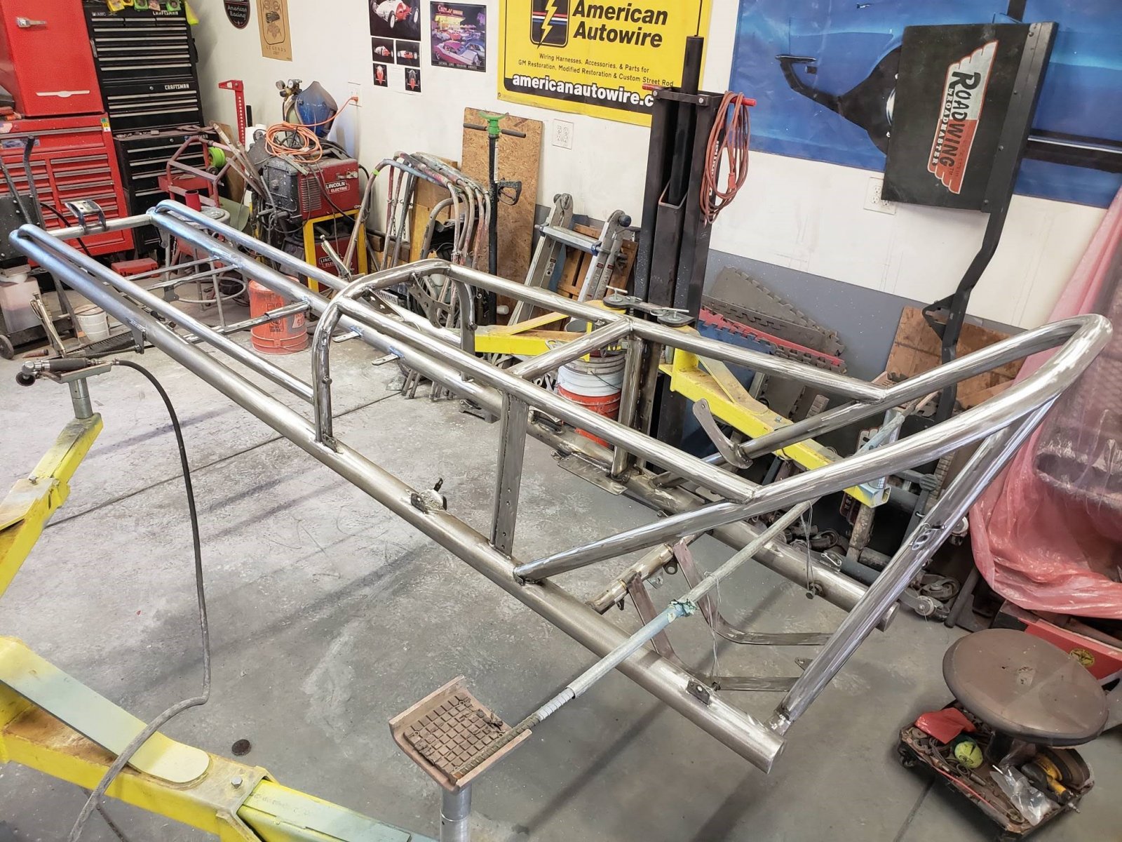

    I was able to drop a few pieces off with Curt the painter and within a few weeks we had color!! Curt is a member here (can't remember his handle or whatever) and does incredible work - I was so glad to have him paint this thing. I'm not the most creative guy (especially when it comes to color) but I decided on '59 Corvette Frost Blue. I've always loved that color so figured why not.
    We're thinking we might add a couple of scallops or something to break it up a bit but figured we'd get the car back together before taking out next steps with paint.
    Prepped.....
    Prima!!

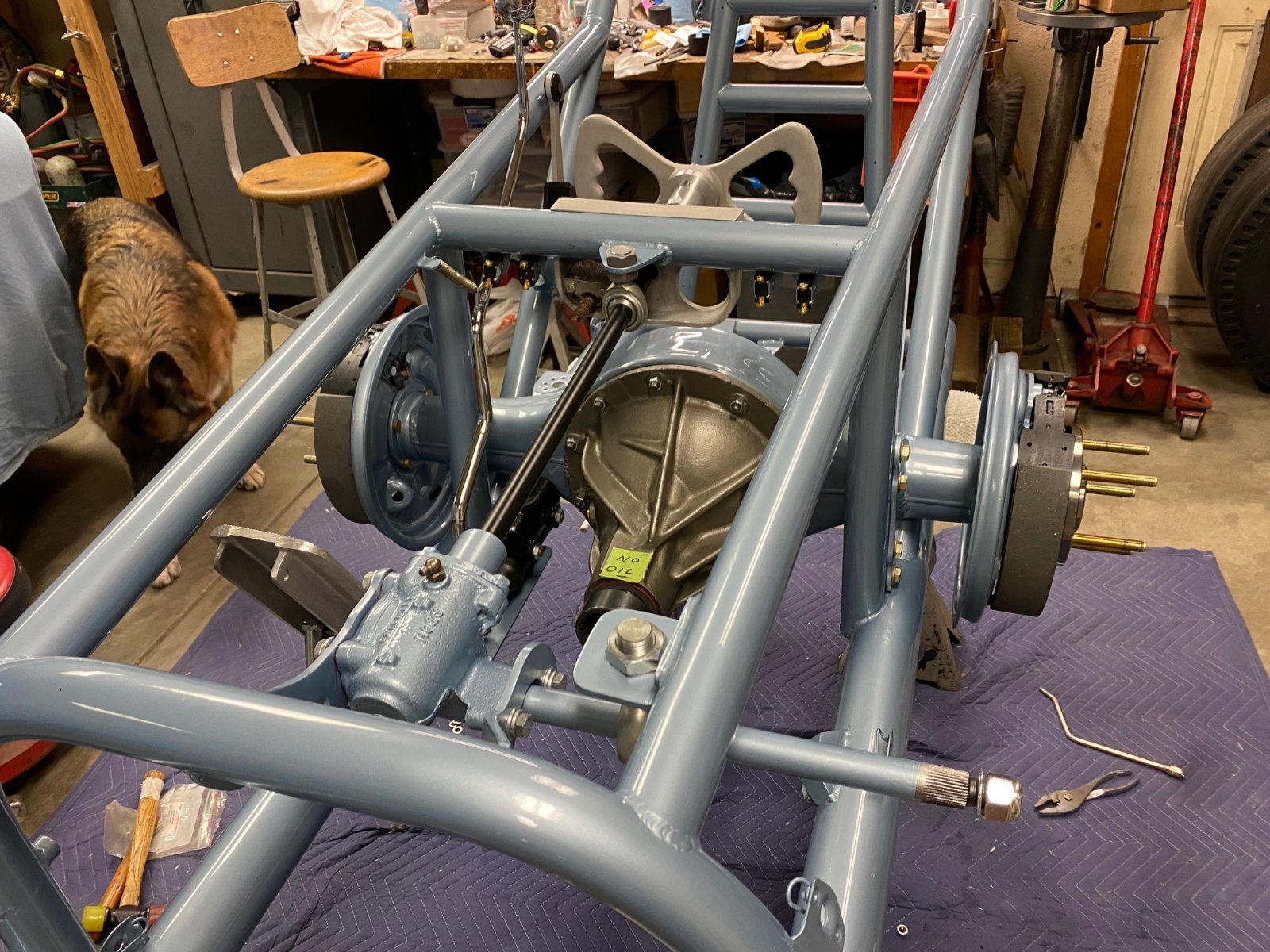

    From there we loaded it up and headed for home...
    With it home started bolting it back together with the Olds rearend housing, steering, etc...
    Mark Williams ended up making the axles.
    Okie Pete, Dyno Dave, Tman and 6 others like this.

    Steering is installed....Ross box.
    Steering wheel adaptor...
    And one of my most cherished pieces on the car is the steering wheel gifted to me from Marty Strode.

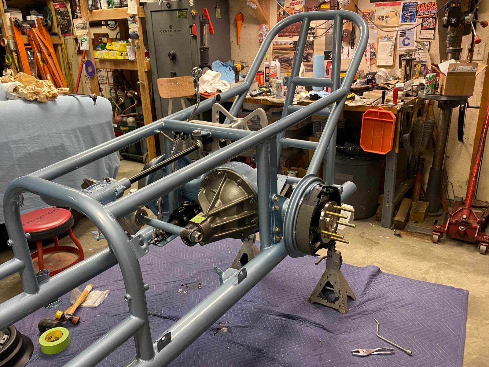

    Bolting on some more stuff...hope to have it to a roller status here pretty quick.

    Love this thing. Gives me inspiration for my FED build, but I am a little further behind (still welding up the last of the ch***is, diff cut to width but needs finalising etc).
    Noted the hand brake (I did the same). Question on the shifter though. Is it a one-hand operation to override the reverse lockout? One hand on the brake leaves only one hand to operate the shifter. I ended up using a Precision Shifter as it is a one-hand operation.
    Edit: looks to be a Frameworks shifter (?)... tried to find one of them, but rarer than rocking horse poo.
    Cheers,
    Harv

    Very cool and sounds like you're moving right along. That is a Frameworks shifter and it took me a couple of years to find one.

    Lol...that's actually the back of the shifter so it's "out of harms way".

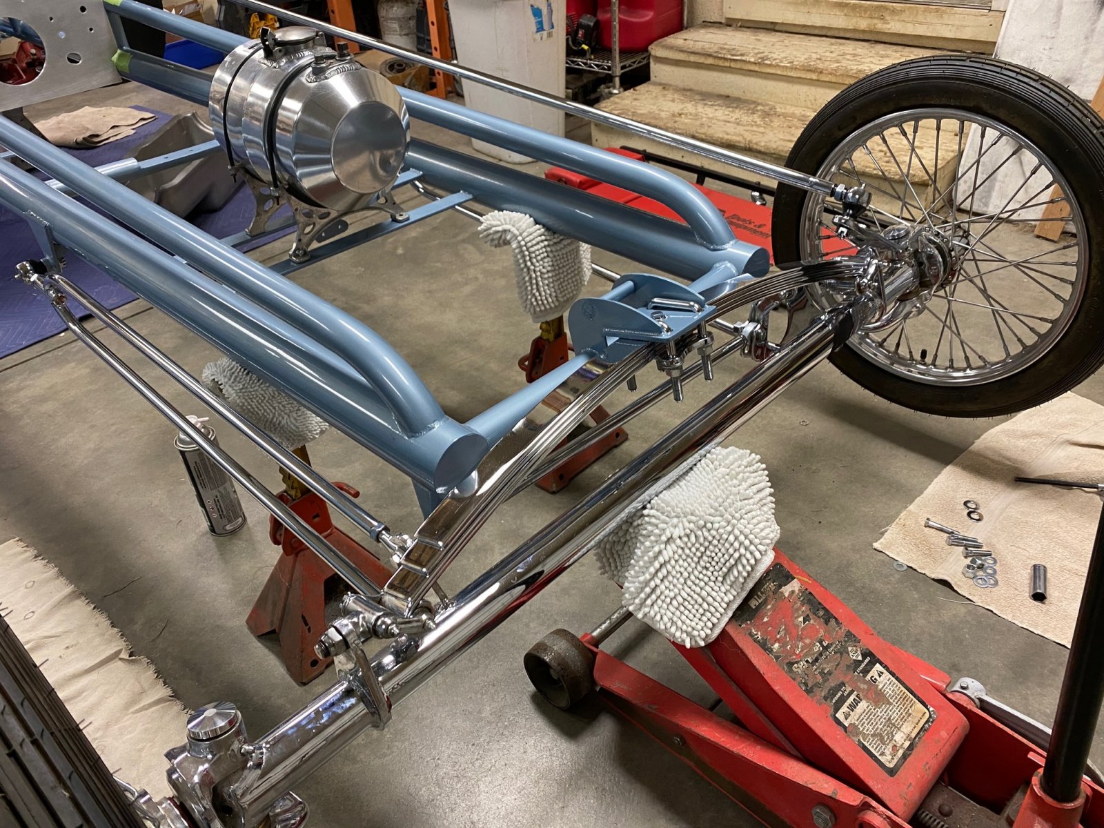

    A few more "going back together" pictures. This axle is a CAE that my brother found for me and ironically enough the batwing locations were perfect for the K88 ch***is. With it rechromed it's now all in place and doing its job up front.

    With this car running a powerglide and a trans brake, pull the knob with your left hand and the right to push the lever forward to get from neutral into reverse, Reverse will not engage until trans brake ****on is depressed

    Ahhh... got it. Many thanks.
    The more that is bolted onto this thing, the more elegant it becomes. Very nice work sir.
