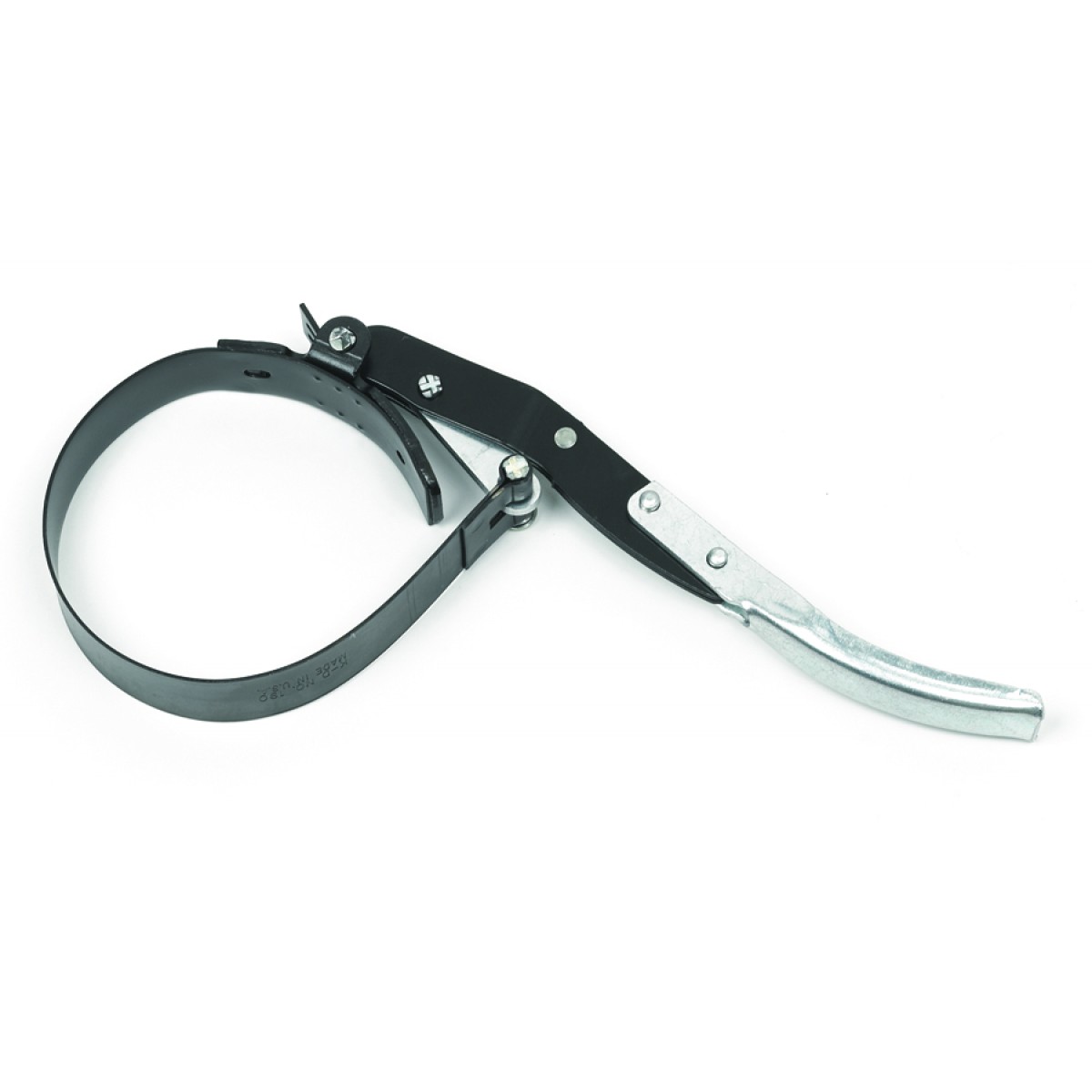

    I have one of these wrenches....works on any size filter,hugs tight to side, and you can either use an open end wrench, or a 1/2 drive wrench/extension if you need it.Works on very low clearance places very well oil filter wrench.jpg
    Lil32 and blowby like this.

    I use one of those for the big stuff, like 7.3 Powerstroke.....variety of sizes of typical oil filter wrenches for small lawn mower up to standard car/ light truck. Then some socket type specialty for things like motorcycle ( Harley)
