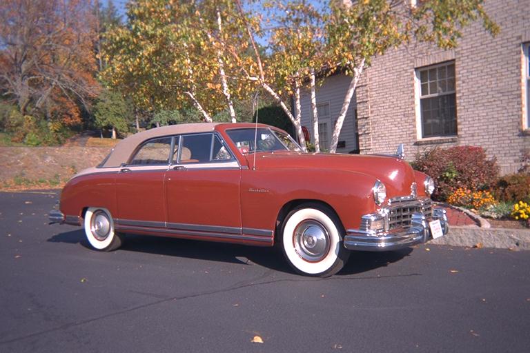

    The B-pillar is heavy, but it suits the Kaiser. Sometimes an odd detail can become the "trademark" for a design. Something to think about.
  16. Rot 'n Kustom
    Joined: Sep 24, 2004
    Posts: 2,169
    Rot 'n Kustom
    Here's how Kaiser solved the B-pillar problem: The Kaiser Virginian.
    They removed the B-pillar and replaced it with a little steel-framed window.
    The pillar/window could be removed completely when the front and rear windows were down for a true hardtop look.
