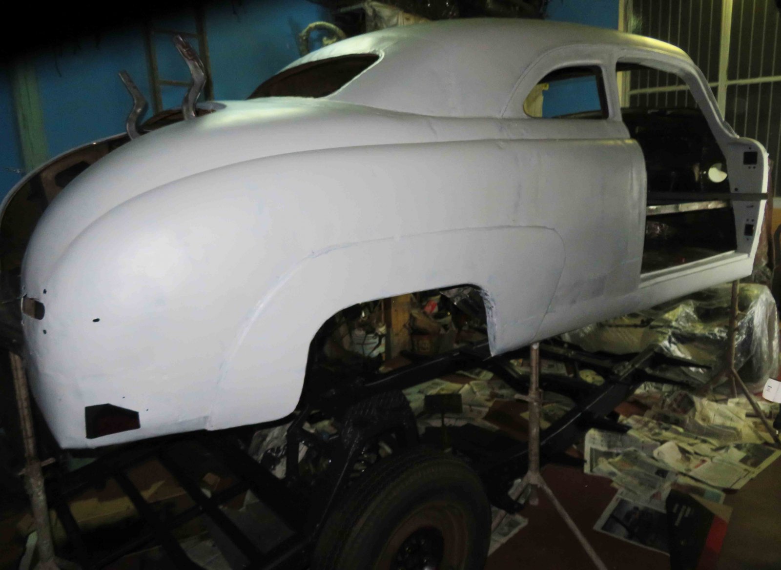

    Paint removed. Started painting the frame.

    Great to see this still moving along!
    nix likes this.

    Unfortunately I progress slowly because I have no space to work, my garage is very small and I don't always have time to do it. I do everything by myself, no one helping me or just exchanging advice, where I live all this is difficult, even finding simple necessary parts (such as simple screws with American thread...)

    The painted frame looks good! I can only imagine how much more difficult a build like this must be to do in Italy, but you're making progress and I'd love to see how it looks when finished.
    chryslerfan55 and nix like this.

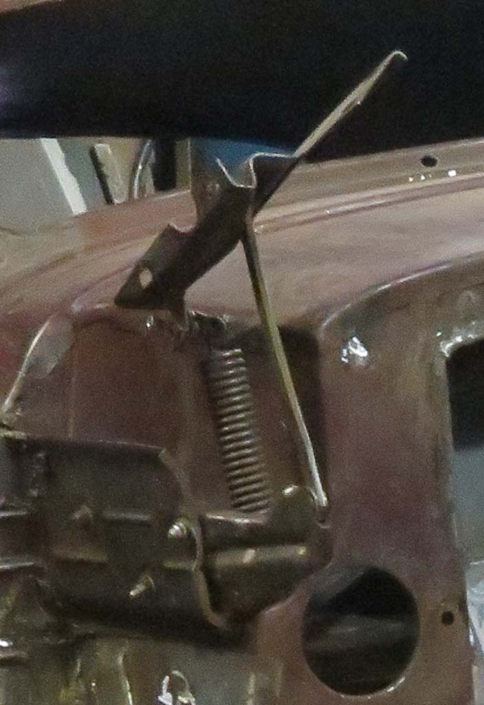

    Thank you so much for the thought!!!! Really cool!!! Actually I am looking for p***enger side hood hinge (with spring), if by chance you have it available I would be interested to buy.

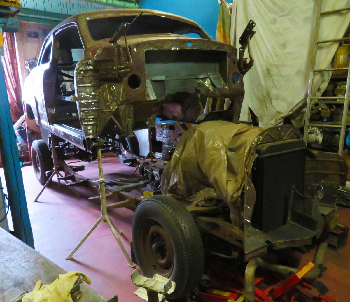

    Finished with anti-rust to the body

    Well, I'll be! When I first came across this, I thought : "He'll never be able to pull this off!", but boy, was I wrong.
    It looks kind of "Merc-esque". Great work!

    Please, I'm looking for my project Kaiser 1949
    -hood spring or hinge+spring .
