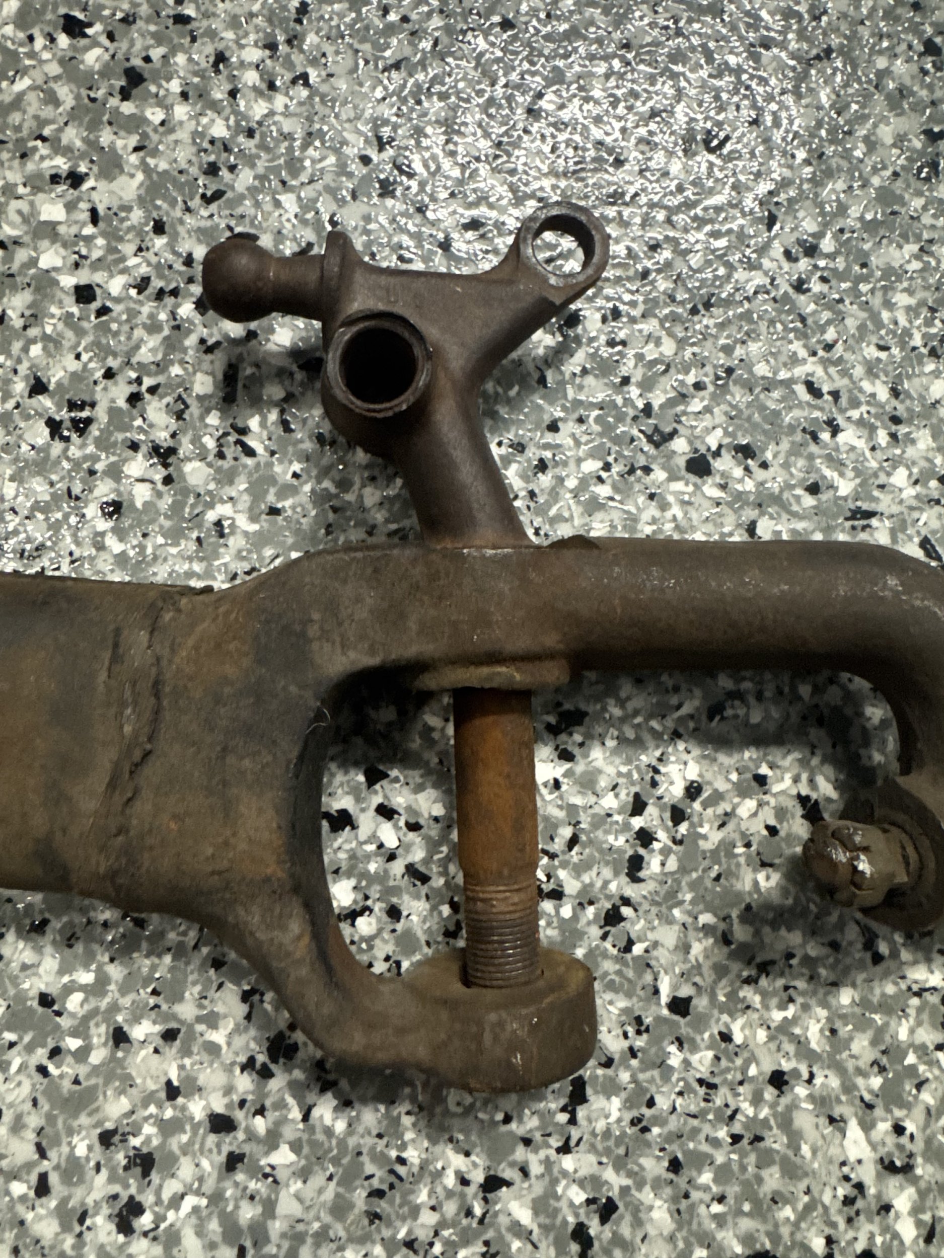

    In case the shaft of your new longer Perch bolts is not supported in the whole axle bore, a 5/8'' unf nut turned down to the exact bore size will fix it. It needs to be full contact. This is mine. JW
