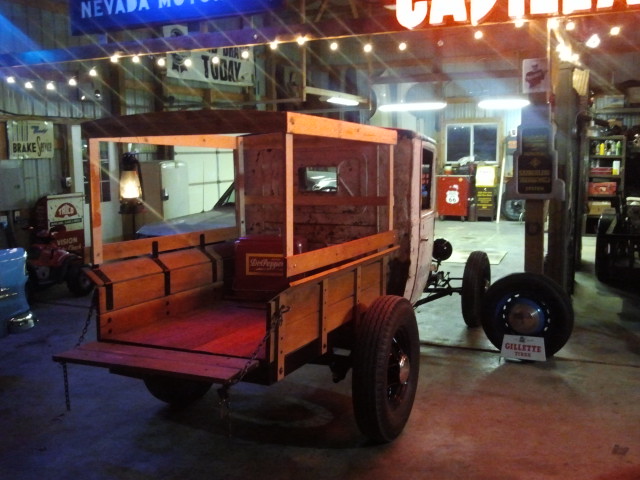

    I also started on the bed, built a steel structure that will be similar to a "T" wood bed and adaptable for my needs, box, racks or flat.
    Mock up of bed via photoshop...

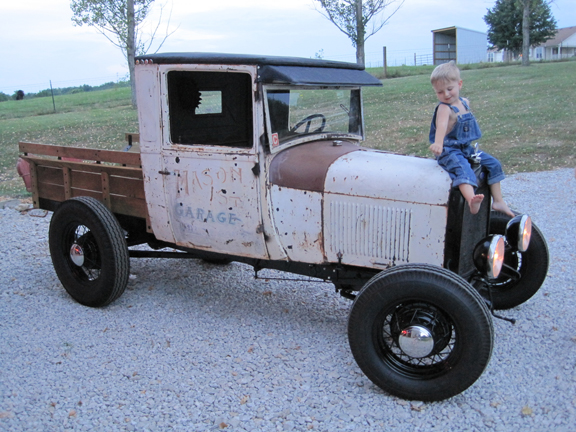

    I've been busy in the build and neglecting the post so thought I'd give a little update.
    Getting close fellas, I need less than a handfull of items but time seems to be the hardest one to find. Occasional I'll slow down a bit too so my boys can help, if its a bolt they can tighten I'll call it a night and wait till they can participate.
    For now the bed is done, except mounting of the tailgate. Also added the air shocks to the back to help compensate for added weight while hauling. I kept the friction shocks on the outside to keep the look but left the adjustment loose. Those annoying plastic air lines have been covered in woven cloth wire cover to help hide em.
    Engine is ready fore fire up once the last fuel line is reshaped. Brakes are almost complete I dropped the cash on the brakes getting new cast drums and every linkage roller and plate properly machined and set. Rear backing plates are waiting on bushings but the fronts are bolted up and ready for a farm road pass.
    Close.

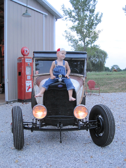

    Chase (my youngest) got all dressed up last night for my latest picks.

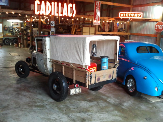

    In time for NoSurf's Mid-West HAMB-B-Q and to support my little ones growing interest of camping and fishing I took a look at the travel trailer boom of the 20's - 30's and added more fun into my truck project:
    Here's my interpretation of an overnight camper. While it's not sturdy enough to run down the highway, it does give decent shelter while taking minimal travel room stored in the bed.
    I designed it to assemble quickly using wood dowels and wing nuts, I made the canvas movable so either side and the rear cover can lift up for sun shelter. So far Ive added a hammock, cooler, stove, the coach gun and fishing rod. I think once the Victrola with Flatt & Scruggs 78's arrives I'll be set.
    What ya think?
