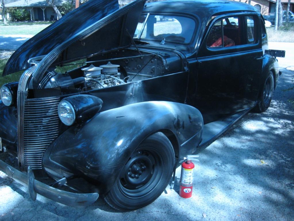

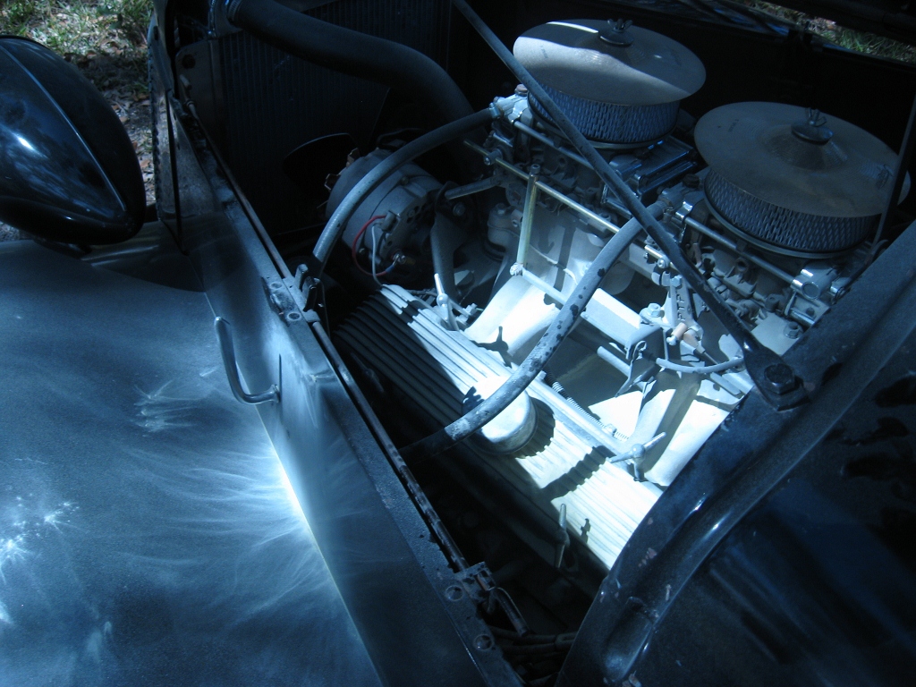

    <hr style="color:#D1D1E1; background-color:#D1D1E1" size="1"> Took a nice drive in the 37 this morning, about 30 miles or so. Car is running great and I'm a happy camper! As I pulled in my driveway the P/S goes away and smoke starts pouring from the hood. I shut it off, jumped out and opened the hood. I see FLAMES!!! HOLY ****!!! I had the fire extinguisher on the front seat and was able to get it out without too much trouble. My heart rate is starting to get back to normal I think. Anyway, my point is.....
    FIRE EXTINGUISHER, DON'T LEAVE HOME WITHOUT ONE!

    Pressure hose for the P/S let go, spraying the drivers side header. That's where the flames were.

    that chemical is corrosive as hell. FYI

  9. Is this close enough? (Look between the seats)

    Get that chemical off of the paint it will eat the paint in a very short time.

    Not just the paint. As has been said, it's very corrosive!

    <hr style="color:#D1D1E1; background-color:#D1D1E1" size="1"> Gave the 37 a good cleaning today, top and bottom. It looks like I escaped with nothing more than a few stains on the drivers side header. I have a pressure hose on order and hope to be back on the road next week. Thanks for all the kind words.
