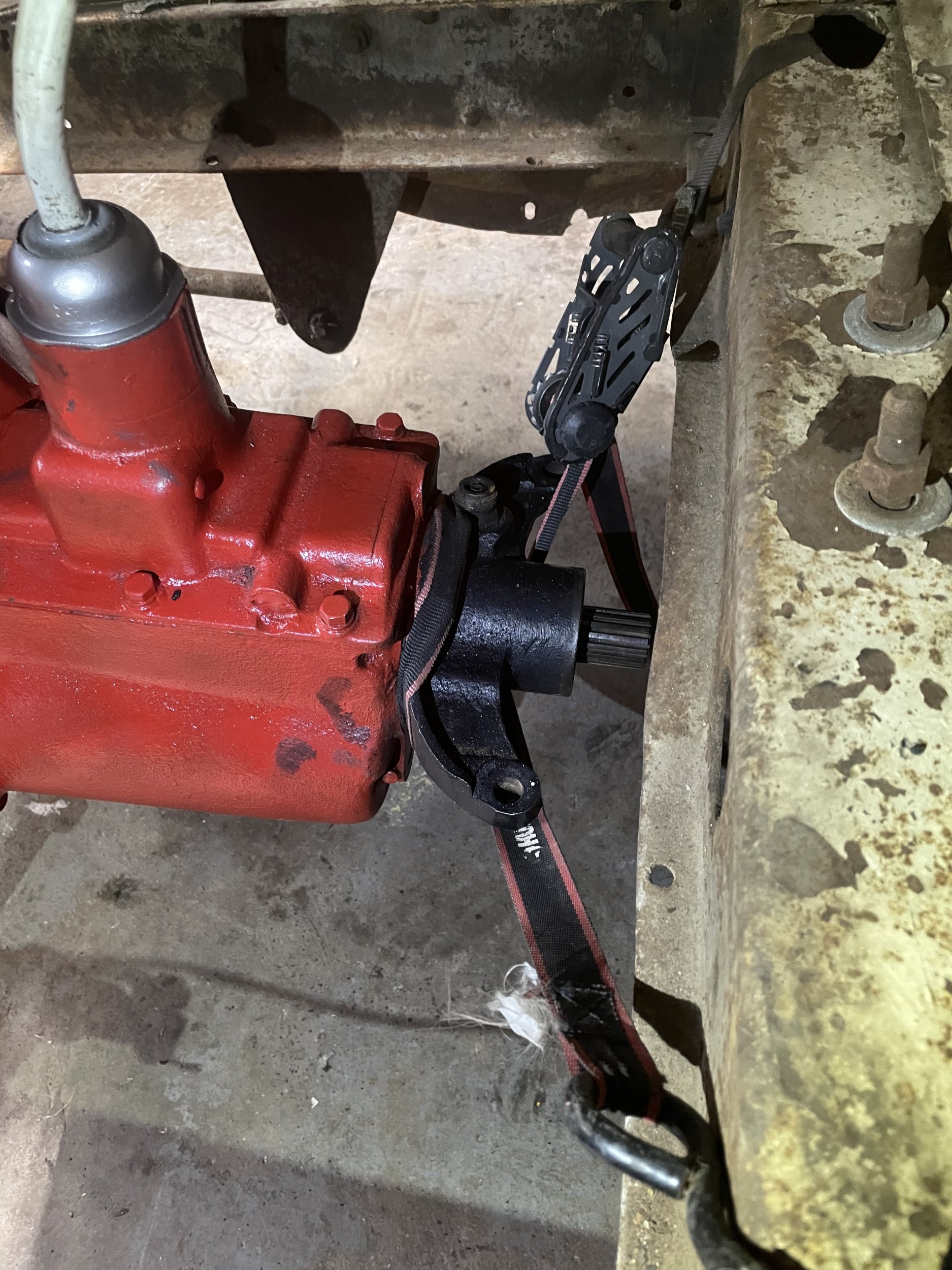

    I don't see any evidence that there was ever any way to tie a transmission to the crossmember and nowhere that another crossmember would have been. :confused: More ****ysis required.

    I would look into the millworks av8 parts. They make a bolt on trans mount for an early ford three speed into an A that bolts to the stock center crossmember. If not to purchase then to at least get some ideas from. @IronTrap used one on there roadster pickup project with the blown flathead if you want to watch. Solid video of installing one

    Add a couple hoseclamps to your ratchet strap and you'll have a David Frieberger Roadkill special. :rolleyes:

    What are those 2 big bolts/nuts sticking up thru the top of the original crossmember? Maybe Sid actually had the longer '49-53 trans in it and used those with some kind of saddle to hold it in place?

    They are actually the ends of a U bolt. I interpreted this as a drive shaft loop....
    Would a guy do that? Just support the end of the transmission in a saddle? I have a ****ter shield he cut from plate steel that wraps under the transmission. I was almost wondering if he just had it sitting in that but that seemed silly.

    Oh I’d put money on that holding the back of the trans having seen the rest of the car. Wouldn’t be the first time it would have been done that’s for sure!

    Yep, I'd bet the trans was just cinched up tight against the crossmember with that U-bolt.

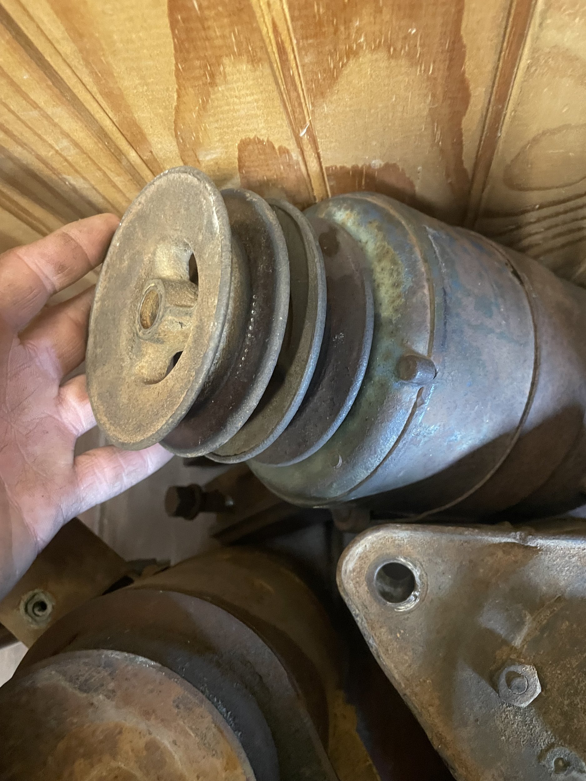

    trevorsworth
    Stupid question. My crank, water pumps and generator pulleys all line up. However, the double wide belt truck crank pulley doesn't clear the crossmember. Is there a reason I shouldn't just cut the outer groove off the crank pulley and double the gen pulley to run the fan?

    Here's my solution for the pulley problem...
    This Model A gen pulley off a junk A generator is the same diameter and belt width as the flathead gen's, but sits on a tapered cone that is smaller than the flathead generator's shaft. I will cut up the A generator shaft and weld the tapered cone to the end of the flathead generator shaft. My machine shop can fix the threads on the bigger shaft after I weld it and then the whole ***embly will be able to come apart as normal. Doubling this pulley and going to a single crank pulley solves the crossmember clearance problem & lets me run my mech fan instead of switching to an electric fan.

    could you just buy a pulley that has the right grooves and slide it over the stock armature?-even if you have to face the hub back for clearance for nut/washer?

    I don't think the armature is long enough. There are other ways around this but I think this is maybe the most elegant.

    Sounds like you’ve settled on a solution but for the sake of conversation if the hole in the new pulley is under sized is there any reason you couldn’t bore and reem the hole to the larger tapered size already on the generator?

    Conversation is good... if there's a better or wiser way to do this I'm all ears haha so appreciate any thoughts of course. The armature on the V8 generator isn't tapered and there isn't enough meat in the middle of the A pulley to bore it to that diameter. Also, there wouldn't be any threads protruding through the pulley to put a nut on.

    If there was enough meat around the bore of the pulley, you could counterbore it to get enough thread for the nut. Just a thought.
