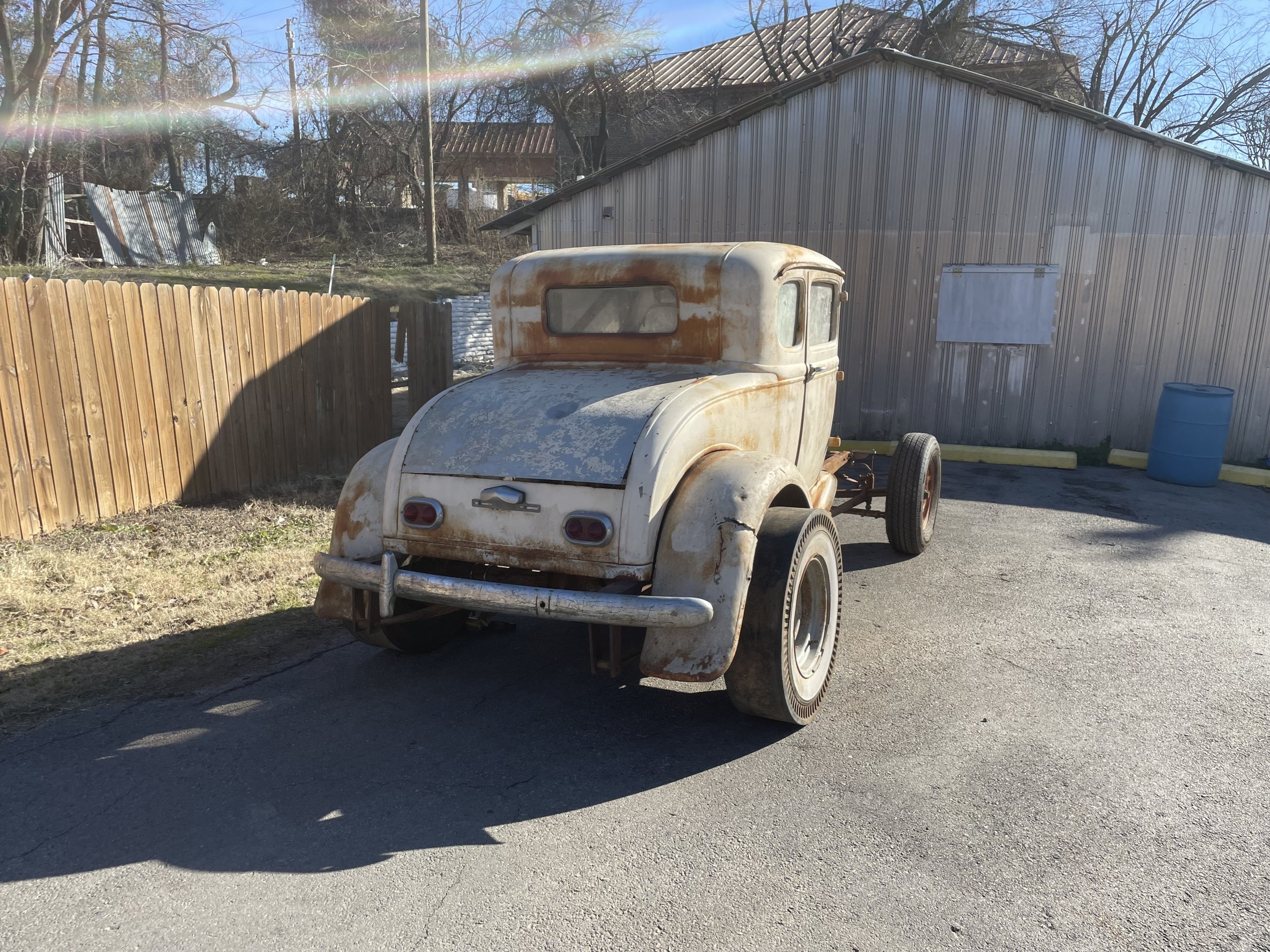

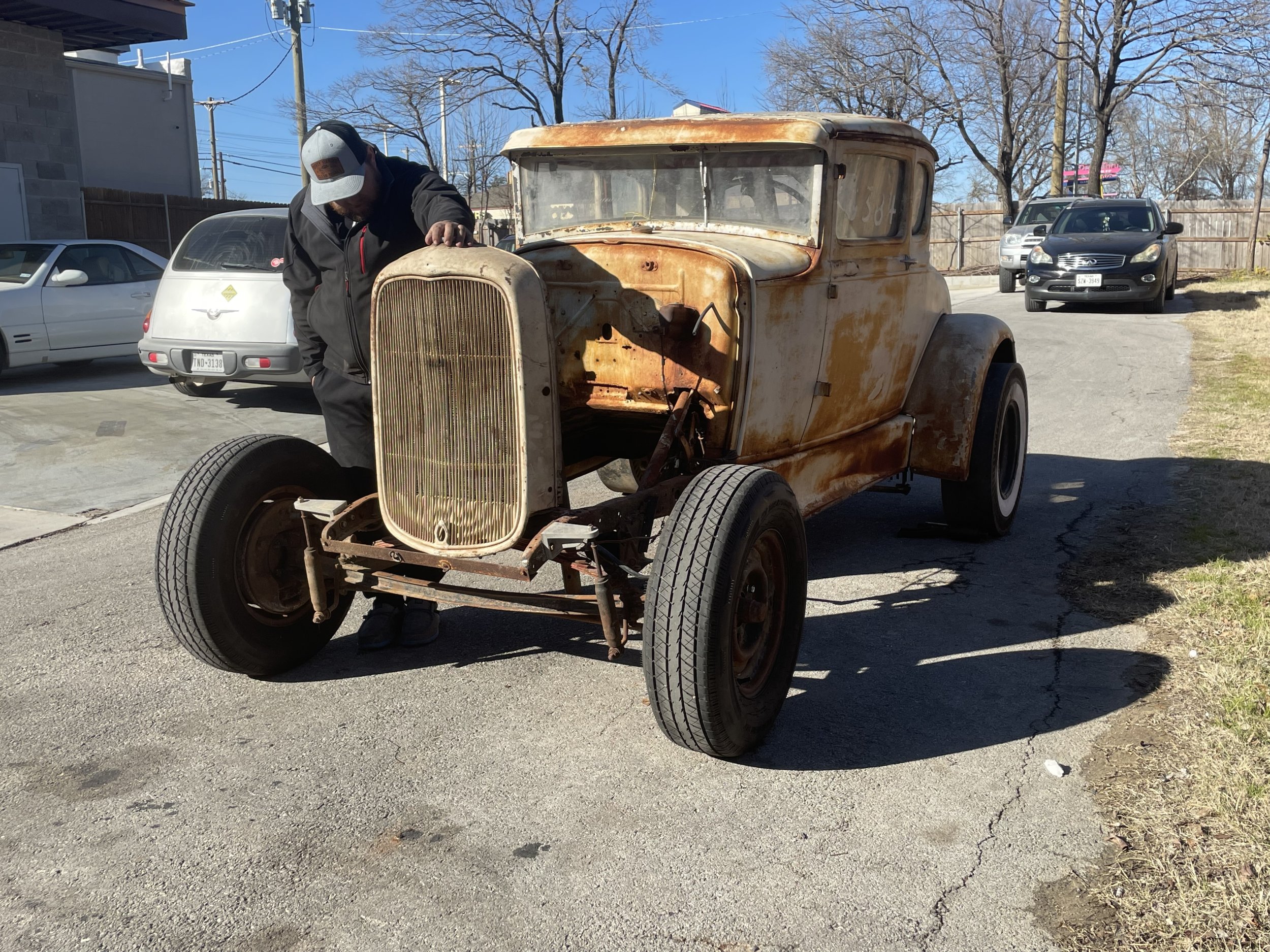

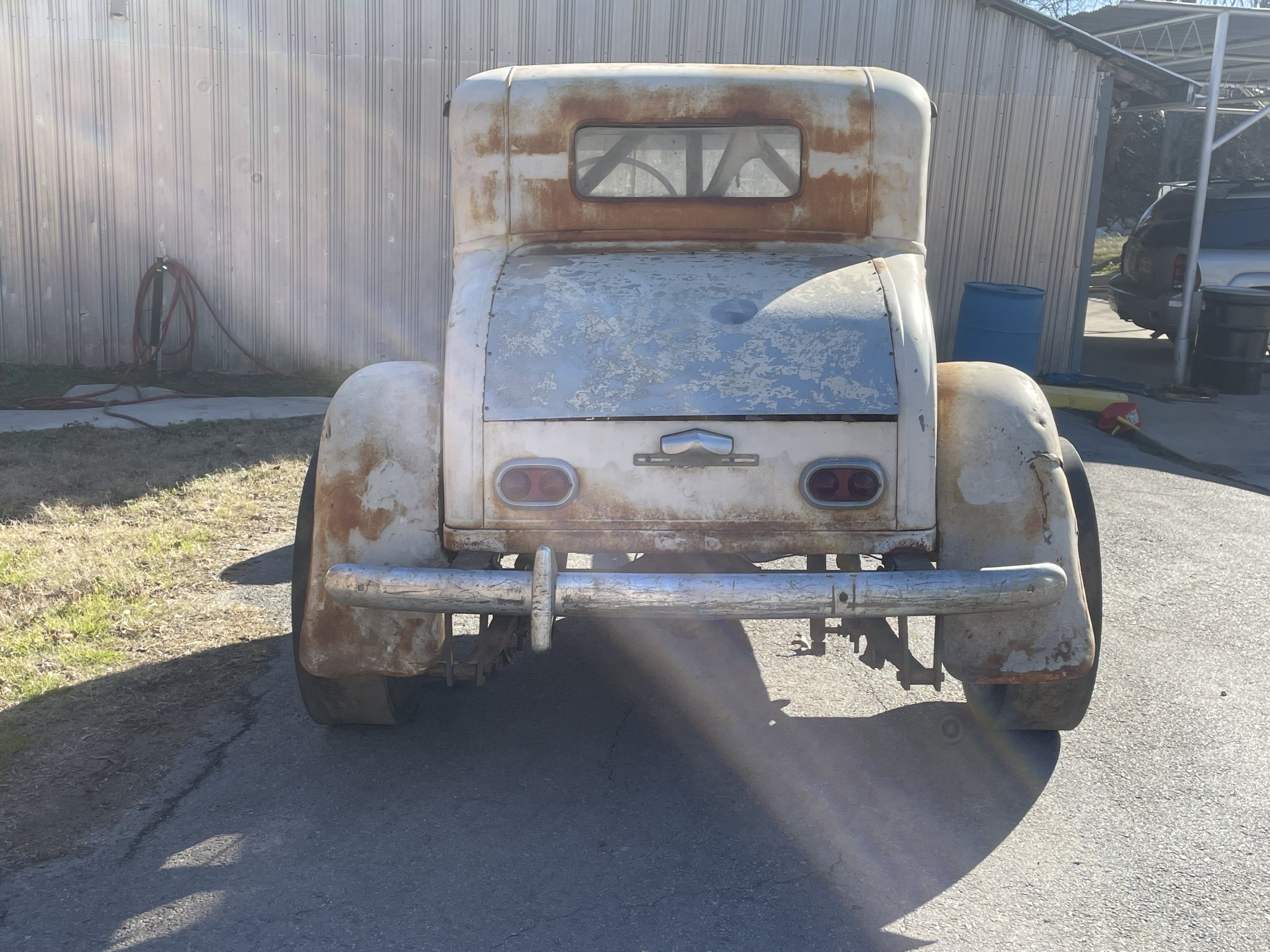

    Had a little downtime today so Saul and I hammered out some little things on the car. I bought a drum sander and was eager to try it out, so a**** other things, we stripped & primed the first panel.
    The first order of business was removing these splash guards. It turned out that Sid welded the body to the frame more solidly than we first understood, so we are pretty limited on how high we can lift the body. It also turned out that the feet of the roll cage coincided with the rear edges of the splash guards, so like anyone would have done, Sid just welded everything together, which, being unable to lift the body very high, required some careful work with a chisel to cut the splash guards out of the weld blob.
    Some cars don't look right with fenders. Some don't look right without them. This car is definitely in the latter category...
    I had a peek in the fuel tank. The sediment screen spun out easy and...
    Well, if that isn't one of the cleanest Model A gas tanks I've ever seen... just a little crud from the disintegrated gasket.
    It was around that time we took the AA out for a Harbor Freight run, where we picked up the drum sander and an electric die grinder & stopped at Waffle House on the way back.
    Back at the shop, we stripped the tail pan just to see how the drum sander worked and then shot primer on it. Over the next few days we'll try to get the whole car primed.
    I also started stripping the frame with the die grinder but forgot to get pictures and didn't end up getting any paint on it, but I got some POR15 ch***is black for that, which the whole undercarriage will get before we even start taking anything apart. Rust never sleeps, so I want to get it under control before it gets any worse.
