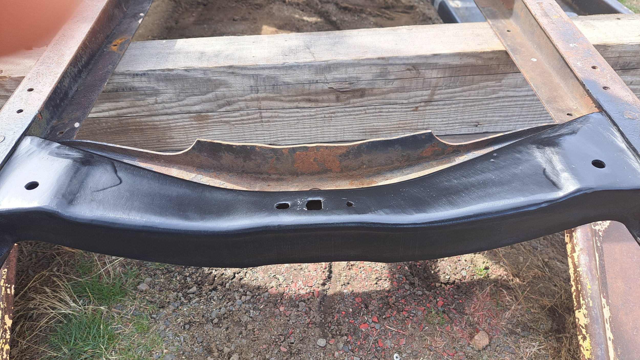

    On this note... the crossmember & frame where it attaches on mine both need attention. If I have a 28/29 xmember maybe I should just look for a 30/31 and replace it entirely since I'm going to have to remove the crossmember anyway to repair where it installs and address some cracks in the member.

    Yes, use the '30-'31 crossmember. It's easy to see the difference. '30-31 the radiator pad drops below the frame rail. '29-'29 the pad is raised up.

    I have determined that it is a 28/29 xmember but after looking at it I might be better off just cutting the pads out and welding them back in lower the way you did, Dave. Separating this crossmember from the frame will be a fairly big undertaking. On the driver side it's just bolted in place but maybe on the p***enger side it kept coming loose so Sid just welded it up over there and boy did he ever burn it in. :rolleyes: The motor mounts are also welded to the crossmember.
    Also, he's got some serious plate welded in across the top of it. I guess he broke the original crossmember and this is what he could get his hands on to replace it so he beefed it up.

    I just went back and looked at the picture of the front cross member. He did weld a thick piece of flare bar on top of it. As far as the radiator mounting pads are concerned, you could cut those out and er weld them lower or customize the mounting tabs on the radiator.

    @trevorsworth , that's why I cut mine down. Easier than knocking out the original rivets and changing the crossmember. I sliced them off with a portable bandsaw and and angle grinder.
    Car is being built as a '30 Tudor AV8.
