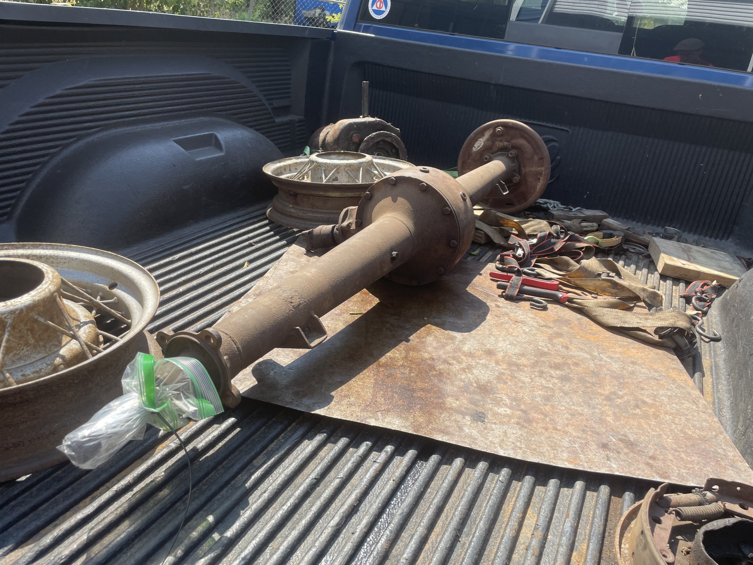

    Got my hands on a probably 46 rear with the spring pads still on it. Only thing is... they seem to be upside down. Can I just unbolt them and rotate the axle bells 180 degrees? I can't imagine any reason why not.

  12. trevorsworth
    Joined: Aug 3, 2020
    Posts: 2,057
    trevorsworth
    A third one actually lol but this will be the one I actually use for this car. The gear ratio in this one should be friendlier to the flathead than the others. The other two have had the pads hacked off and been set up for transverse springs. I will use one of the others in a future car behind this Hemi I picked up.

    Oh the bells aren't upside down, the diff just mounts under the springs on that year truck. That makes sense... anyway I guess I can just flip them to put them above the springs.
    porkshop and Outback like this.

    Just keep an eye on the backlash on the pinion. Will bolt up
