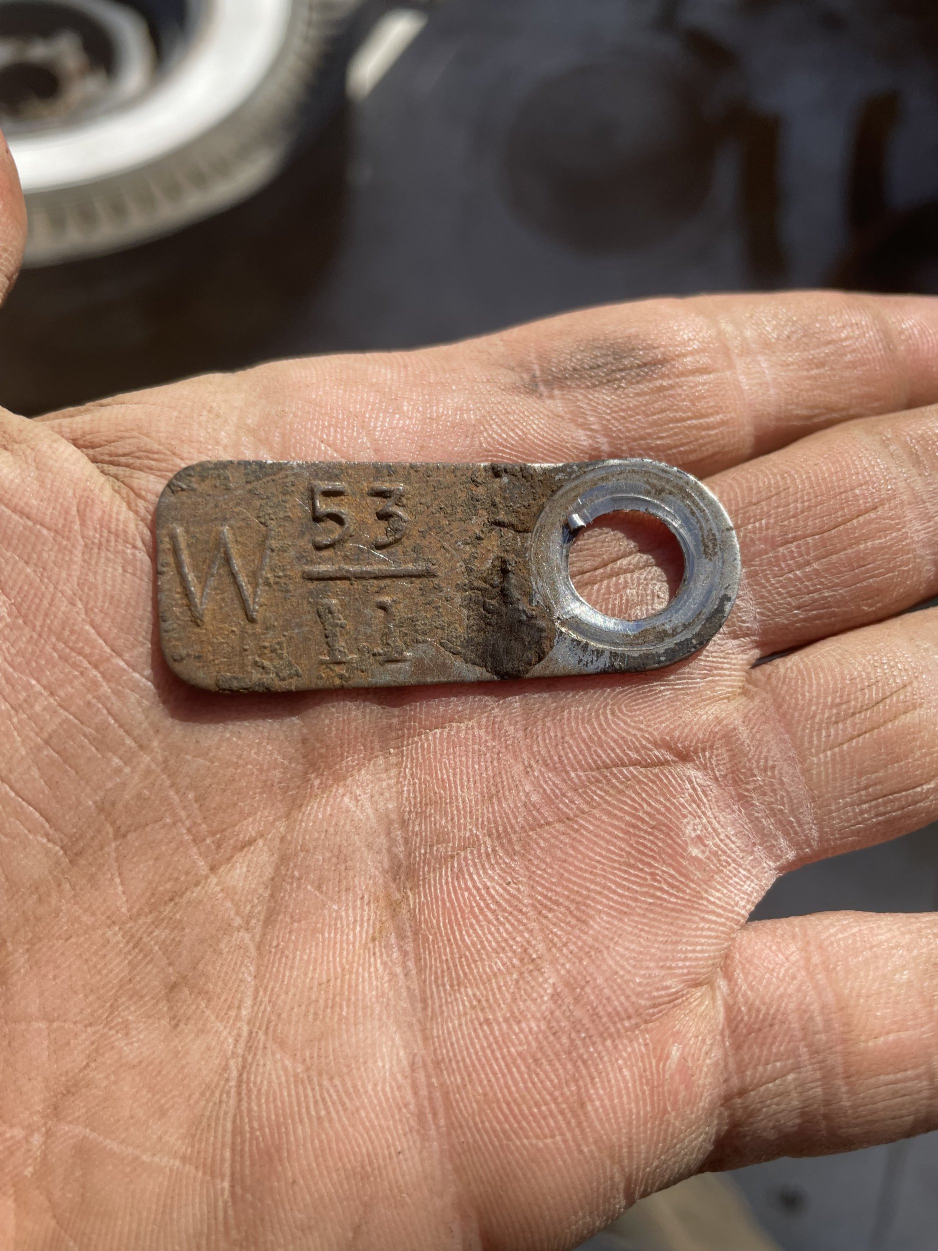

    I forgot... found this tag on the rear end (under a diff cover bolt). This works out to a 4.88 gear ratio which was available in the Dana 41 in Jeeps. Based on a diff cover variation (a tag that says USE ONLY HYPOID GEAR OIL) I was able to date the axle to 1948-1949.
    I'm still puzzled by this diff. I don't know very much about differentials beyond the obvious. I thought if the wheels spin the same direction when you spin one, it is a limited slip, which this one does. But I don't see any kind of limited slip gizmo in it and it isn't welded...
    I have learned that the 41 can accept the gears and bearings from a 44 so I should be in good shape if it ends up needing anything.

    48 - 49 Jeep Dana 41's were 5x5.5.....weird??
