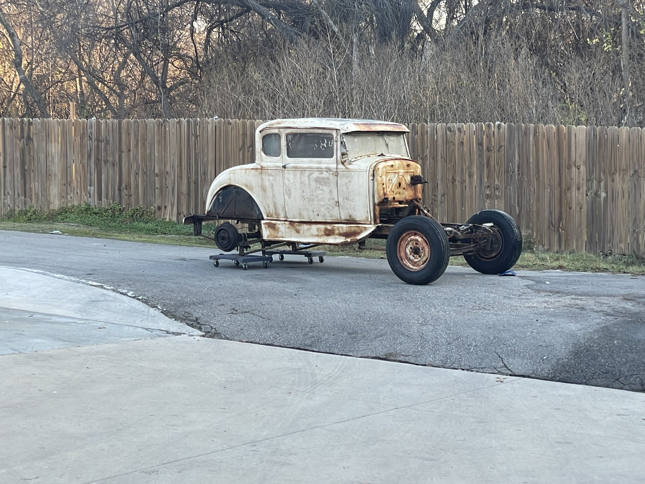

    Yeah... I'm confident it's a Dana 41 and the gear ratio seems to be a specific 48-49 Jeep item... can't think of a reason he'd switch to the Dodge brakes when the Jeep brakes match the front's bolt pattern, but they are definitely Dodge (39-42 car). I'm ***uming they did not just bolt straight on & required some machine work so it seems like an odd choice.
  2. Joe Blow
    Joined: Oct 29, 2016
    Posts: 1,904
    Joe Blow
    Yeah, it's definitely a 41......agree there was something as to why it was done that way. Had a Willys Overland L6 226 pickup with the same 41-4:88 rear end in it.....in low/low that thing could pull an oak tree out by the roots with no hesitation.;)

    I always advocate for leaving things 100% as is on these "original" hot rods but in this case I don't think anyone would fault you for "repairing" the damage done when the owner tried to change over to parallel leafs...seems like he was experimenting after the rear got ripped out and it wasnt the "as raced" set up anyway... a stock spring and crossmember along with a tasteful 4 link (perhaps made with Ford bones) or a pair of split bones (drilled through at multiple points and stuffed with steel rod then welded solid) with a 3rd one going from crossmember to top of the pumpkin to prevent wrap up would be traditional and solid...find some Jeep or Ford brakes and keep the cool rear axle but swap in some more street friendly gears....reinstall them when you go racing!

    I think he did run this parallel setup and probably for quite a while... I think it's cool, definitely different. It looks strong and well thought out. We'll see how it behaves on the street once the car is on its own power before I start thinking about re-engineering it.

    Some guys add metal to the frames of their race cars for added strength. Sid took a different approach.
    I'm gonna have to fix a few things and I feel like I really ought to reinforce the frame around the steering box if I'm gonna drive this thing regularly. No way that doesn't twist in turns.

    Cross steer with no pan hard on a scalloped in boxed frsme I promise it flexes. Honestly
    Might even flex with no motor in it turning the wheel in the garage

    Man, that profile is right on! :cool: I'm just trying to figure out one of these is stored in a barn nearby so I can have one too. :p

    We'll see where it sits after I drop a motor in it... looking forward to getting pics of it in its heyday from Guy too. I don't know if I want to exaggerate the g***er stance too much with a 95 horsepower flathead up front...
    As it turns out, Sid was the owner of a pattern shop, aptly named Sid's Pattern Shop, right next door to the Lockheed Martin facility my boss worked at. Fort Worth used to be a small town! They never met, but he recalls seeing the pattern shop every day.
    I have struck a deal with the boss to keep the car at work so we can get it done quicker... over the next few days we will be finishing up the biohazard cleanup and getting to work on painting the frame/undercarriage components. Being able to use the two-post lift will greatly speed this process. I want to get the car stabilized ASAP because it has not been outside for a long time and I'm already seeing fresh rust forming.
