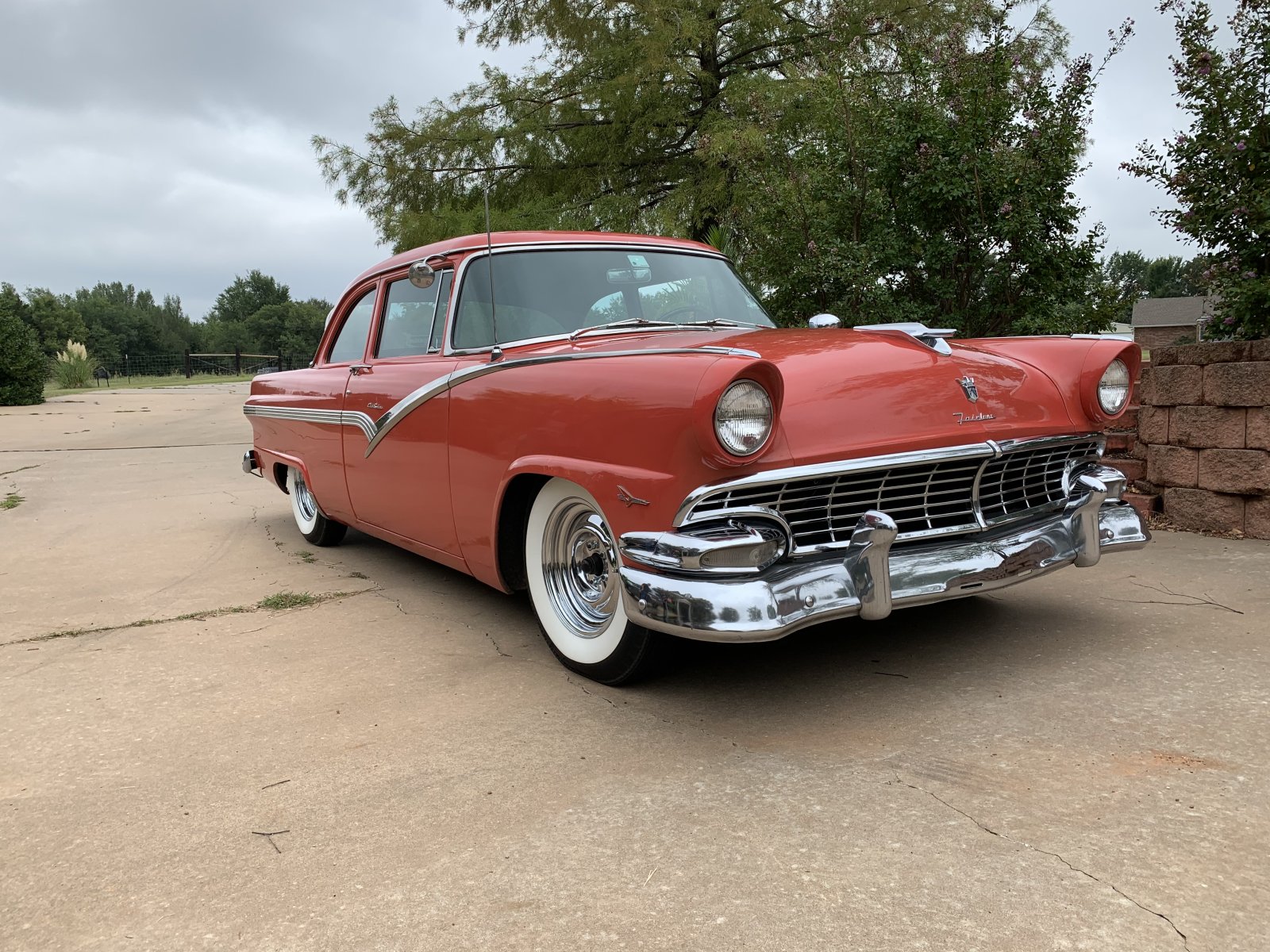

    Ok, so first off, my paint isn’t quite 70 yet, but is getting close. :D Also, I have been painting for 40 years now and know how to make paint nice. But, I have to admit that I am no expert in keeping old paint nice as evidenced in the shine, or lack thereof, on my Fairlane. When I got this car about 12 years ago, the paint was about dead. I hand rubbed it then to not take too much paint off since it is thin in spots. About 4 years ago, it was bad again so I decided to use my buffer this time mainly because I am older and fatter than I was last time. Well, it’s dull again and I am running out of paint to buff so I need to find a better way. New paint isn’t an option since this car is still too nice for that and it can only be original paint once... I’m not looking for the latest fad wax or some clear coat or something but would like to hear from others maintaining old original paint on a car that gets used, sits out sometimes, etc. It rarely sits out but does if the shop is full of other **** at times.
    This pic was when I decided to shine it back up 4 years ago before the Gathering at the Roc. The shiny part is what I just did and the rest is what it looks like again now. Thoughts?

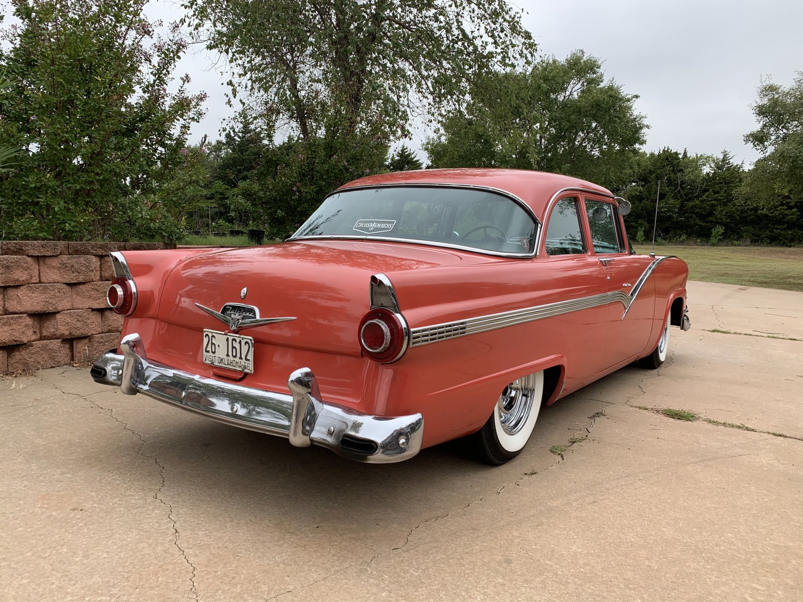

    And, this is what mine looked like last time I made it shiny and was going to wax it a couple times a year for reference.
    0C9CC173-81BE-4A13-BB0C-3519F0A2F4B1.jpeg 955F3821-6744-4F10-9667-B1D56E6F1E58.jpeg
