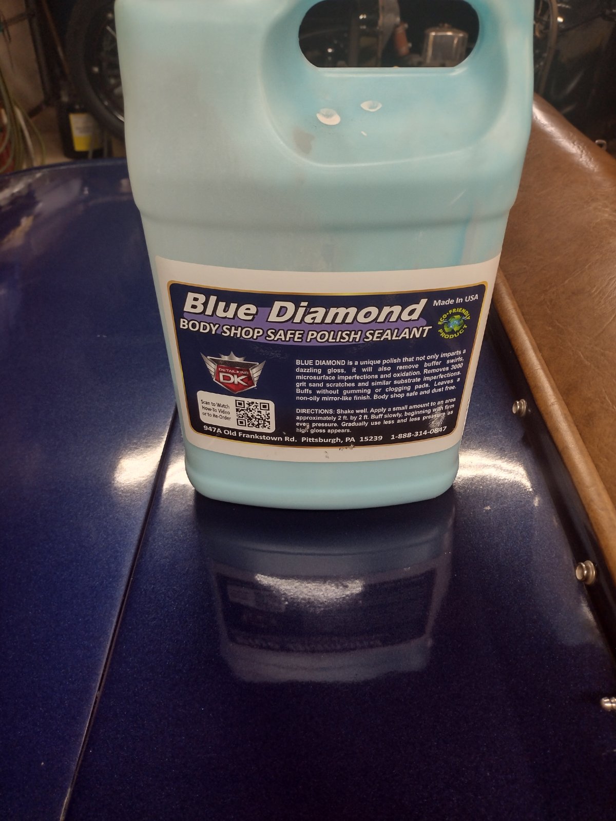

    Detail King has a complete line of professional detailing and car finish products.
    These two products have been my go to for years now. It is easy to use...low effort hand applied, and it smells good.
    It can be applied on the dead paint and wiped off...the oxidized paint will come with it. It leaves a durable shiny surface. My experience is that if you park inside it will last a year or more
    Your ceramic coating will have to prepare the surface with wash, clay and then precoat and then ceramic application....
    These products are top drawer in my opinion....I'd have given you a bottle If I had known when you were here....
    Good luck and report on the outcome...

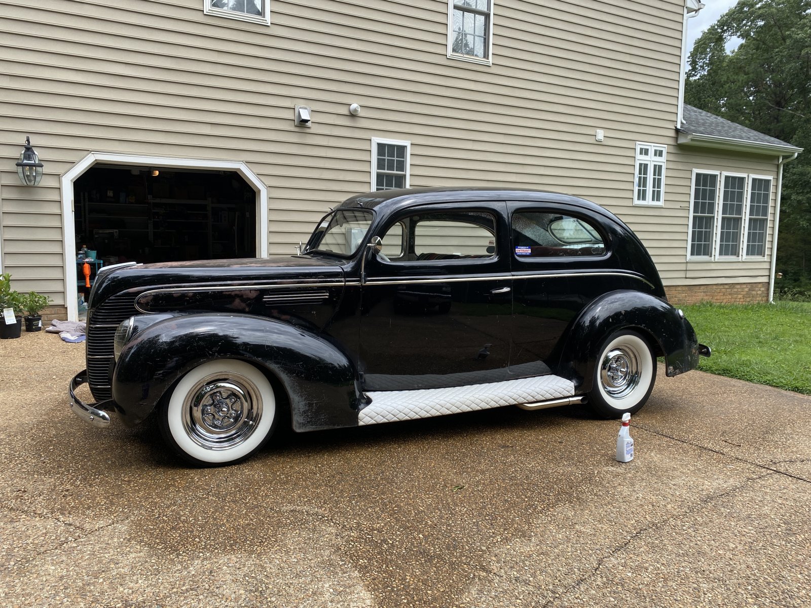

    My 39 has most of the original paint left on it. Yes it’s worn through in a bunch of spots but it shined up good. I wax it twice a year and it has stayed looking really good. I use the Meguiars gold gl*** liquid wax. I can watch it soak into the paint almost. When I wax it I do it 3 times back to back and really rub it in. Use almost the whole bottle each time. But it works and hasn’t faded in almost 3 years. A bunch trips to NC and TROG plus a cross country trip to the salt. It’s getting used for sure. The picture below is last week. After a quick wash. 319D7D35-1220-4155-9393-C20292C36DC7.jpeg

    I did a whole breakdown of how and what I used to polish the paint on my 39 in my build thread.
