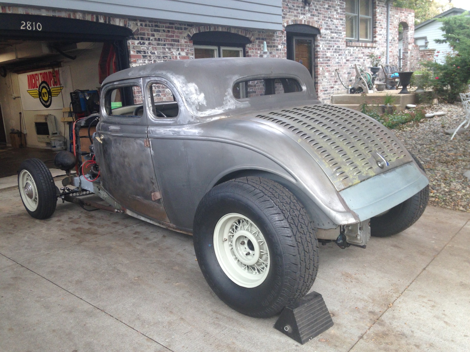

  26. Rocky
    Posts: 17,641
    Rocky
    Classified Editor
    Gibbs worked for me. It's the only petroleum product my body man will allow in the shop. Wipes off with lacquer thinner. 34rear3_4ths2016.jpg [/ATTACH]
    lo c dan, 210superair and Budget36 like this.

    210superair
    from Michigan
    That car is sick.....

    from Mesa, AZ
    I like your ride
