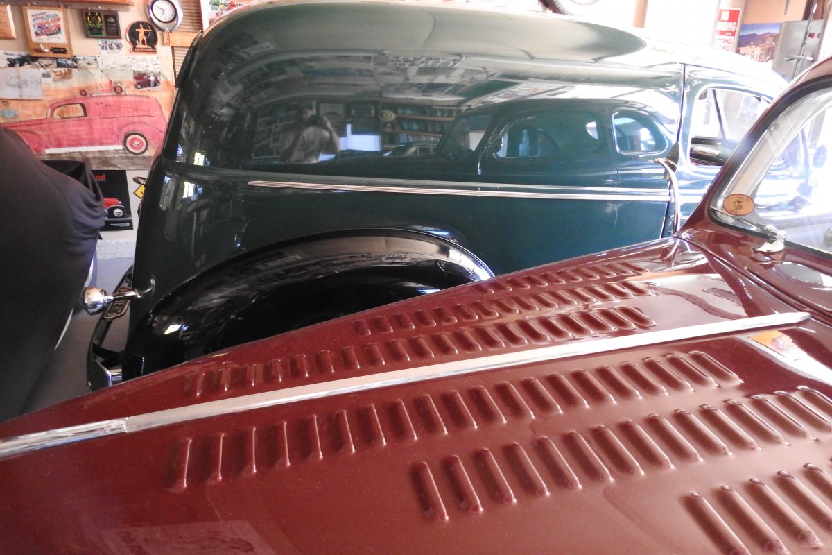

    LOU WELLS
    from IDAHO
    It Is Worth The Trouble And Throw A Piece Of Plastic Over The Engine While Washing And Drive Fast In The Rain.....Simple... DSCN4065.JPG
