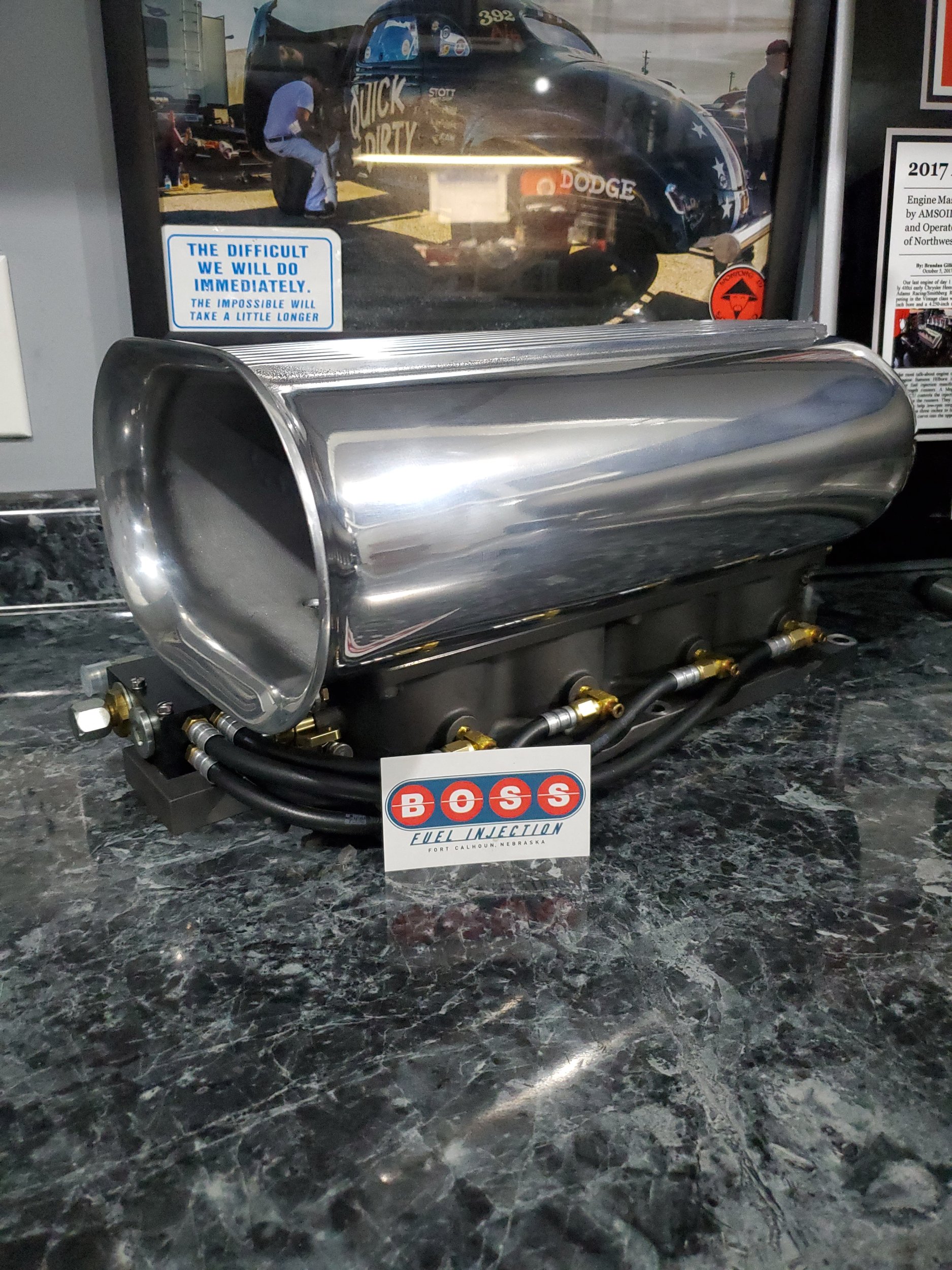

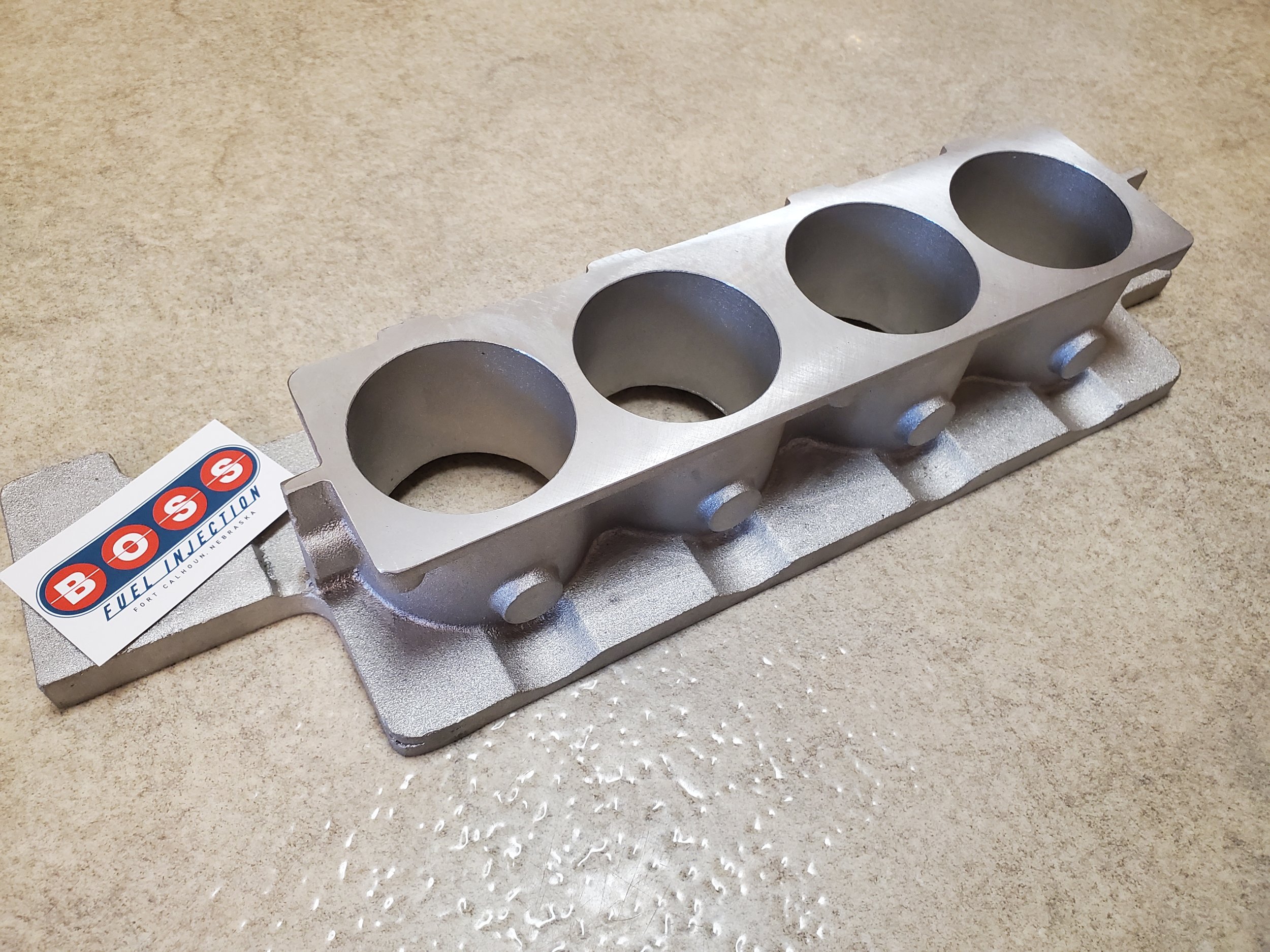

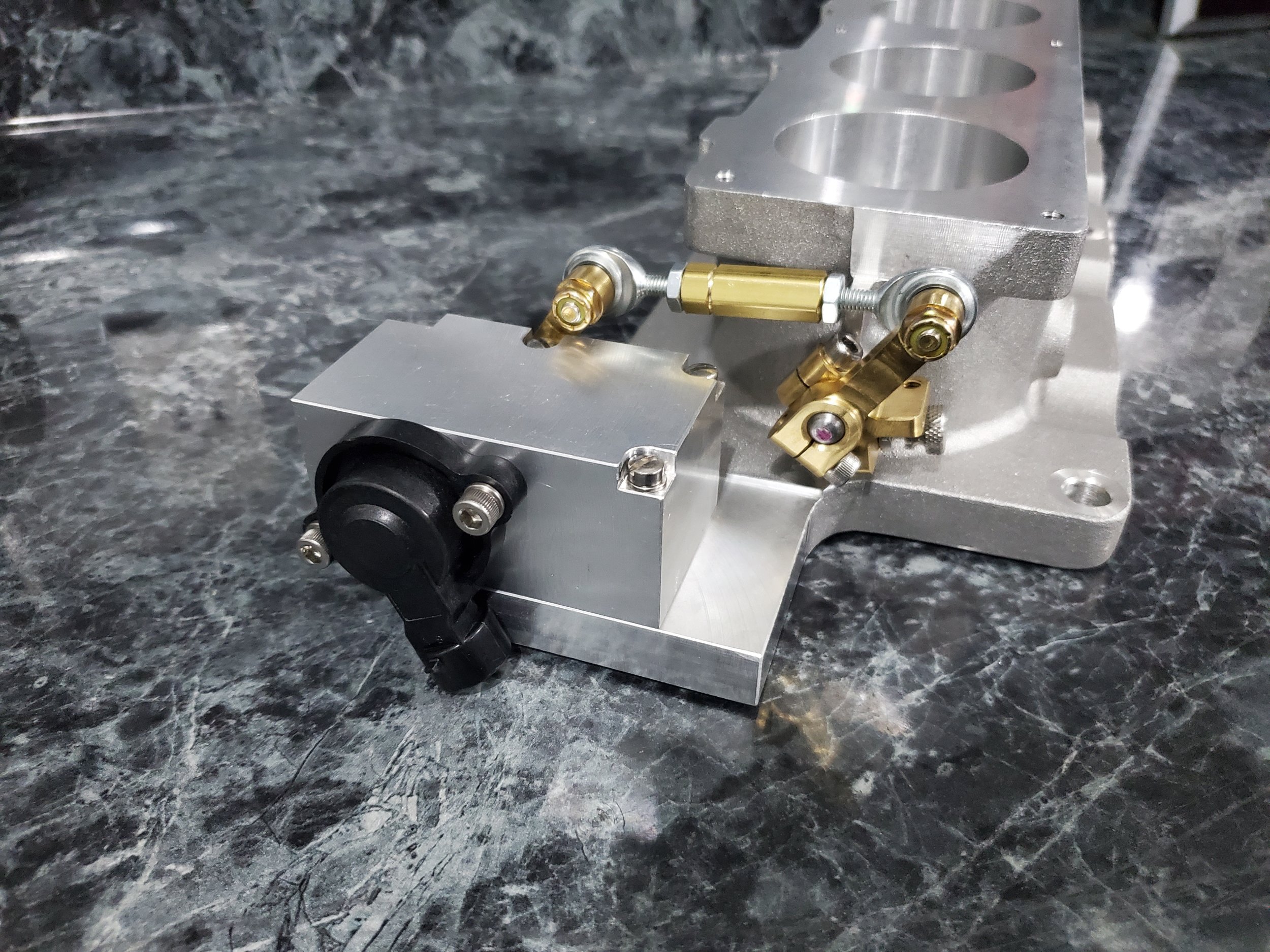

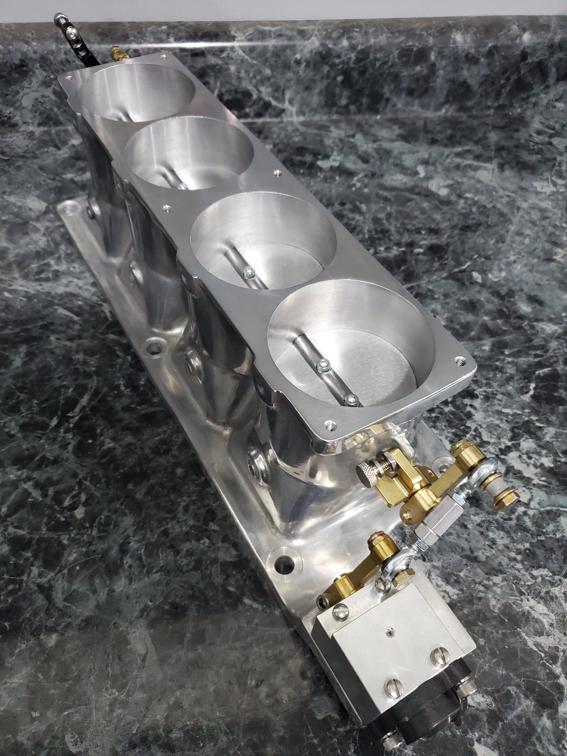

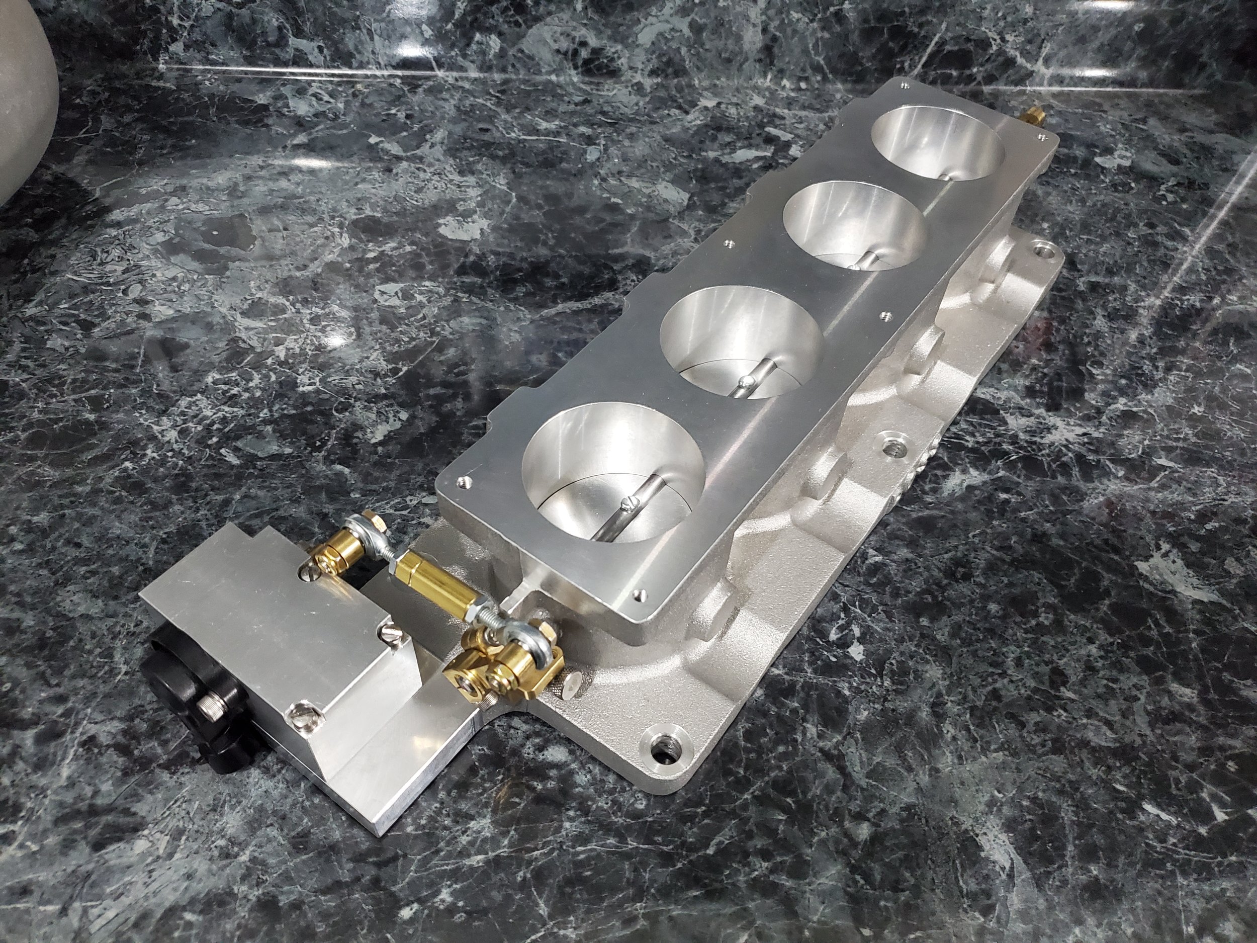

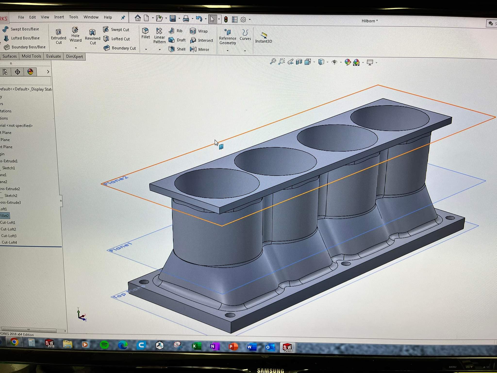

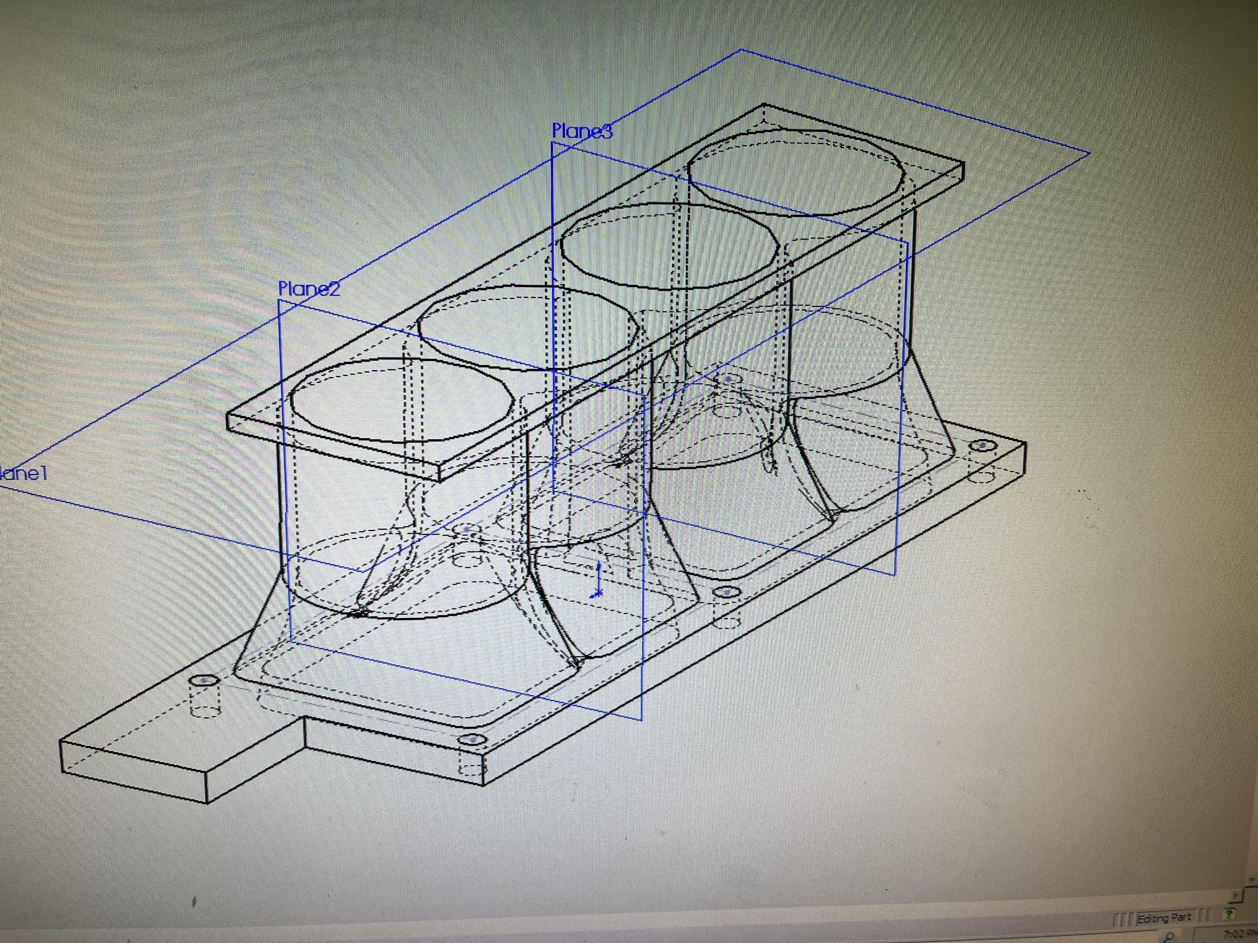

    Well today I turned 43 years old and felt like sharing something with everyone. I've been holding back on some projects that I've quietly been working away on for the past 3 years so I figure why not share with the world what is coming very soon! As many may be familiar with my work restoring Hilborn Injection units, I have been tirelessly working on trying to keep things alive and going whether with owning the brand or not (still up in the air). I started a second business called Boss Fuel Injection a few years ago specific for this type of work. I decided to do my own castings and start with blower injectors to get things established and expand from there. So I'll share some pictures of some of the highlights I've guarded so closely for so long.
    First up is the Short 4 Hole:
  2. 402BOSSMAN
    Joined: Jul 26, 2015
    Posts: 499
    402BOSSMAN

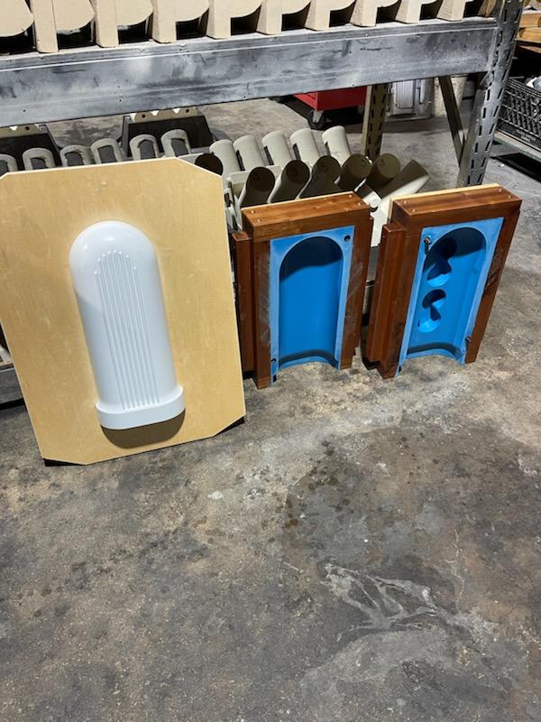

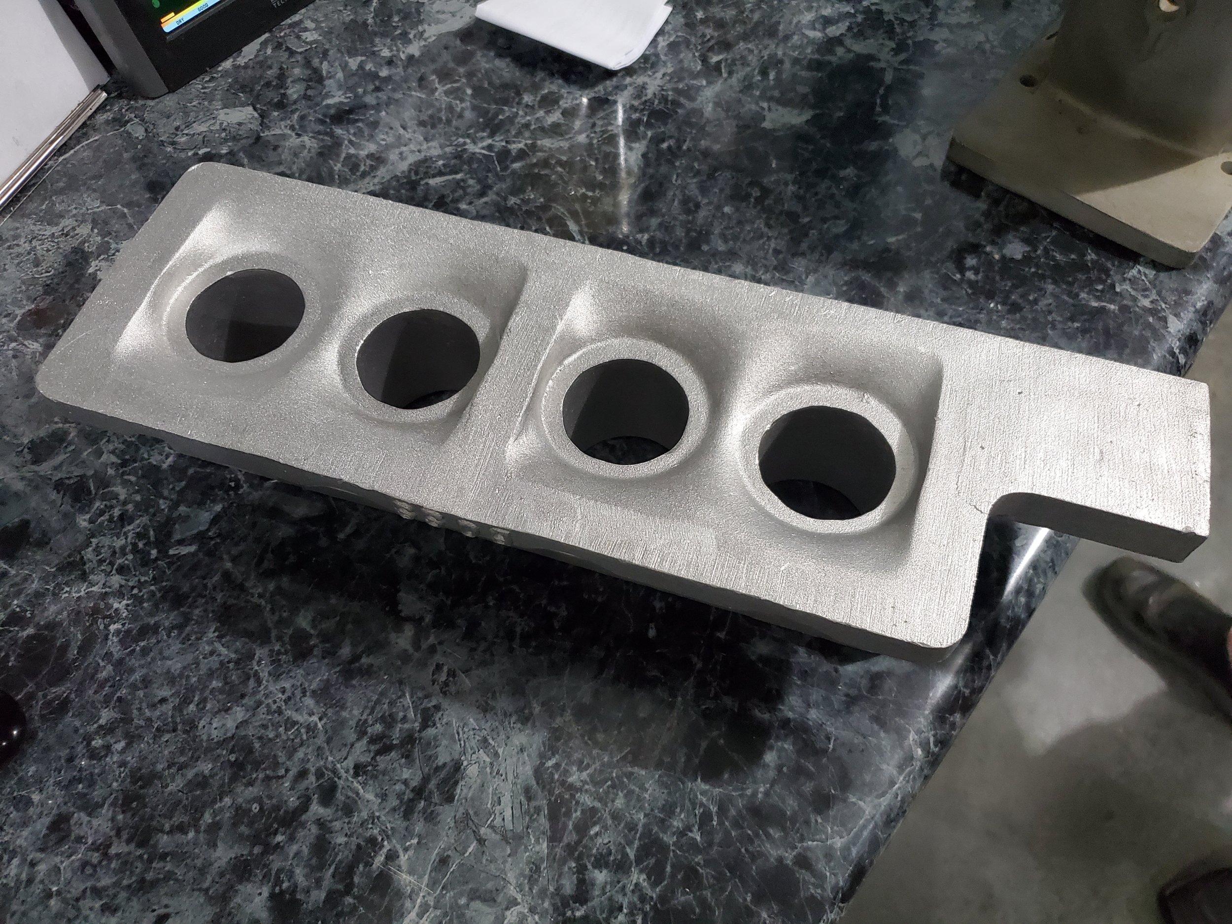

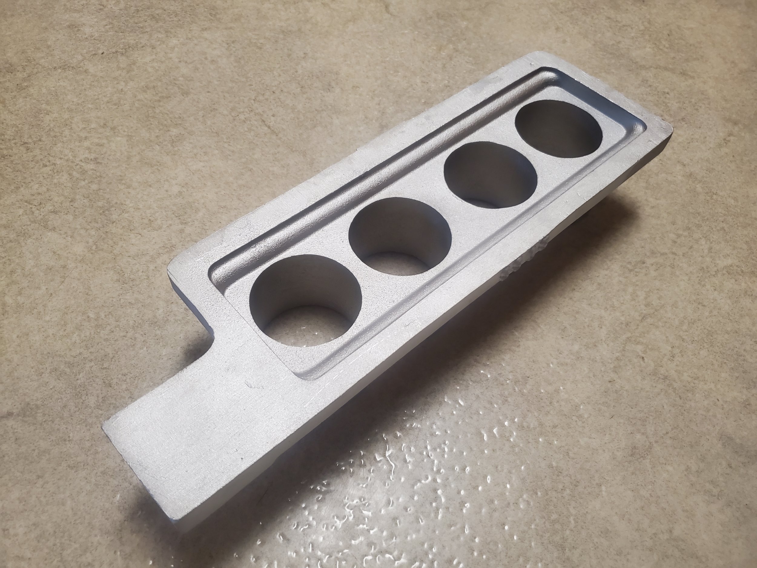

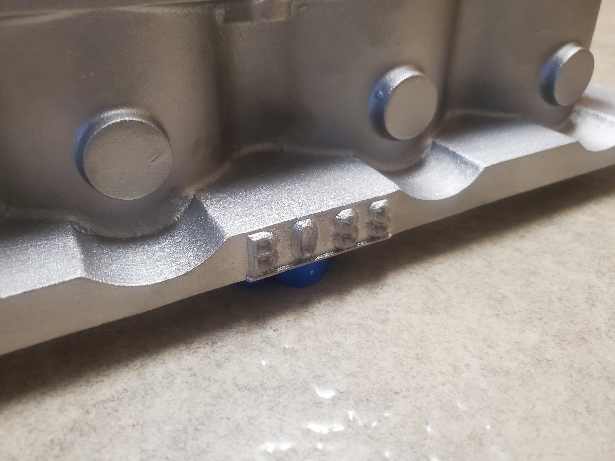

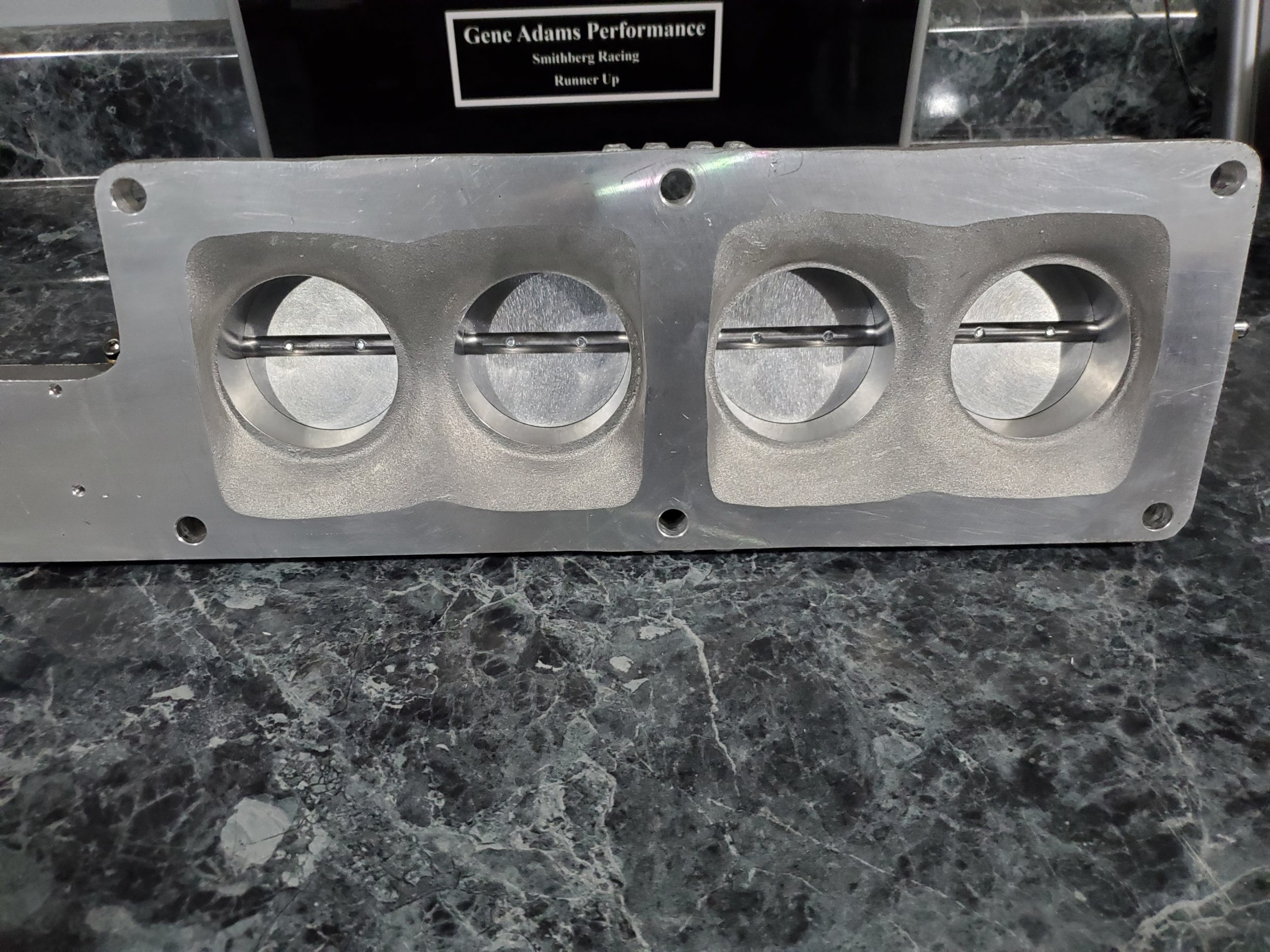

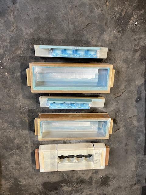

    So with these castings I made a few different bore sizes in the castings to be able have a bores size of around a 2-1/8" all the way up to 3". They are excellent quality castings A356-T6 heat treated castings just like a cylinder head. I also dealt with any flaws or issues that were common and found a way to modernize them (especially the bottom side). Patterns turned out nice!

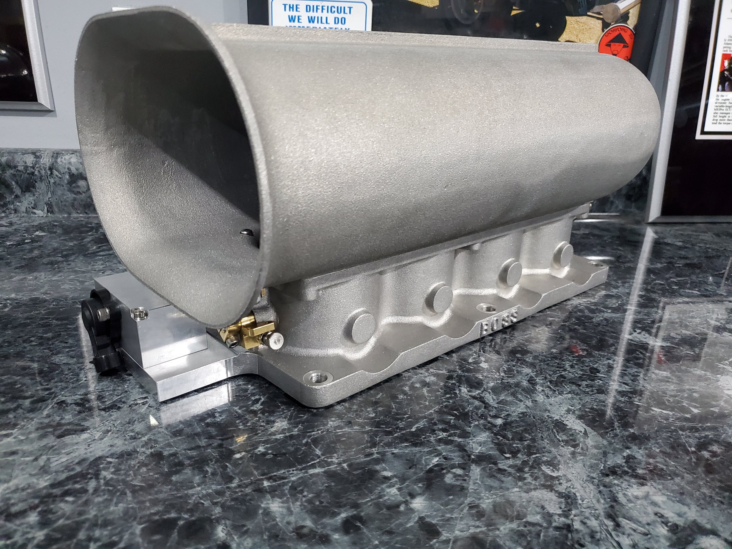

    Next is the Scoop:

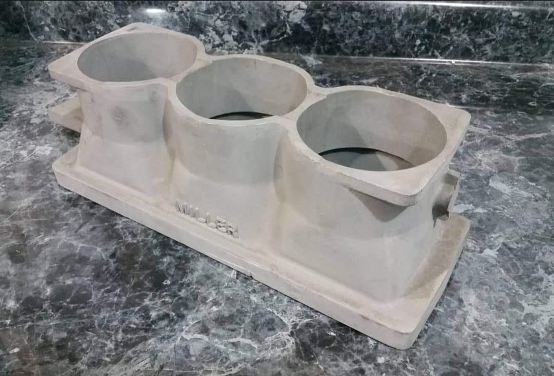

    Also working with the Miller 3 Port which has three 4" Bores in it. Pretty neat piece! Wild Willie Borsch ran one on his Funny Car back in 1973.

    DAMN that's Killer!!! If they didn't have your name cast in them, you'd never know that they weren't OG Hilborn! That is BAD ***!!!

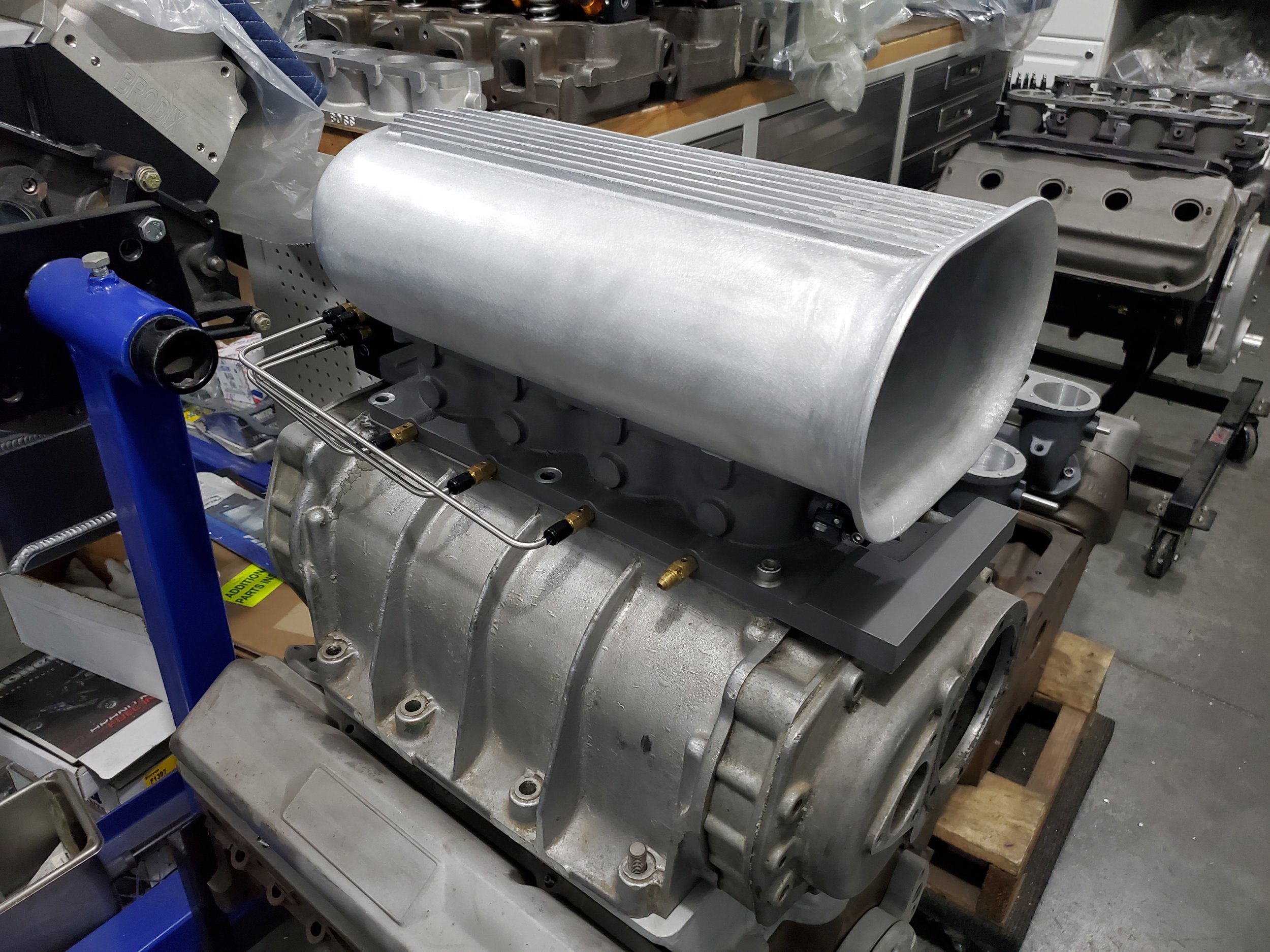

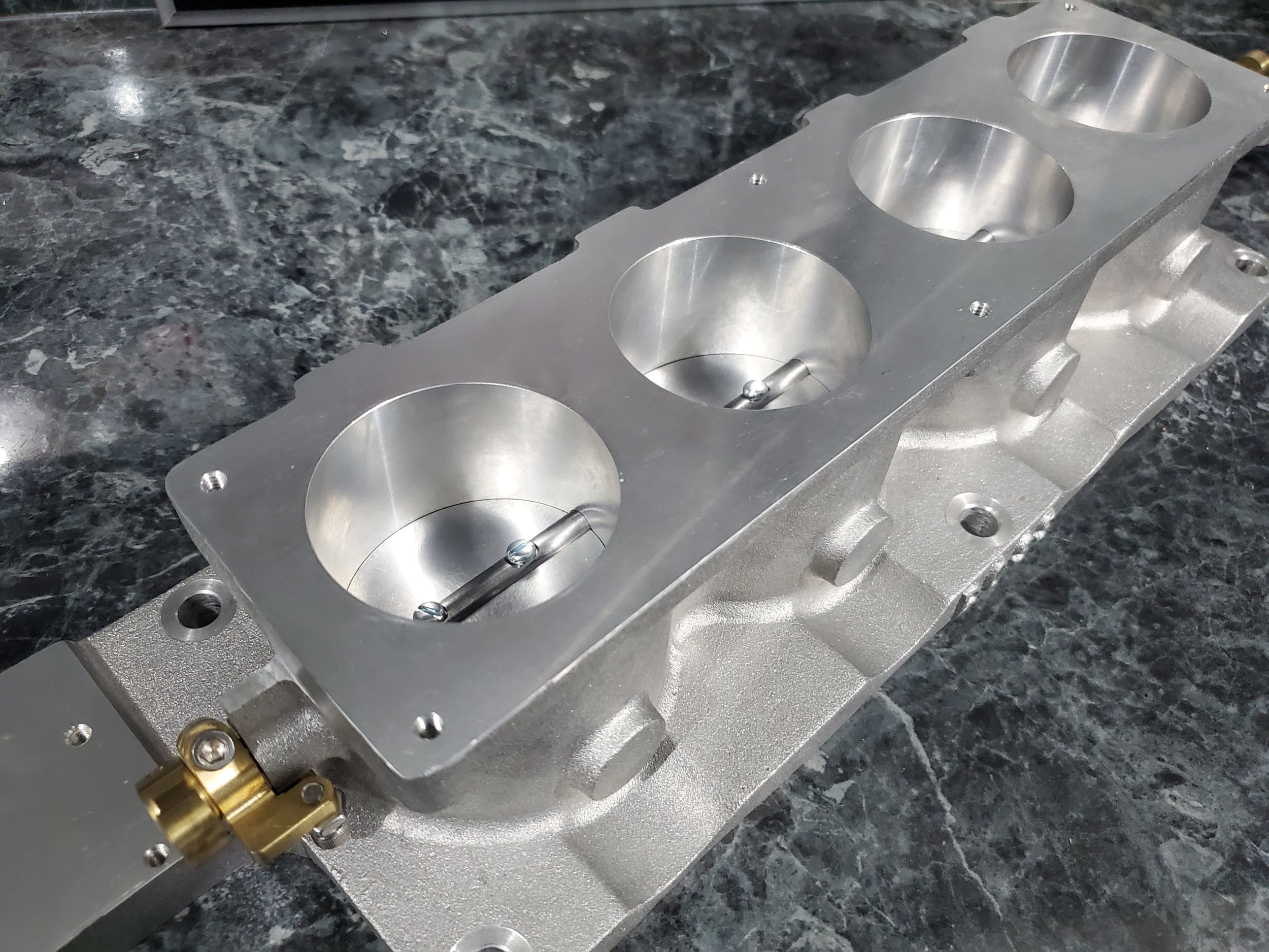

    One all put together.

    Your commitment of time and $$$ is impressive, many racers will be indebted to you. Did you also do the patterns?

    I didn't do these patterns. I'm considering doing a few of them to get my feet wet. Pattern work can get expensive. Sometimes you just got to pay the many, quality is number one for me on this stuff.

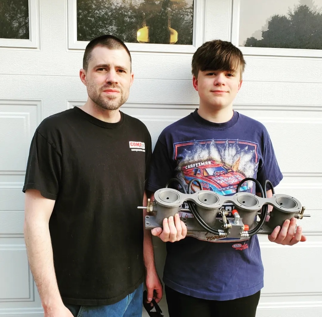

    Here is a really cool project. I was asked to restore this Offy Injector for a gentleman restoring the car. My oldest son Nathan wanted to help me in the shop that day so at 14 years old I turned him loose on my mill to machine some throttle shafts with me over his shoulder. He made three that day to perfection and proceeded to rebuild about half of this injector. I finished it up the next day and called the gentleman to let him know I was done with it and how much insurance should I put on his package to return it? He said "well it's priceless how do I put a number to that?" I asked him why was it priceless? His response was "that injector belongs to Mario Andretti, I'm restoring his car right now." So after the shock wore off I asked my son to take a picture with me holding it in his hands. He doesn't realize what he did yet still this day, but later on he will figure it out. I asked him to relay a message to Mario that my son restored half of this injector at 14 years old!
