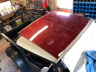

    Hey all, slowing plugging away during COVID on my 1929 Ford Tudor. The header and visor were completely rusted out and missing bits but I finally got it all back ***embled through pictures online. I have a super specific questions and hope you fine folks can help.
    I'd like to do a snap top that rolls back on the Tudor but not sure how to keep the wind and water out of the front header seam. I asked a local rod guy and was told any old upholsterer will know the trick. Well, many google hours later I am left with no solution but feeling a little more like an idiot.
    As an example below, the fabric sits clean against the metal and can roll up if you want to feel the wind. Is it magnets? some universal header? I've also seen a couple of cars that used a piece of Awning track and kedder as a seal. Would love tips and help!

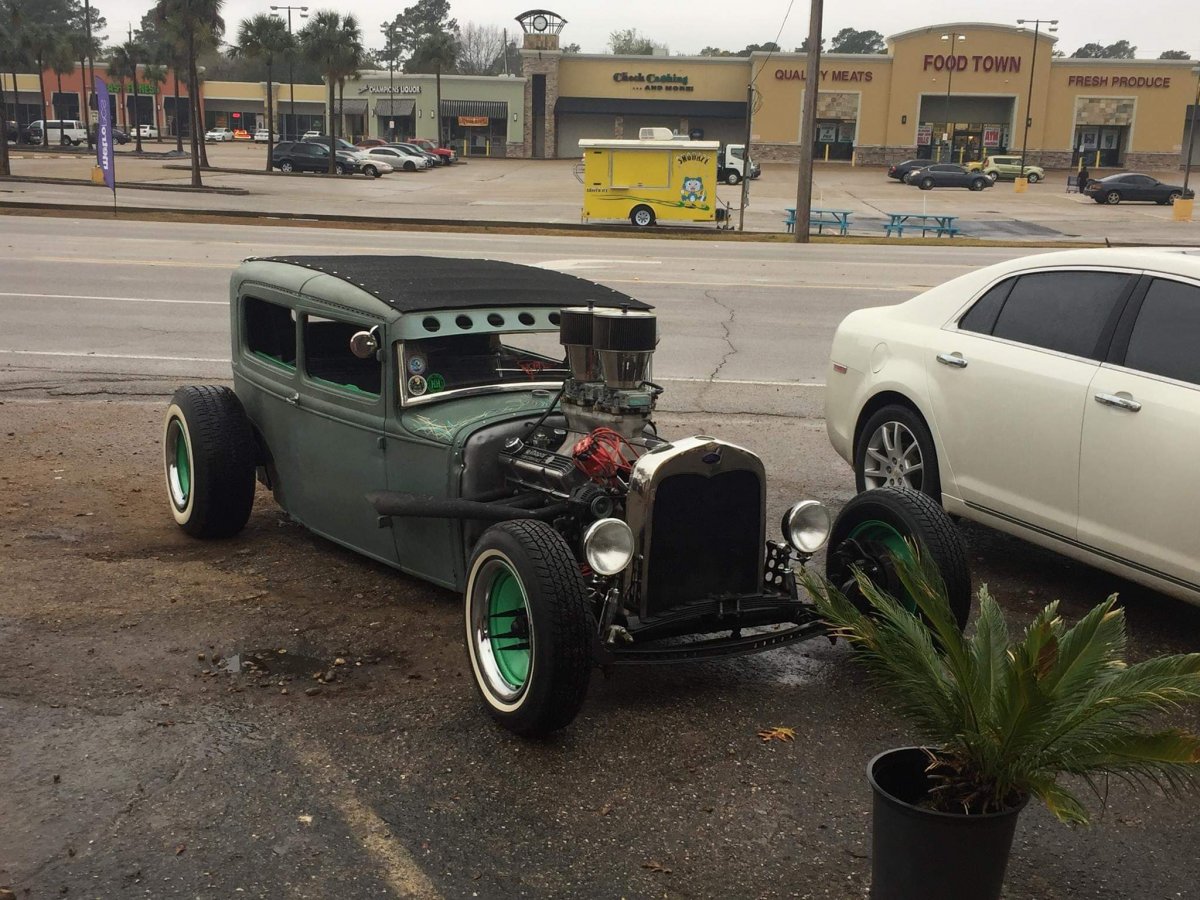

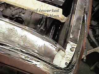

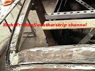

    I cut a Weatherstrip channel into my roofline , used the trunklid w/strip from a 37-38 chev coupe = one piece goes the full distance.1/2" wide - 1/2" deep

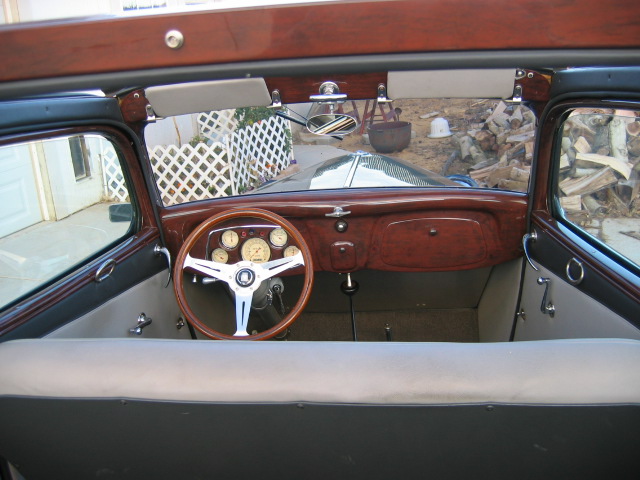

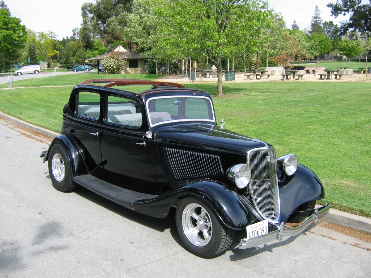

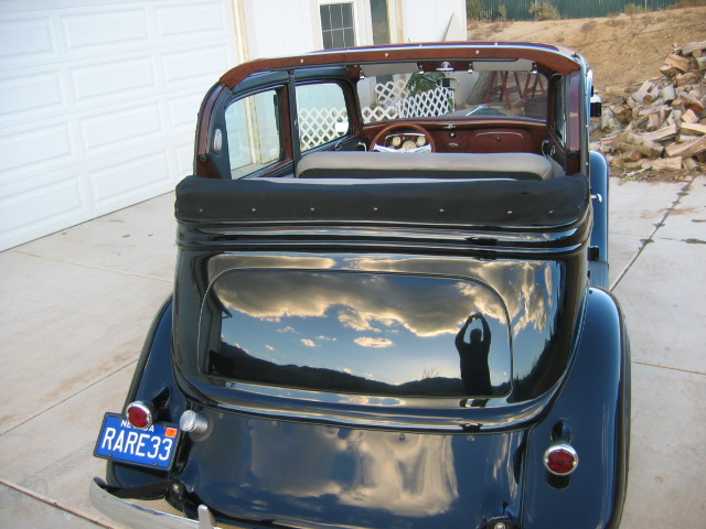

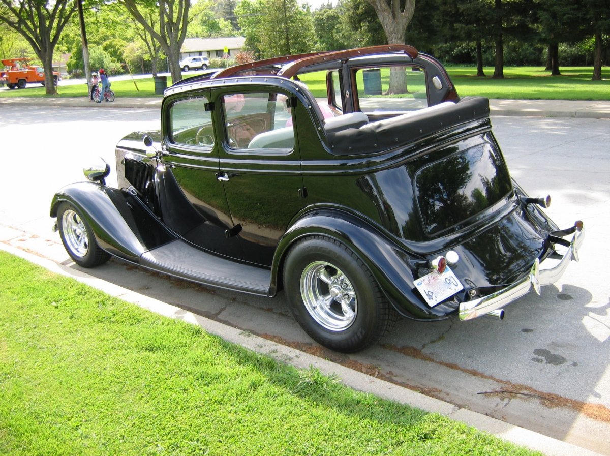

    I built a wooden header into my top fabric , with an spearhead post which is pulled down tight with a "T" handle ( see pic ) and added a " Cowl to Hood Seal " from a Ford truck just behind the W/strip
    See " Cowl to Hood Seal " in this pic
