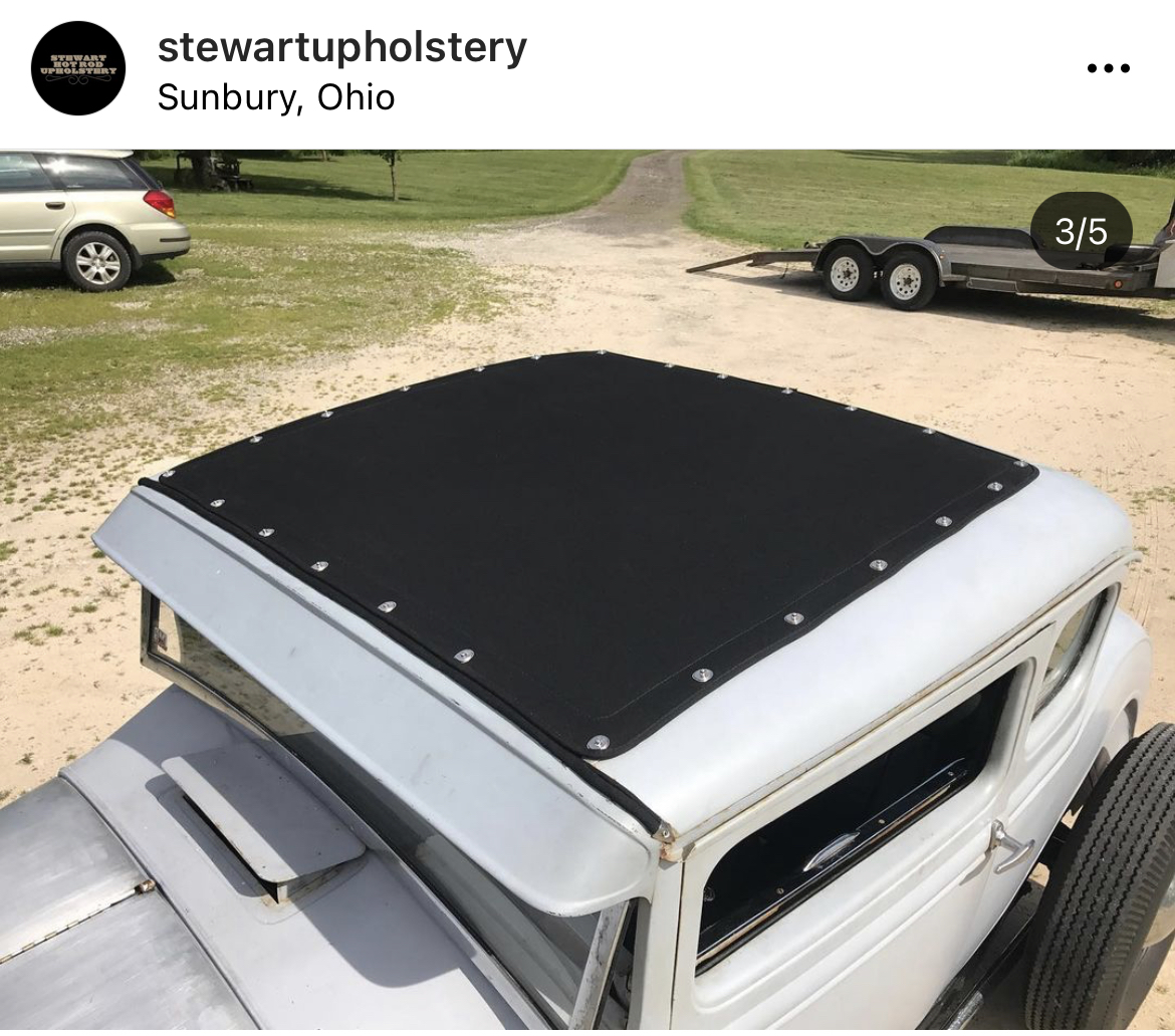

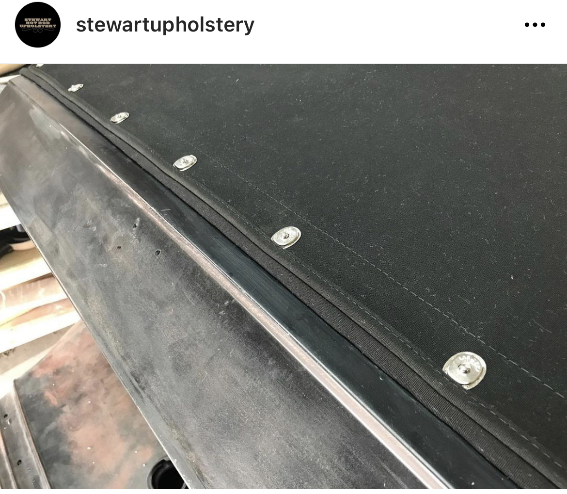

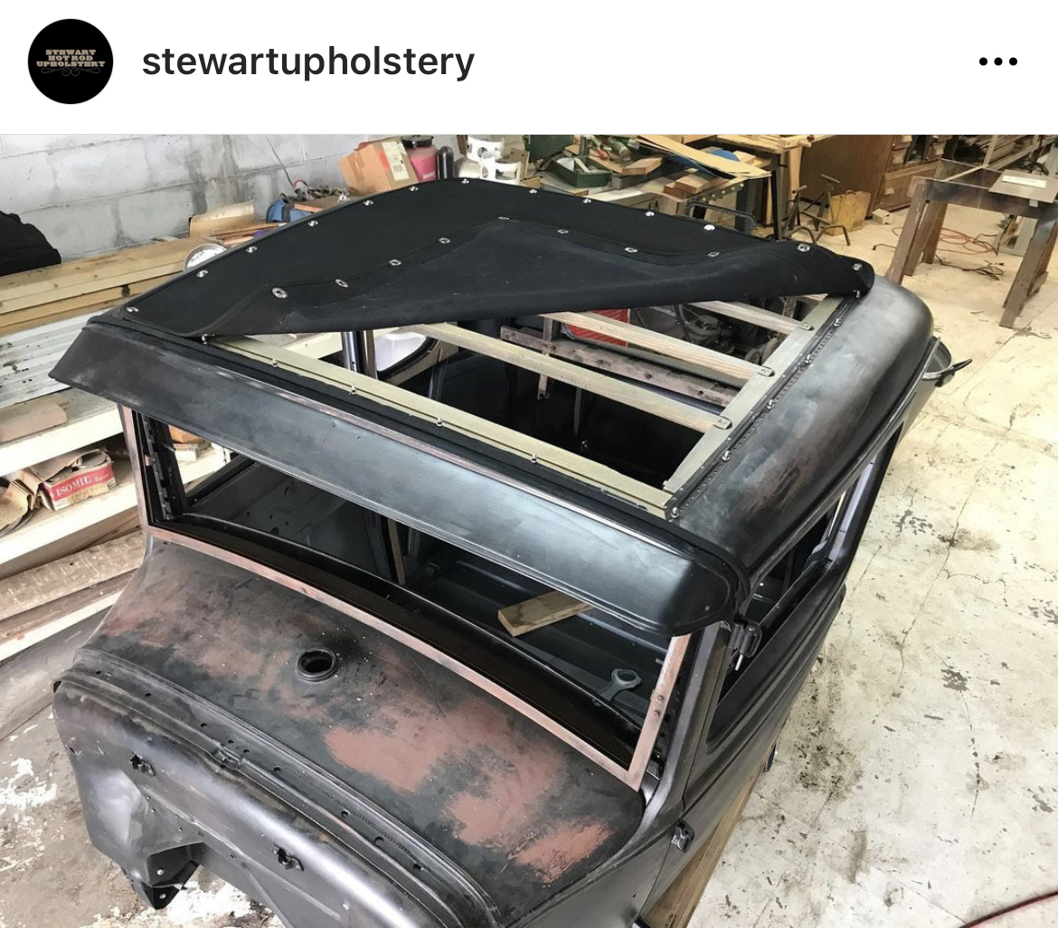

    A few Nathan has done in Ohio CEF6828C-1594-48FC-BBA7-2EE700ADF992.jpeg C4A0FE6F-A57D-4169-AFEE-6C3B2231EDB5.jpeg 9876BBA8-5B51-498E-8143-67B17FA535C5.jpeg B14D8586-AFE1-4D5E-B5DF-259E720C53DE.jpeg

    Wow these pictures are excellent sir. Llooking at the opening one, I see a channel in the wood header along with what looks like either a lip or a rubber seam along the sides right behind the snaps. Both water management tools are attached to the body as opposed to the fabric. I wonder if the hidem and the wire are just ways to stop wind buffeting the front edge of the fabric and lifting it up between the snaps.
