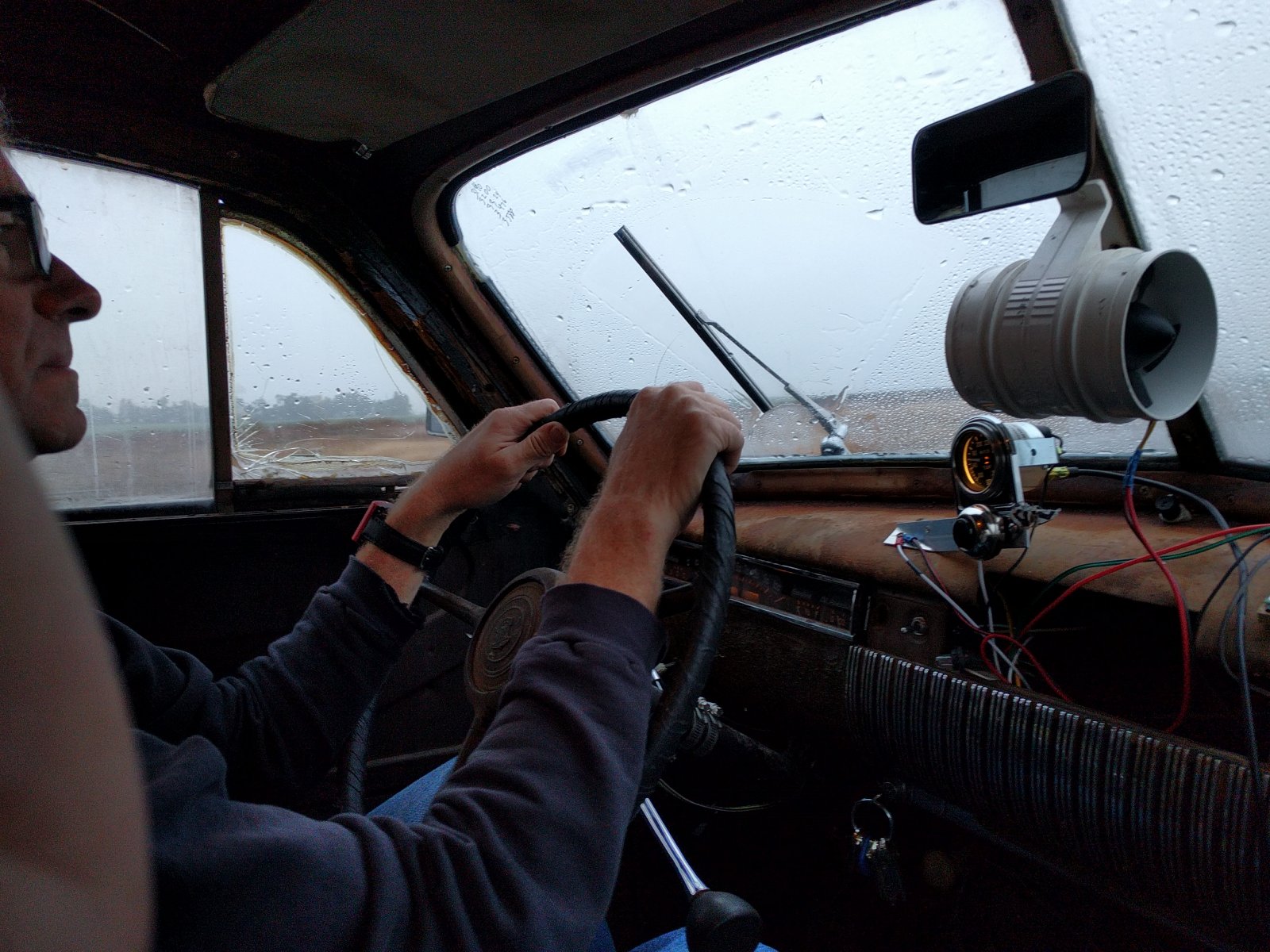

    I think the answer is airflow across the gl*** more than air temp. I have had vehicles with modern AC units where the ac went out you were still able to blow air on the windshield and keep it somewhat clear. I've had good luck with those "turbo" style summer fans,they look like a tube, placed where it will blow across your vision site. Not as good as a dedicated defrost with AC demist, but better than nothing.

    I've put a fan next to the windshield on a couple that didn't have real defrosters, and it works pretty well. The blower for a boat bilge is what I used. It's ugly, but hey, that's life.

    That is the same design fan as I was talking about. They move much more air than the larger diameter cooling fans. I bought mine at a truck stop.

  22. That's as close to having air-conditioning I have ever had in any of my cars. When I pointed it at the windshield, it then became the defrost unit. Mount them up high so they can do both jobs. You can buy ones that also oscillate, so it feels just like one of them new-fangled new car air-conditioners!
