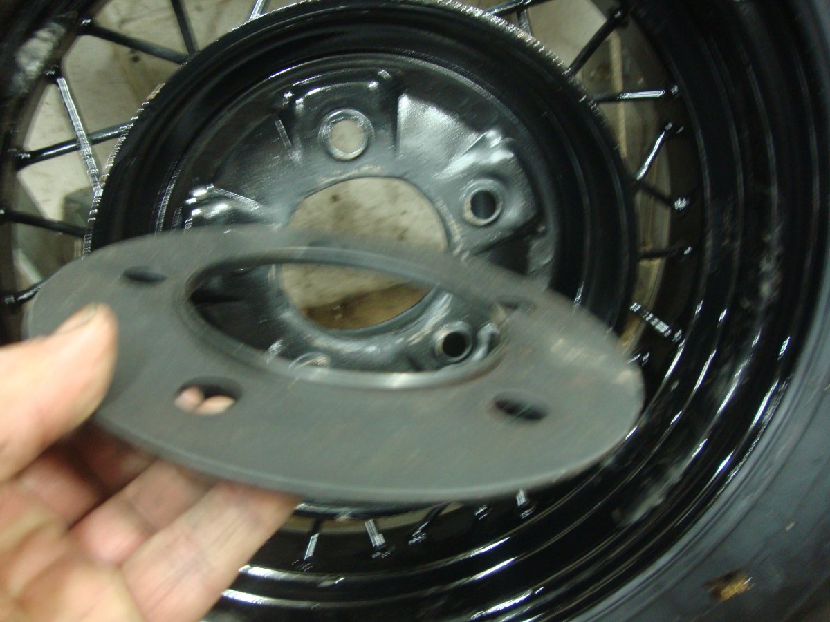

    I have seen that 39-48 brakes seem to be the normal swap but I don't like the non-energizing design and they need a center adapter, $20, for the wire wheels http://www.speedwaymotors.com/1928-1935-Early-Ford-Wire-Wheel-Support,5846.html (not sure what drums actually work, 1 1/2" dish or 1 3/8" dish, with the adapters and wires?).

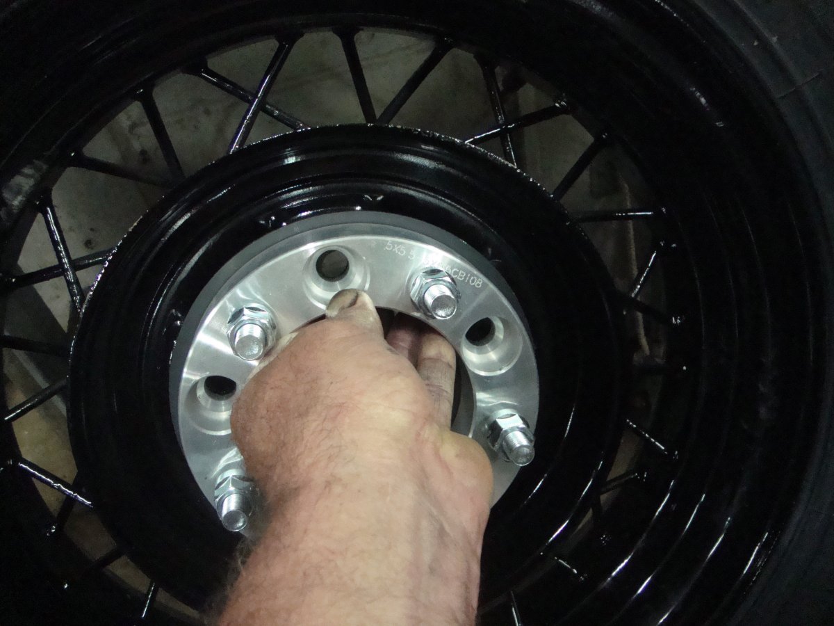

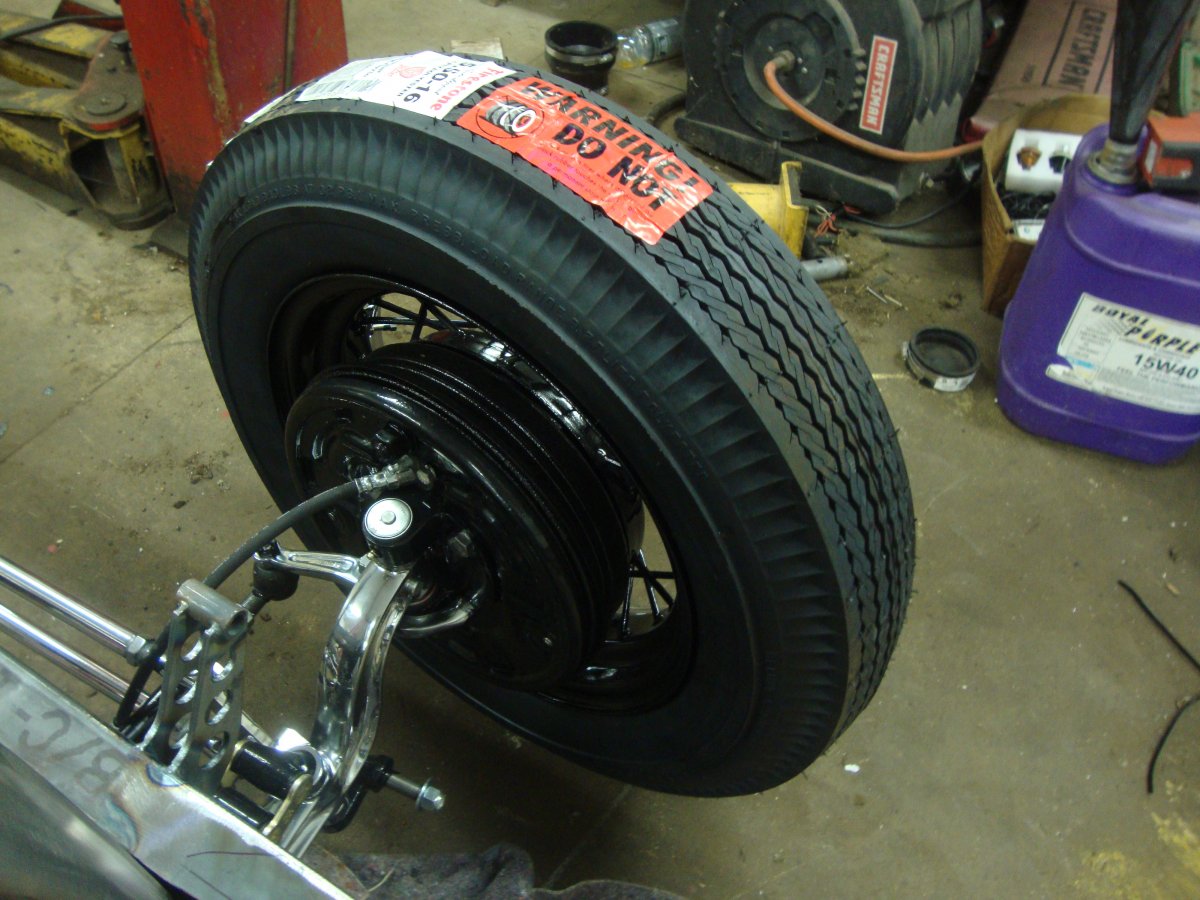

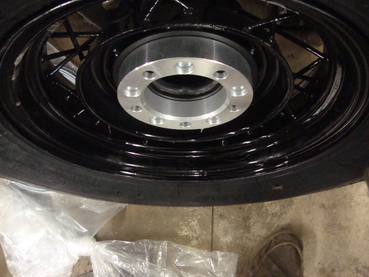

    I just did my Model A with 51 F1 brakes on the front and a Bronco rear with the stock Bronco brakes in the rear. I used a set of 5 on 51/2 by 1.25 inch spacers that I bought off of ebay for about $80 and I used the wire wheel support rings from speedway. By using the hardware and self adjuster kits that are listed for a 66 f100 with the same shoes. I did need to cut another adjustment slot in the left backing plate.

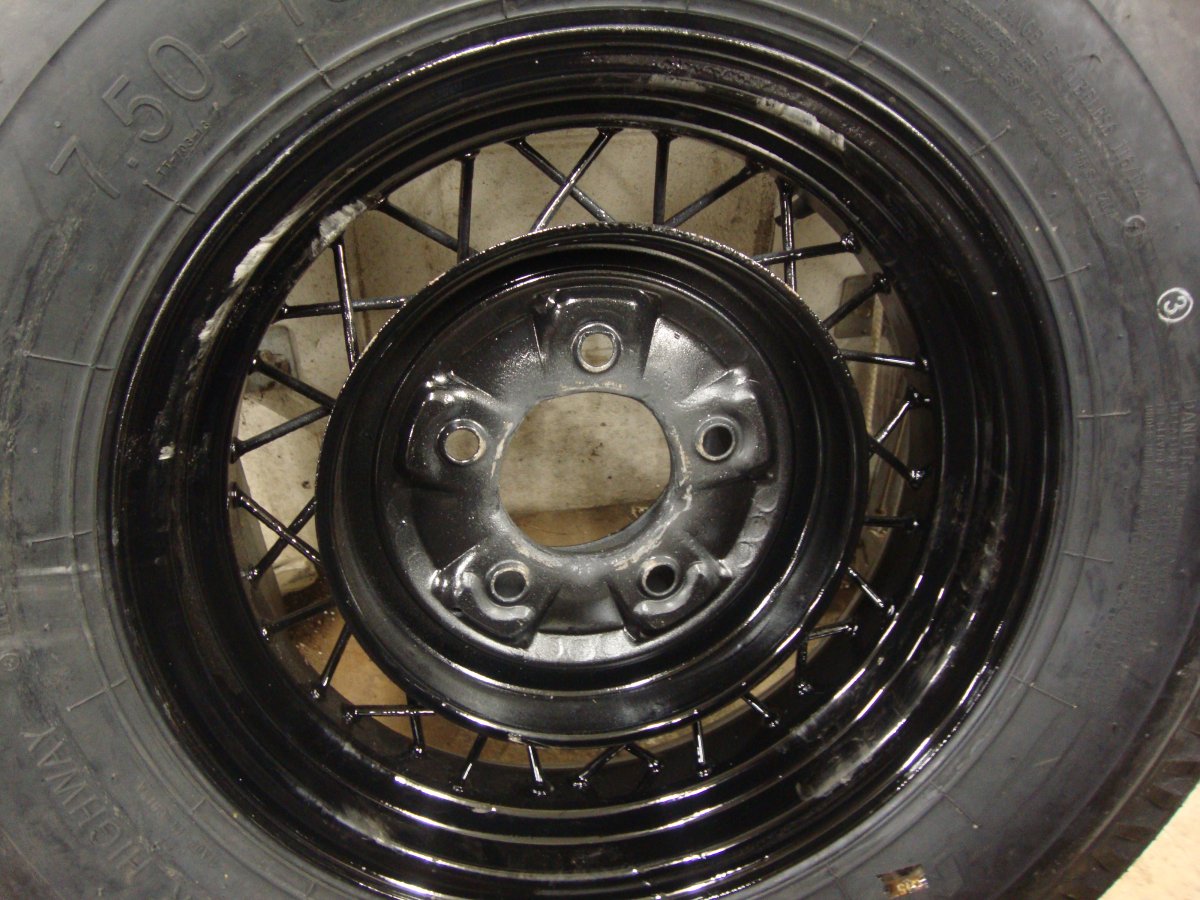

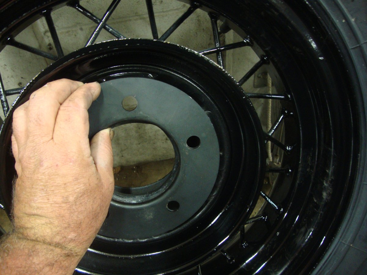

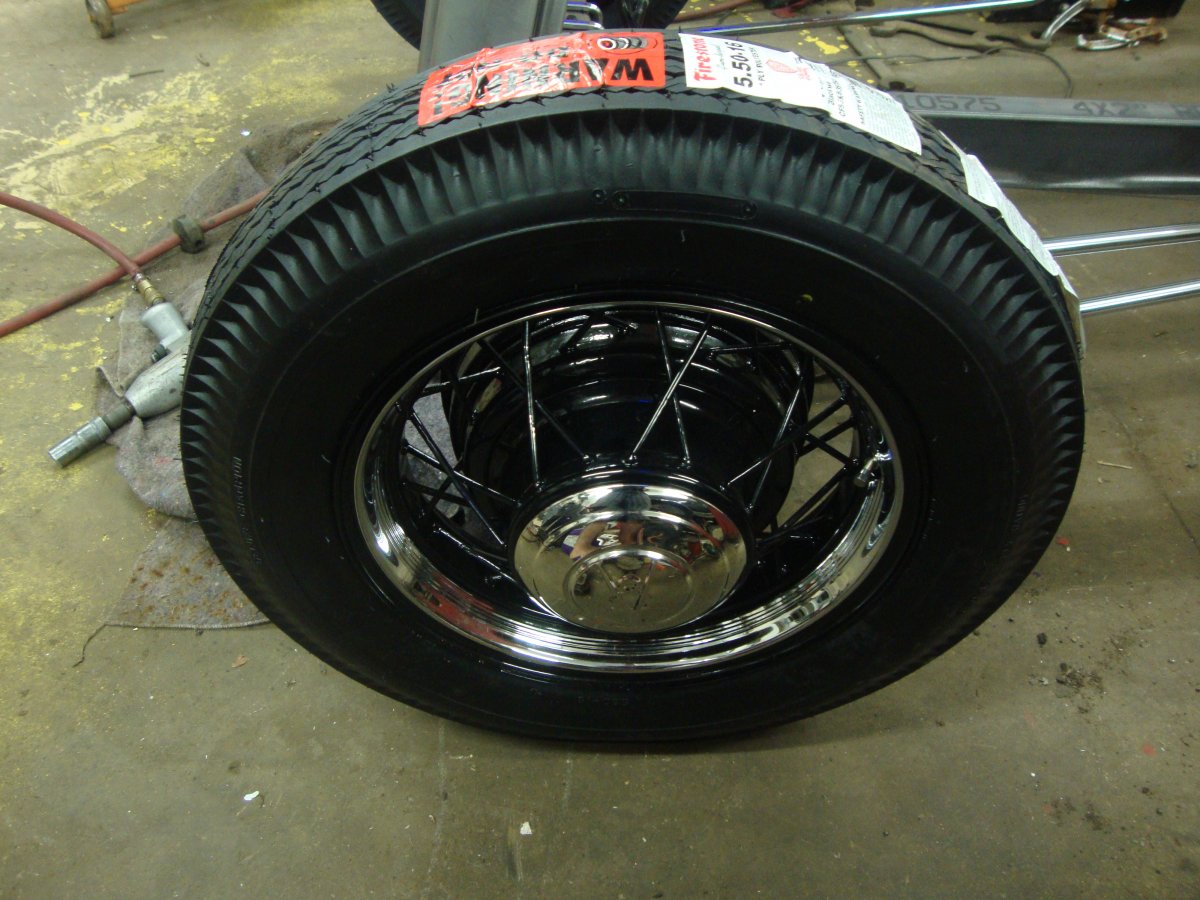

    my 35 wires recess in the center. I will try to get a picture
  8. Genes12320
    Joined: Dec 1, 2007
    Posts: 97
    Genes12320

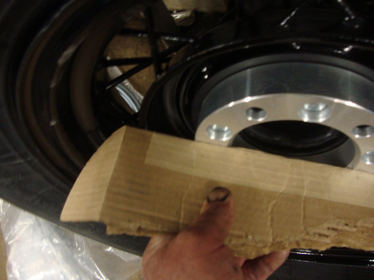

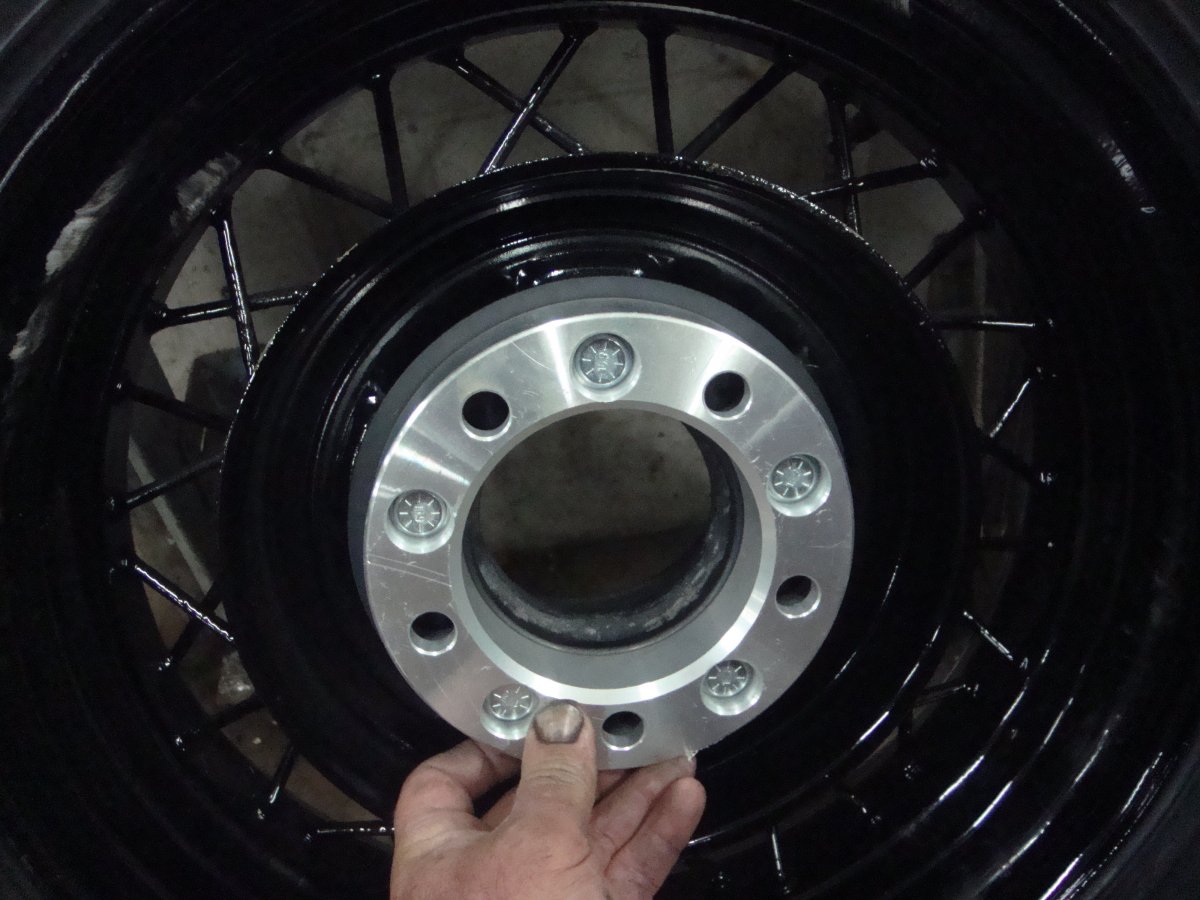

    That is awesome!!!! Thanks so much for posting the photos! Now I get it I think. The two points are the inner flange and lug mounting. The outer does not need to supported. It is the lug mounting being recessed that is the real problem needing the wide spacer. The drum setback on the stock, 40 type and Lincoln drums allows the wheel to clear the drum without spacers. Will save a little on adapters anyway!!!
    So I just need to find some 8" X 4" brakes that will fit inside the wheels... OK maybe not...
    Genes12320 likes this.
  12. Genes12320
    Joined: Dec 1, 2007
    Posts: 97
    Genes12320
    Yes The outer flange ends up close to the drum and hides everything. I used the lugs with the bigger seat to add some support.

    Using a Speedway adaptor( Wheel support) to put 1935 wires on early ford brakes (1940-1946) . Does the flange on the adaptor go to the outside or inside ?
  26. Andy
    Joined: Nov 17, 2002
    Posts: 5,350
    Andy
    The raised ring goes outside so it can fit in the recessed part of the wheel.
