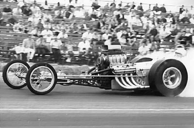

    This is gonna be so cool. I never noticed Roger just how narrow that front end was till I saw a head on pic! Lippy

  7. riceman
    Joined: Oct 8, 2006
    Posts: 743
    riceman
    I have traced the original dragster to it's sixth owner with confirmation that it was the car. The 7th owner's son as not returned my calls since he has passed away.
    Here is a dragster that has been raced up till early 2000, lengthen 3 times and who knows what other changes has been made or what is left of the original car.
    I made the decision to replicate this Top Fueler, not duplicated as a exact copy using the era correct parts. The BUDGET controls this too.

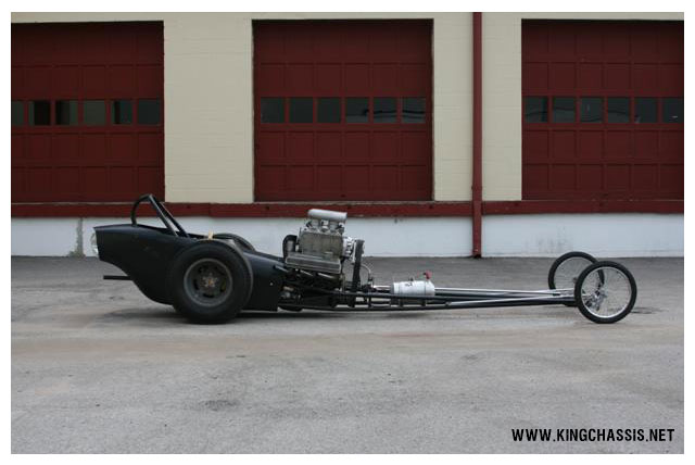

    Roger- are you going to make the body out of aluminum or glass? That's one of the prettiest tail sections ever... looking forward to following the build.
  26. riceman
    Joined: Oct 8, 2006
    Posts: 743
    riceman
    The body will be a combination, fiberglass tail, aluminum sidepanels , bellypan and cowl. The Tail section lines are so close to what is needed. Thanks to Brian Fox, King Chassis.
