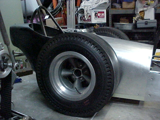

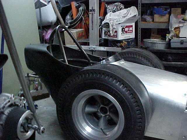

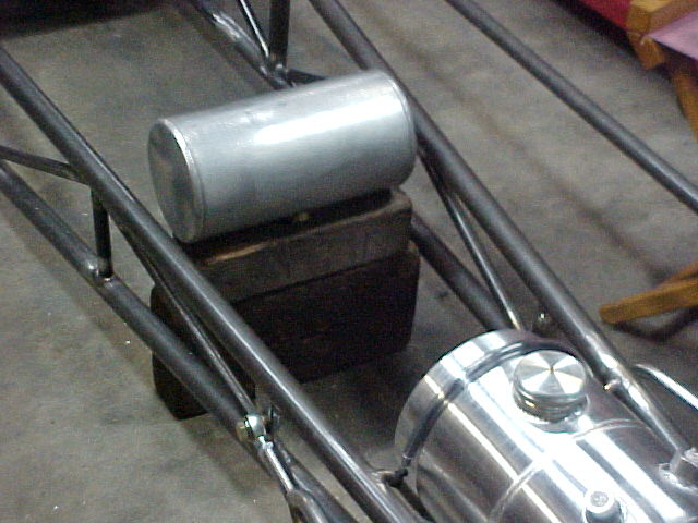

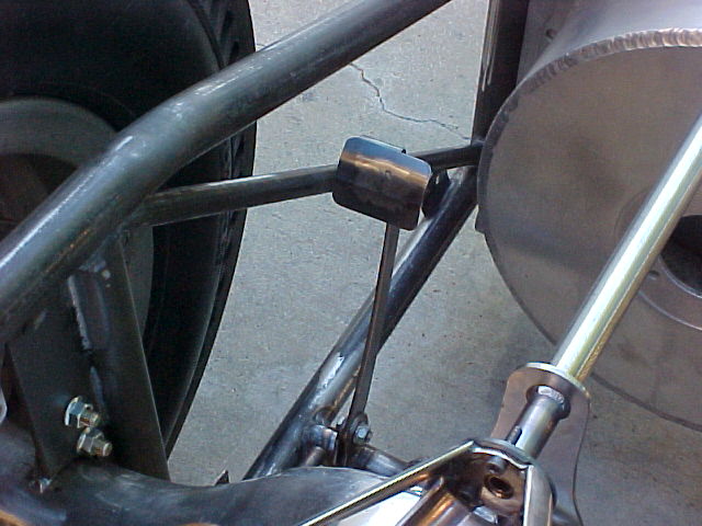

    Here's some kodaks to review....

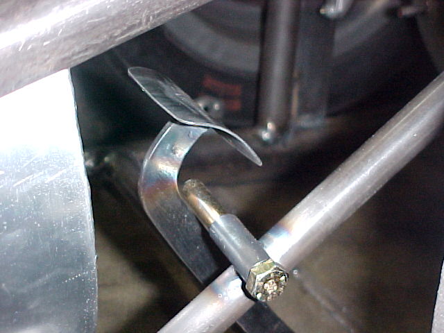

    Fuel Tank is in with proper spring straps!

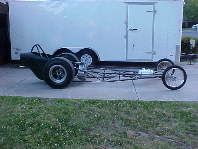

    Front wheels are on and look just perfect!

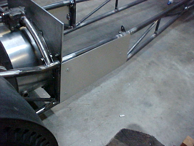

    Back half is complete and ready for Dzus Tabs.... Lots of them....
    RiceMan tries it out and get's fitted for the LOUD PEDAL!!!
    One little, Two Little, Three little Dzus tabs....
    28 Dzus tabs later it's time for the rear wheels....
    Then it's time for HEMI shit and a look at the overall project!
    And the MAD FABRICATORS....... Dr. Lee and Grasshopper.... Happy as can be!
    Good times..... What a great project!

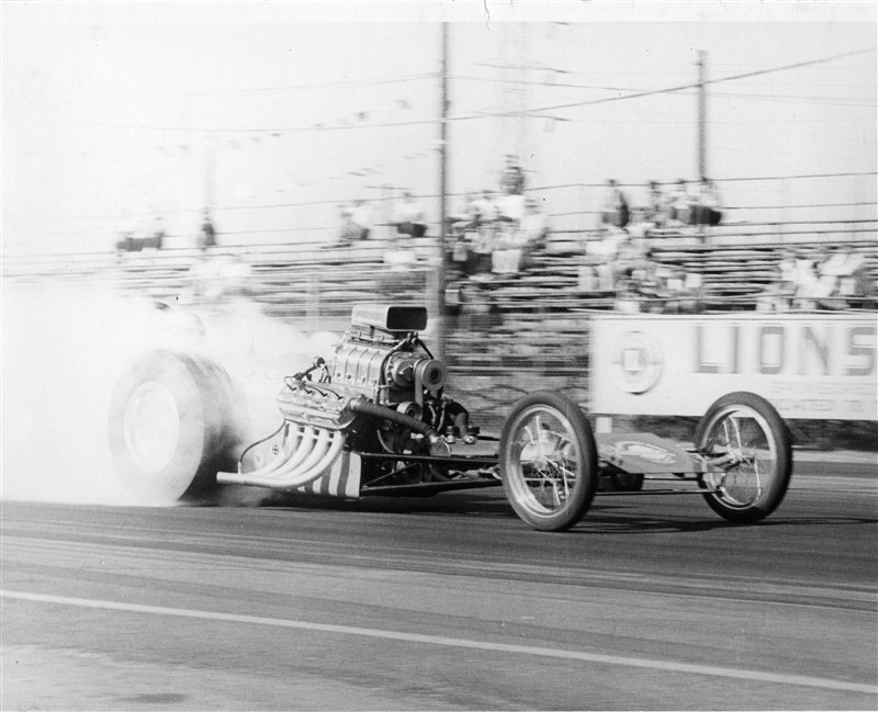

  3. I remember this iconic bad ass in the day, it was awe inspiring. The avatar picture is typical of how this car looked in action, a ball of fire smokin thru the 1/4. This is a cool deal, two is better than one, in most cases!! ~sololobo~

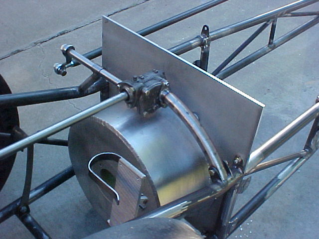

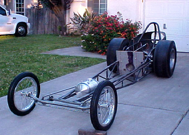

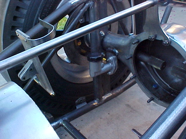

    The chassis is a Roller. Std 1320 member , Robbie Morris III did a fine Tig welding job, and we both learned alot. Next up at Robbie's is the start of the Beebe Bros. & Sixt Fueler.
    Next up on my "To Do List' is to get the brake system done and working.

    I am trying to keep the build as correct as possible with keeping in mind that UPDATEs were done like dics brakes instead instead of drum brakes which Kent Fuller said he changed on the car sometime in 1964. Thanks for your comments.

    Now comes what is call the 10,000 5 Minute Jobs List that always takes longer. these are checked off.
    1) Fittings for the Moon Fuel Tank
    2,3) Make and form the Hard Brake Lines, flare the lines for fittings.
    4,5,6) Make the Two Side Panels under the motor, and mount them with Dzus Fasteners

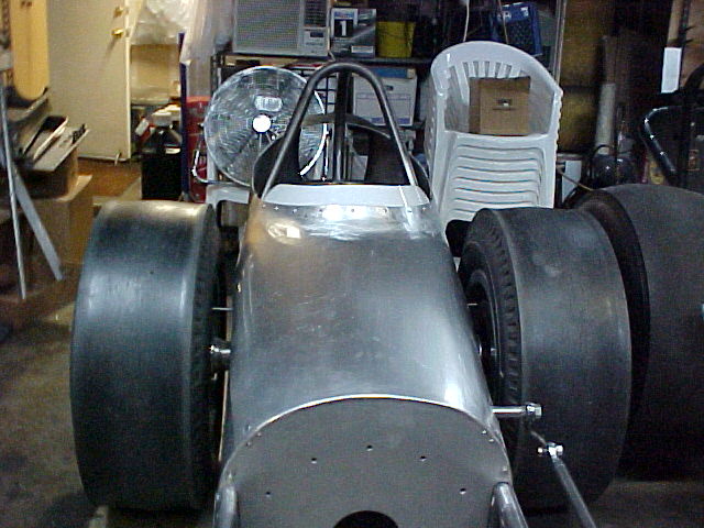

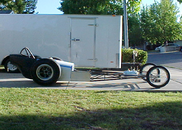

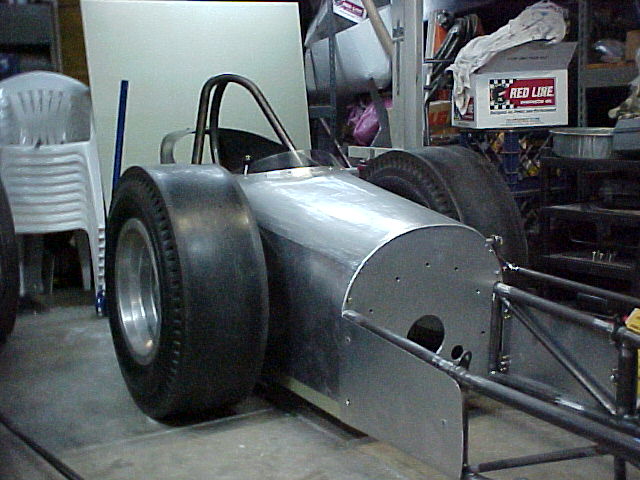

    Well I have been at it hard and I would have the side panels and cowl done, but 'OUT OF STOCK' on aluminum sheet. Poster board patterns were made. Cut & fit, Cut & fit, Cut & fit, Cut & fit, etc. 12 hrs of this.
    I trimmed the Motorplate and I went to use my belt sander and that broke a rod. I hand filed all the cut edges smooth and radius the top.
    The first picture I removed the tape lines with some computor magic and radius was added to the windscreen base. I also change the brake lines, mucho bettero, but my camera ran out of battery so no picture. <META content=on http-equiv=x-dns-prefetch-control>

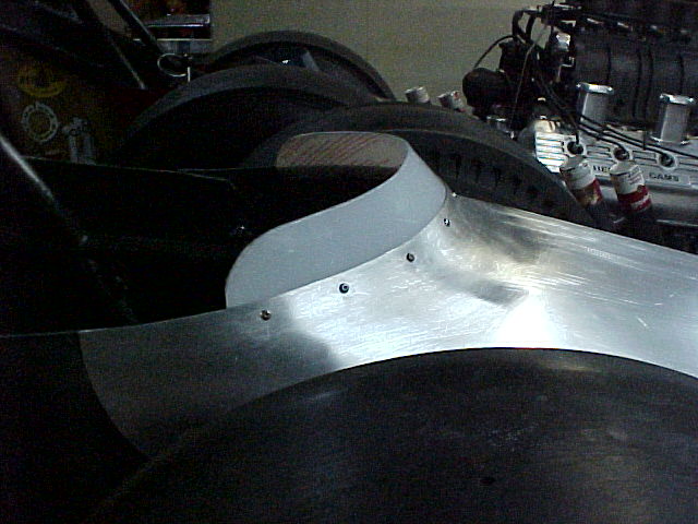

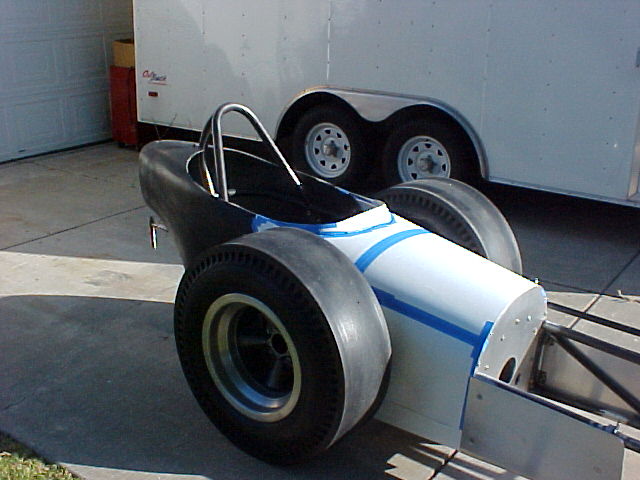

    The aluminum body is roughed out. Some fine tuning and it is there. Add the windscreen and then the seat has to be made. I bleed on it, worked up a good sweat hammering out the cowl windscreen lip, but I'll survive.
    The windscreen edge radius was slap hammered over a 10 dia. x 3/8 thick x 4 ft. cardbord shipping tube and sand mallet. The cowl shaping was also done with this BIG tube. The body material is .050'' 3003-H14 aluminum sheet and is known for it's formability. Love it.
    After yesterdays action pack metal forming, I took it it easy, but still made a mess. I cleaned up the hi/lo spots on the windscreen radius with my senior hammering knowledge. Fingers or bandaids not included. I also trimmed the lip that goes over the motorplate and formed ( HAMMER AGAIN ) it over the edge to seal the driver's compartment. A good tight fit and no gaps.
    I made the Windscreen pattern today. Stainless steel 10-32 button head Allen screws and 1/2 height nyloc nuts will secure it inplace. The final shape is done and will be made from 1/8 Clear Plexiglass. Maybe a red plexiglass one too for fun. What do you think with a Yellow body, Howard decals and a clear red windscreen ? MMMMMMM?

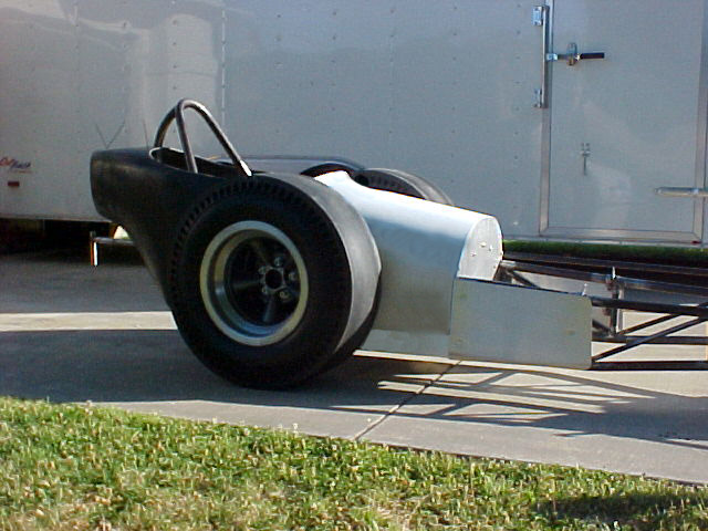

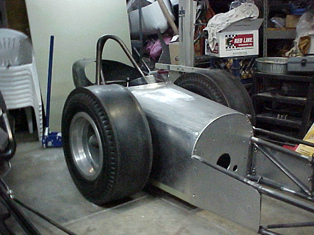

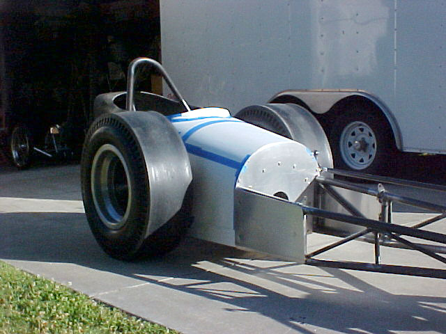

    1) Installed the breather tubes in the Blowby Tank. The Breathers were found at Kragens.
    2) I made the correct shaped Windscreen and mounted it to the cowl.
    3) I removed the rear slicks and drew a line along the bottom edge of the cowl as it sat and removed it. Trimmed 1'' off the front and 2 1/8'' off the rear just to the top of the exsisting Dzus fastener holes.
    4)The side panels had too much overlap under the cowl and was keeping it up too high. I trimmed the side panels down so they would have only 1'' of overlap area.
    5) The Cowl bottom edges had to be recontoured and clamped in position. The cowl now sits 2'' lower at the back and the height looks alot better. I drilled and formed the Dzus button holes. I bolted the cowl in place with 3/8 countersunk Allen bolts and wing nuts for fast removal at the rear.
    6) The front Dzus button holes, steering cross shaft cutout and motorplate lip of the cowl had to be adjusted for fit. The bottom edge overlap fits tight now.
    7) The tail section top edge contour now had to match the rear cowl top edge and flow altogether. I taped off a cut line on both side and cut off the uneeded material. A little cleanup filing and done.
    8) Going by the reference pictures I used, the results look good. As in modeling, each part that reflects an object and assembly has to be correct or the final results will not have the RIGHT LOOK.
