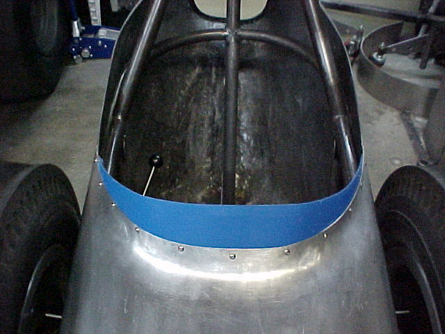

    The first things people see are the pleasing shapes and lines of a Kent Fuller Racecar. The cowl and windscreen has to fit the flowing shape of the body. From preivous emails you have seen me sneak up on this shape.
    6 windscreens are in the garbage, but this last one maybe the winner. I keep looking at it from different angles and have shaved off some heights and curved the edges.

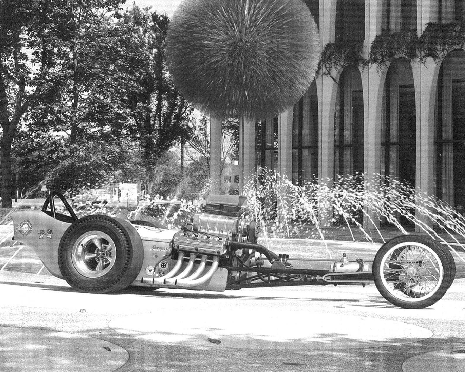

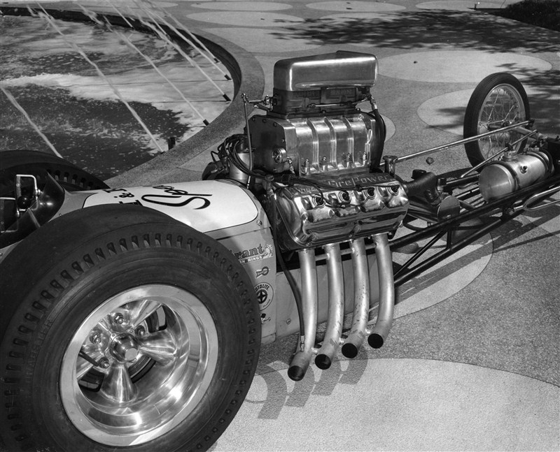

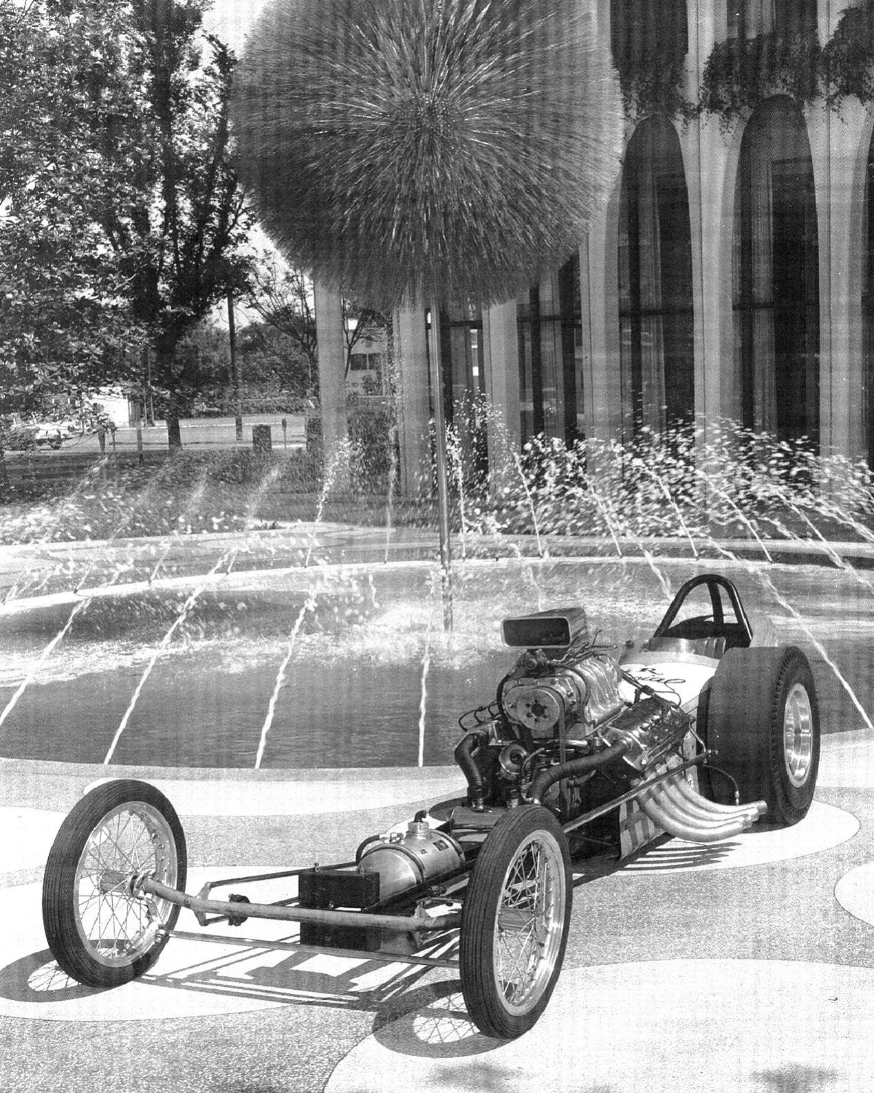

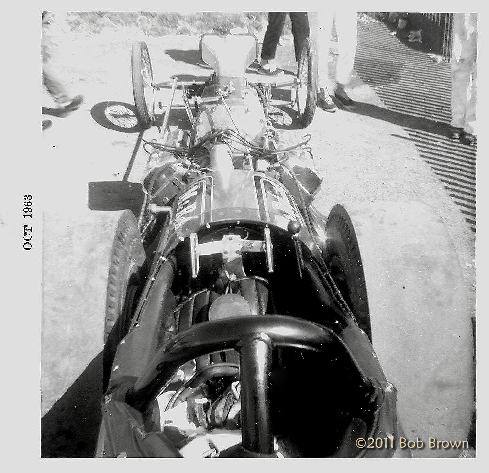

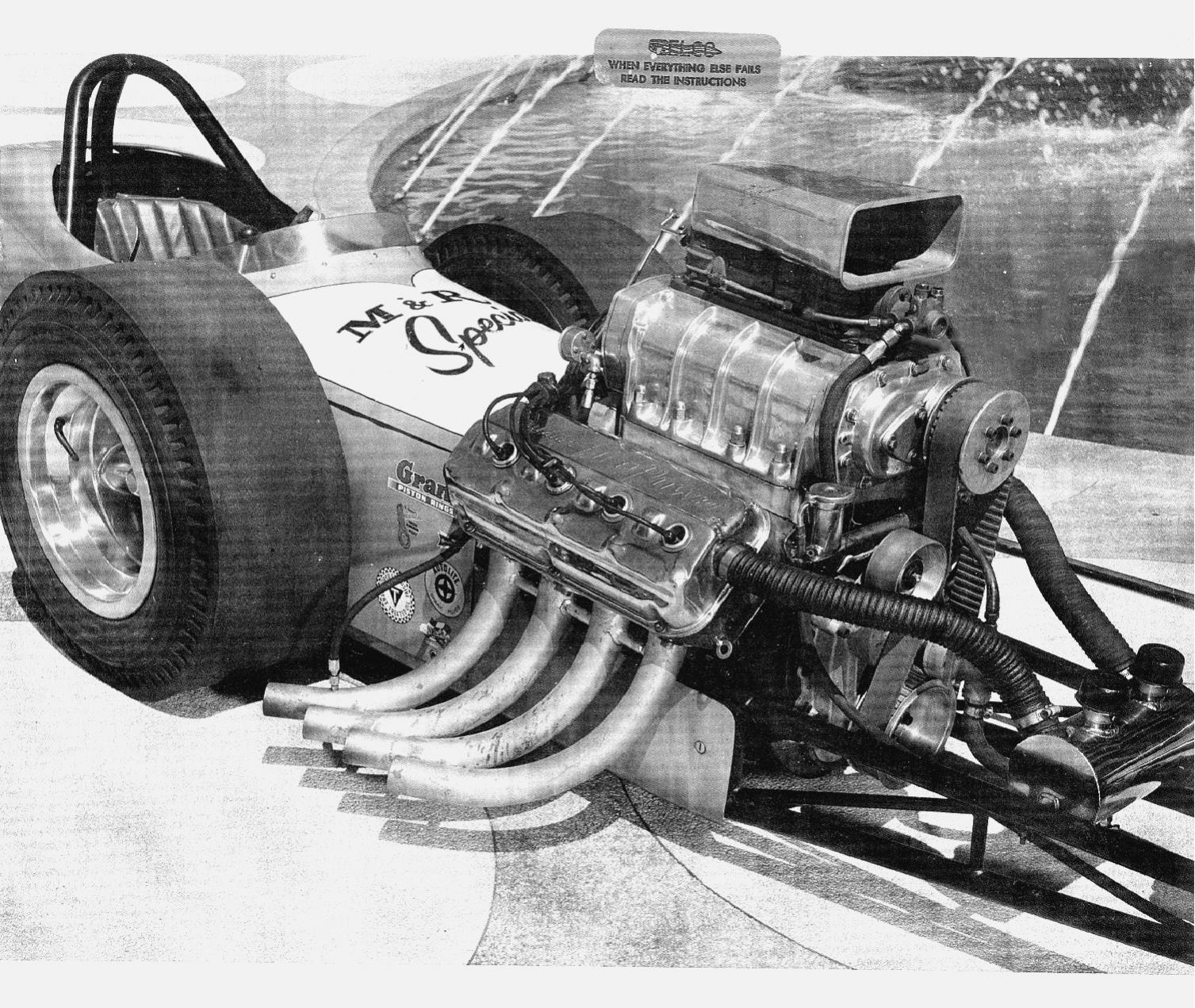

    Here are some Kay Trapp pictures that never made it in the Hot Rod Magazine article Jan 1964 issue and a few that were published. These came from Lefty Hay, # 1 crewmen for Masters & Richter.

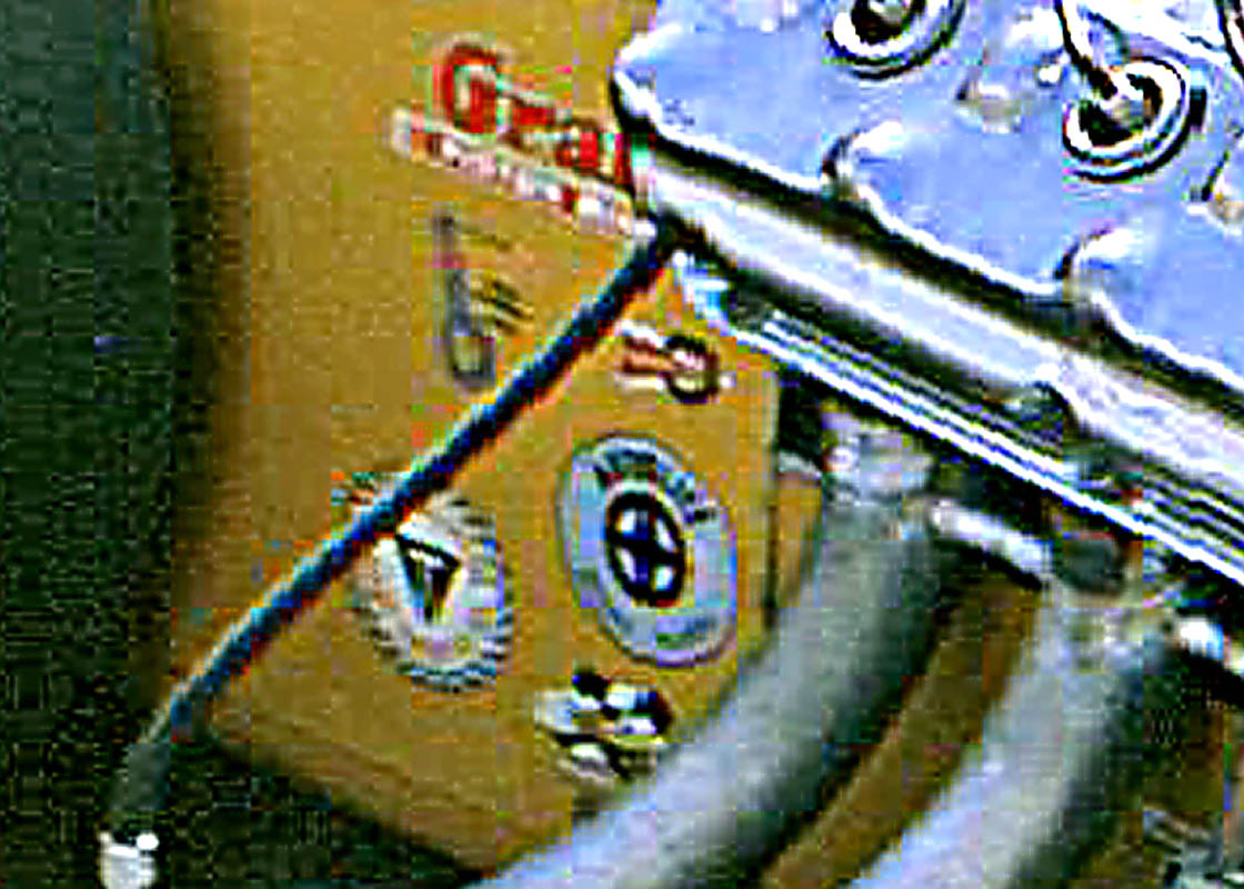

    This week I spent alot of time on photoshop, 4 ink cartridges, paper and photopaper to reproduce the right Mfg and sizes of decals for the M & R Special.
    Thanks to the Wavemaker for the Howard Rod decals, lots of magazines, internet and reference pictures on hand, all the Masters for the decals are now finished for the M & R Special.
    Rare early 1960s Torco Oil and the Howard Twin Bear decals were from B & W pictures from Kay Trapp. Photopaper copies were test fitted for size and double taped on.

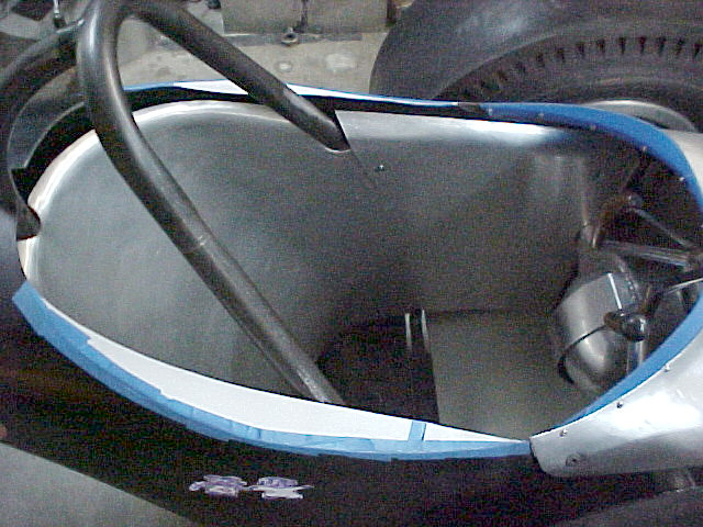

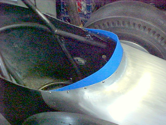

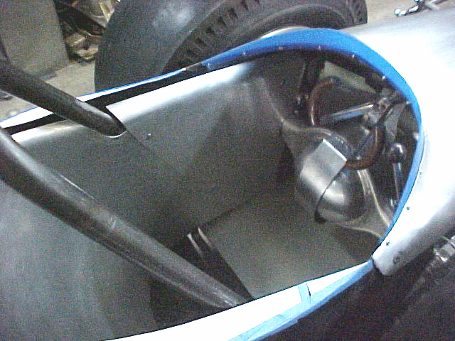

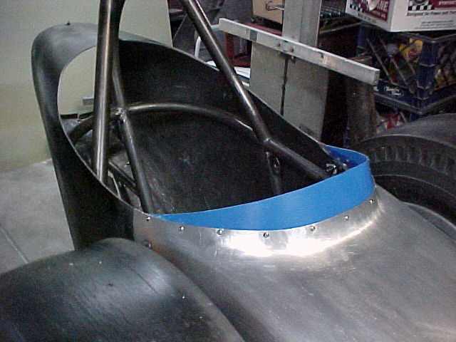

    After Brian Fox lit a fire under my ass, I got after the starting of the seat. The posterboard pattern was adjusted during last week and was ready to copy it in .050 3003 H14 aluminum.
    This aluminum grade forms great and will stretch as you have seen with the cowl. Slapping with a 2'' sand mallet over a tube forms a smooth arc. I used a heavy wall 10'' shipping cardboard tube to form the main radius of the seat back.
    You have to take your time to do this to match the radius of the inside edges of the chassis seat area. The seat back form was in & out many times. A few belly rolls over that big tube worked fine. LOL
    The mounting with Dzus fastener button were done next. Once in there, minor trimming was needed. I removed it and slap formed the upper radius along the top edge using a 3'' steel tube and the sand mallet. The interior snaps will attach on this radius. 6 hours of work , but came out bitchin.
    I cleaned up all the edges and radiused the corners for a nice finished look. The side panel extensions to the back of the rearaxle are next.
