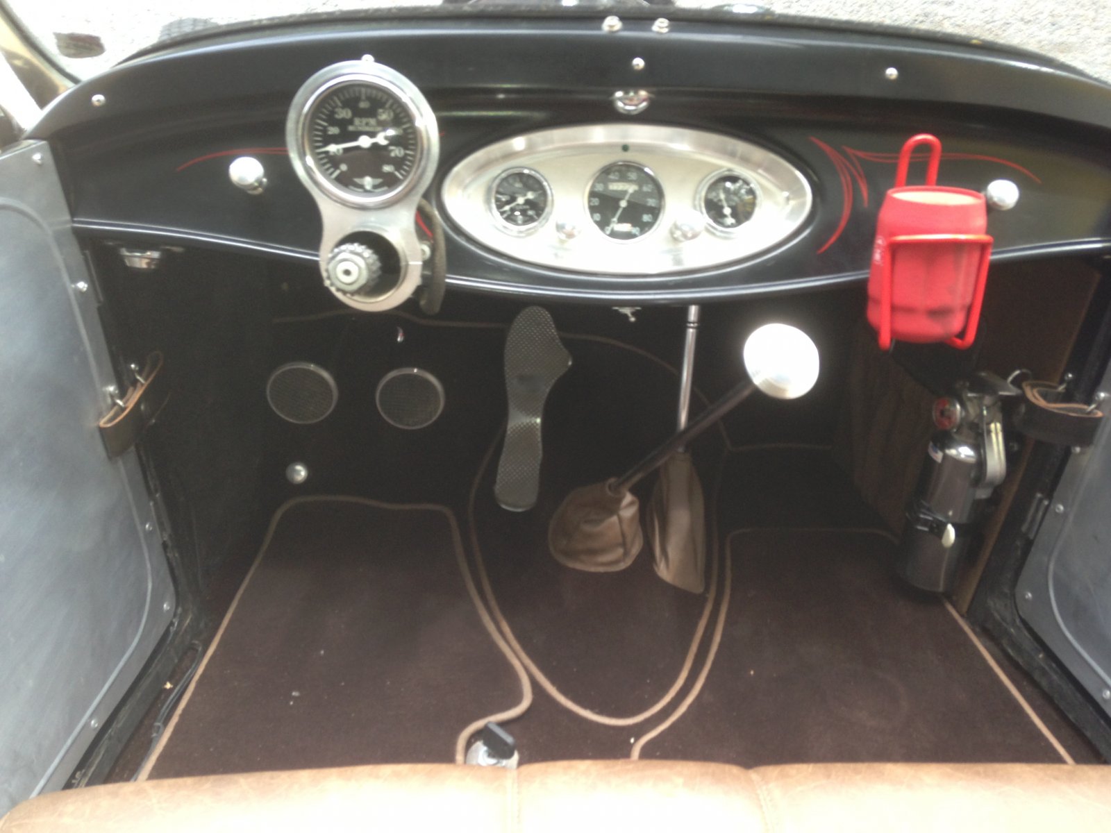

    These two items are pretty much all that's needed nowadays. :p
