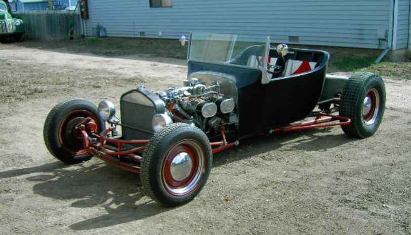

    Hard to see the front plate, best picture I have.

    With the spring on top of the mount did you realize any difference in handling?

  7. OFT
    Joined: Jun 1, 2005
    Posts: 579
    OFT
    Not really as it was set up that way when I built it for lowness. It had 4.10 gears with a 5 speed that was non overdrive. Handled like it was on rails:). Blast to drive with the 153" Chevy II motor.
    It handled lots better than "fad T" I had in 80's (sold in the late 80's).
