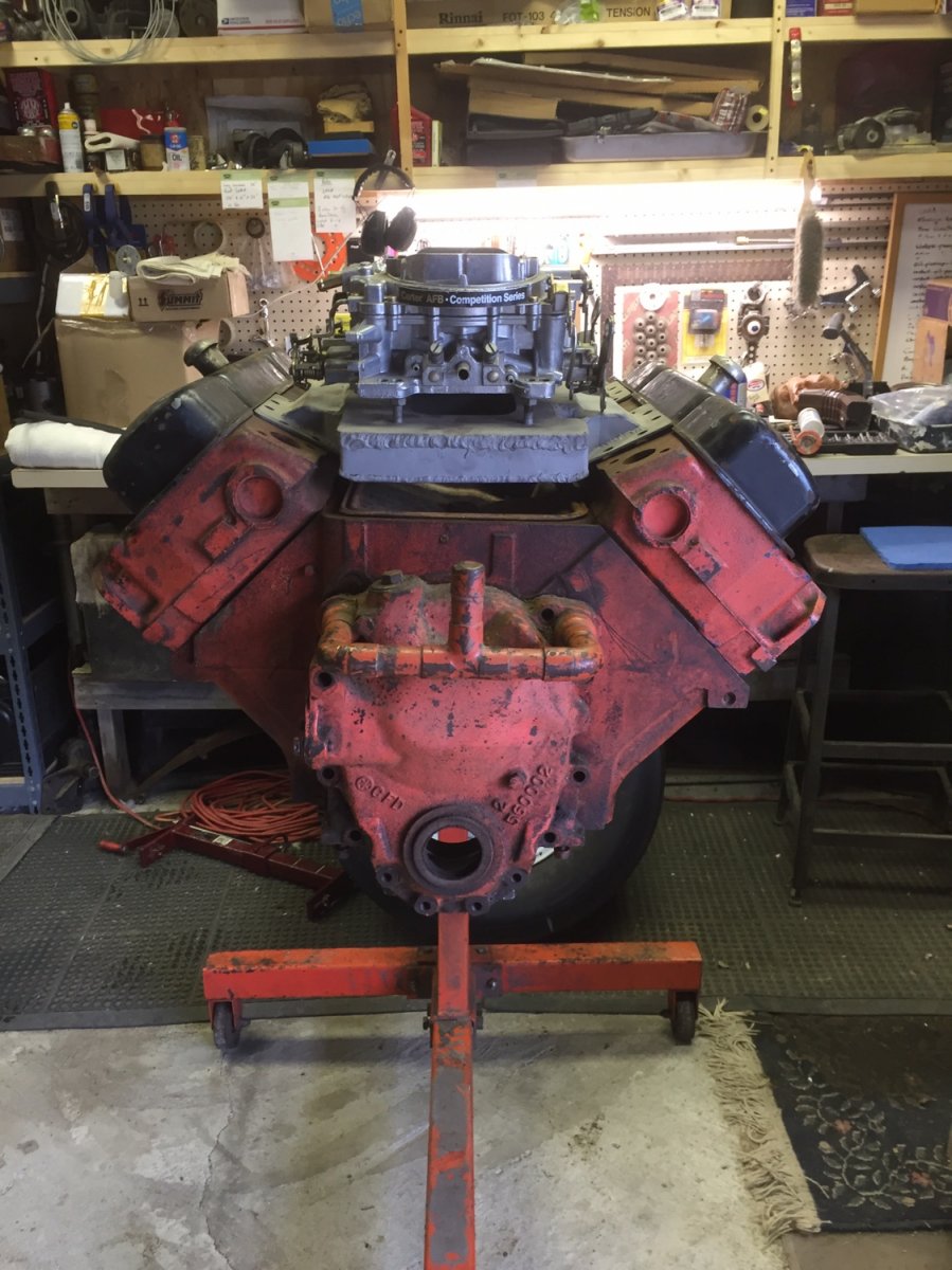

    on
    Lol. I'm such a ****. I had to go back and look at this. First time through I thought it was a piece of cinder block sitting there for mock up purposes.
