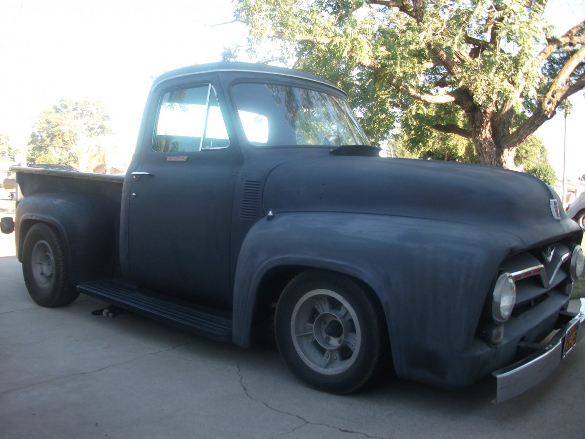

    Yeah, Raven...Just make sure of plenty of 'surface' where mounting to the 'plate' These gl*** bodies spiderweb, crack, and tear from just regular driving.
    I'm sure you have it planned...
    I have a pic in hand, a photo, 3-1/4" X 4-1/2". Only pic I was ever successful posting on the HAMB was my avatar, and that's the Romeo Palemides 2-piece wheel on the r.f. of my F100! - and my Wife posted it!

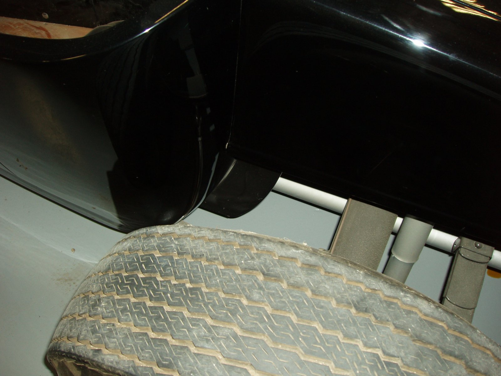

  9. loudbang
    Posts: 40,346
    Here is your photo :)

    Sorry to hijack - Mike, I've never seen these wheels before, very cool! Are they actually two-piece cast mag or aluminum?
    Steve
