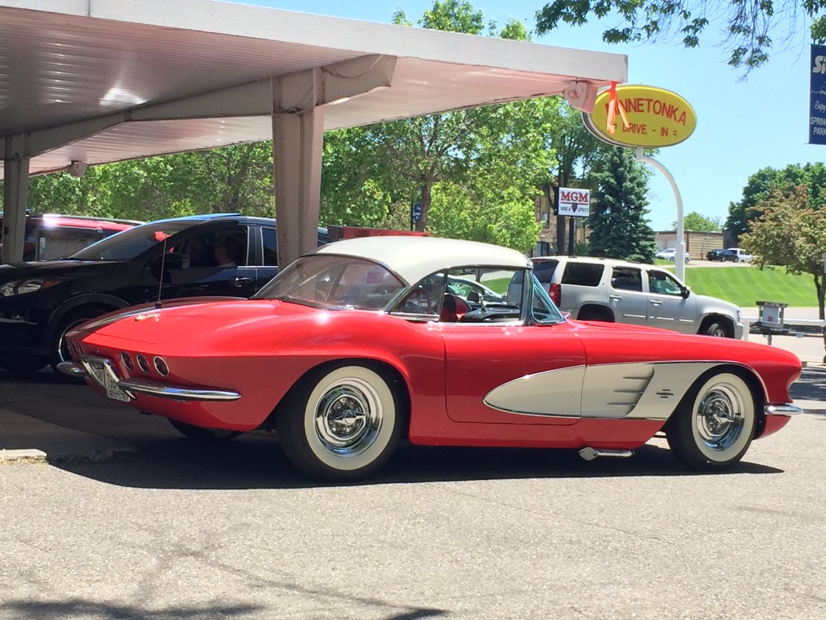

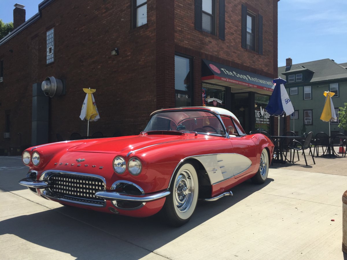

    I’d forgotten about this thread. Since I’m here, here’s how my kickstand lake pipes turned out.

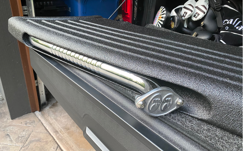

    64724AF3-FABB-424D-9D0A-D995CCC56FAA.jpeg D44B5386-D36E-493E-9324-41E21BFA0DE2.jpeg 18676A20-E1FC-45E3-B198-910A2B59DA80.jpeg

  14. Bandit Billy
    Joined: Sep 16, 2014
    Posts: 16,481
    Bandit Billy
    rippled jiffy stands, inset a bit to aid ground clearance.

  16. Nailhead Jason
    Joined: Sep 18, 2012
    Posts: 4,521
    Nailhead Jason
    The inset is super nice! Don’t have an extra set laying around do you?

  17. Moriarity
    Joined: Apr 11, 2001
    Posts: 39,230
    Moriarity
    SUPER MODERATOR
    haha, he bought those from me.....

  19. Nailhead Jason
    Posts: 4,521
    Nailhead Jason
    guessing you don’t have any more in stock do you??

  20. Moriarity
    Posts: 39,230
    Moriarity
    SUPER MODERATOR
    nope, they do show up on ebay occasionally though

  25. Bandit Billy
    Posts: 16,481
    Bandit Billy
    Bought those I did from the Museum Moriarity. Beneficial to know those in high places it is.

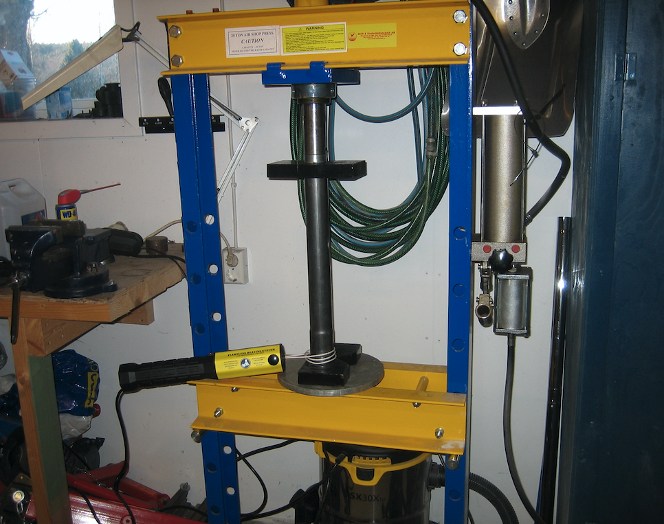

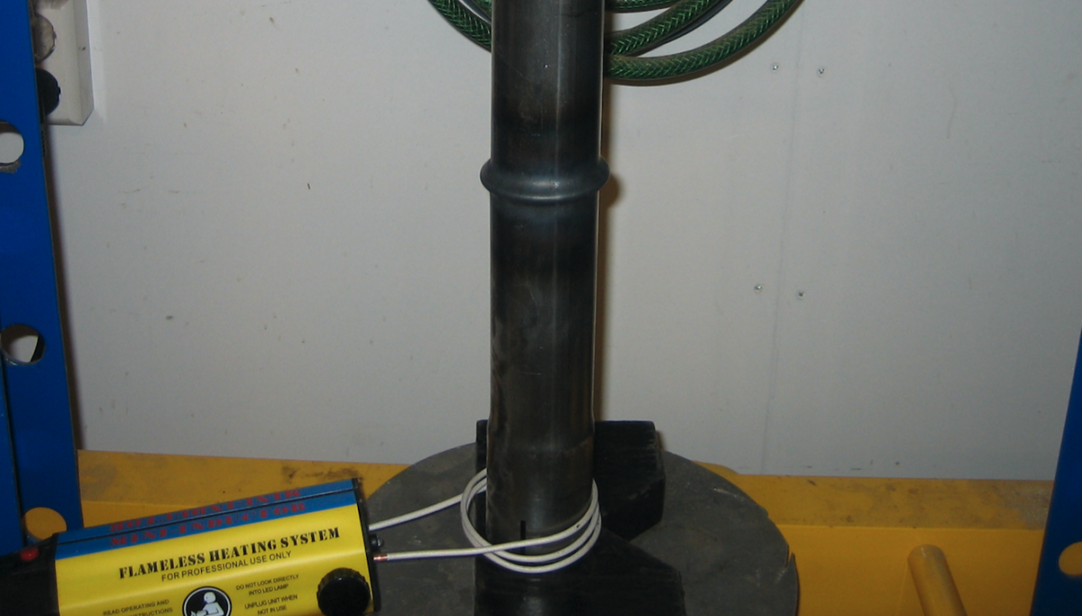

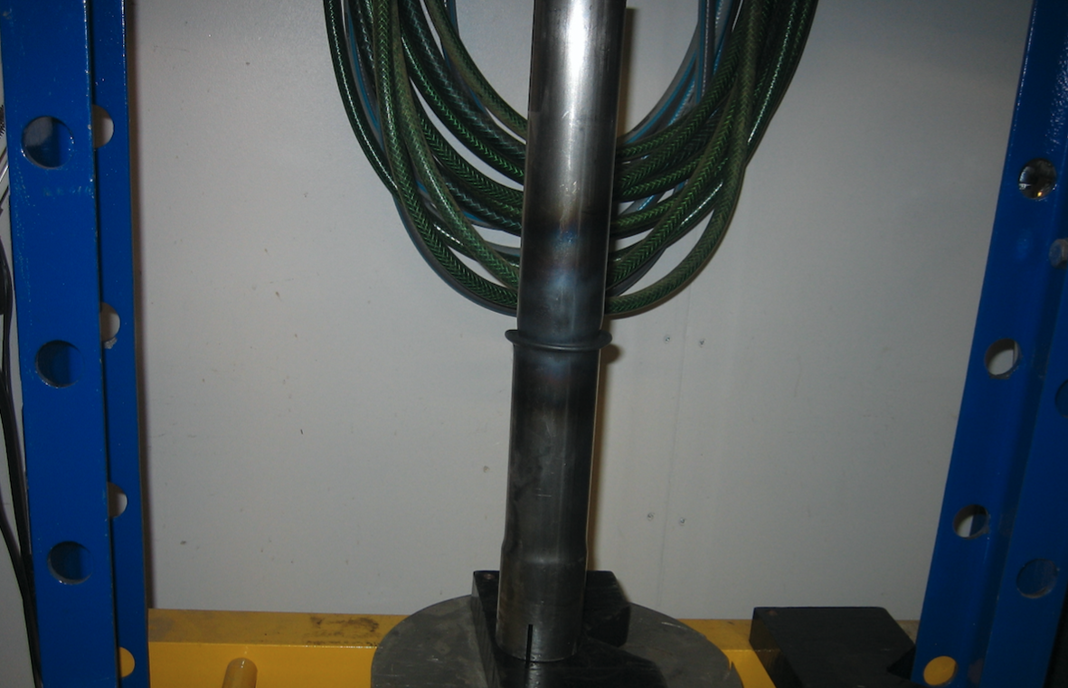

    I also had an idea,,,,,did not go well.
    The first ripple went well.Warmed up an inch above the first,but when i
    pressed, the first ripple collapsed.Hope your idea is better Skärmavbild 2020-11-20 kl. 13.58.43.png Skärmavbild 2020-11-20 kl. 13.57.50.png Skärmavbild 2020-11-20 kl. 13.58.18.png

    my idea is to fill the pipe section with sand, measure the spacing of the ripples and using a clamping device to press the ripples into the pipe.

  28. I think you are on to something. My thought is instead of pressing you ROLL them in. The sand should act as a soft mandrel.

    I'm thinking the same thing, a dull pizza cutter sort of thing in a lathe.....
  30. or turn some dies for your english wheel
