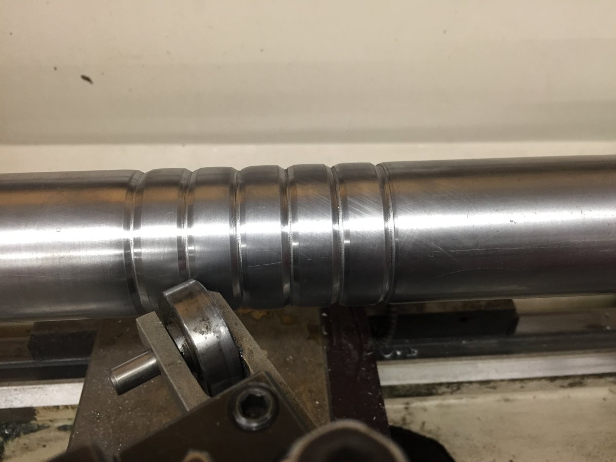

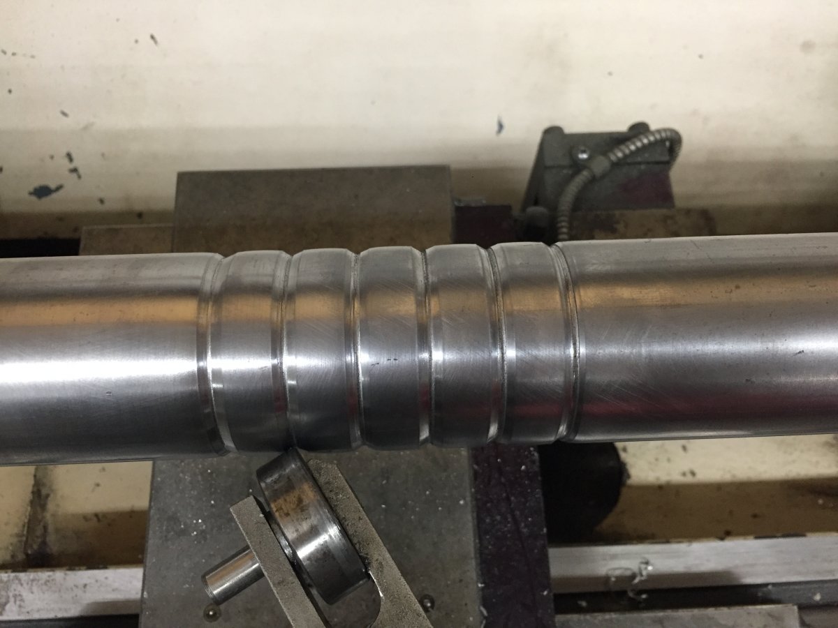

    ok, I made a little tool for the lathe and put a bearing in it because everything else I tried was too soft, I ran the corner of the bearing into the pipe at low speed and I did not fill the pipe with anything or use a mandrel. other than my eyeball spacing I think it looks pretty legit....

    Geez! That worked slick!

    That's pretty slick. Great idea. How does it work when you get farther away from the chuck? I can see it getting harder to maintain uniformity the farther down the tube you go.

    I made a bushing for the other end so I can support it with a live center. I think that for the most part these never were very long. Maybe a foot or so....

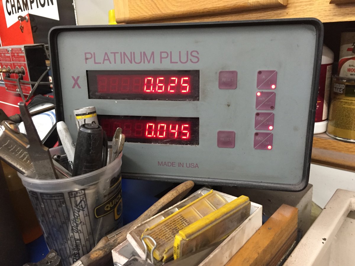

    Ok, I made some more of these at .625 It doesn't look exactly the same to me but
    I kinda polished it with some scotchbrite and it kinda looks ok??
