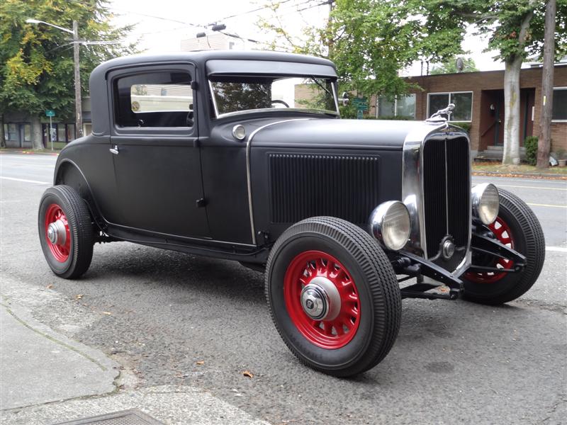

    since the original idea, when i bought it, was to make a hot rod, i decided that the fenders had to go. the wheels are '33 buick, same bolt circle. stock '31 flathead six and 3 speed, but i have a '54 331 hemi that runs well sitting in the shop that may need to be installed this winter. kind of fun the way it is though. it keeps up with traffic fine.

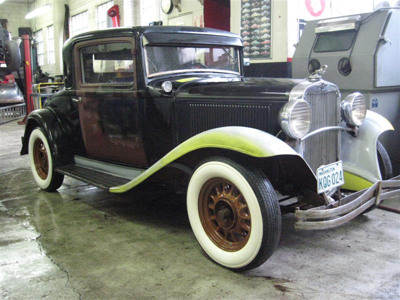

  10. Looks great! Did you "unshiny" the paint?

    I dug the whitewalls and fenders.. but what do i know.. im a custom freak :p

    It's pretty wild how much a difference that fenders make. It's like a completely different car.

  23. looks like 2 different cars, are you going to change the rear for the hemi, what axle are you going to use? How about the steering setup,the Hemi will be in the way of the gearbox won't it?
    BTW that hotrod looks nice.

    i would like it a bit lower, so even though i kind of like the parallel front springs, a 4" dropped axle and transverse spring is probably in the cards. no way to lower the front with the current setup. not enough room between axle and frame.an 8 or 9" rear end most likely. the steering box is definitely in the way. something smaller like a VW bus might work. i just saw an ad for patriot hemi headers in the last street rodder mag. anyone used them?

    i had two 31 chryslers , they're nice cars ! i think of the weight of the hemi would get that front end down .i flipped the tube axle on my 33 plymouth and it looks like i have enough room inbetween the bottom of the frame and the top of the axle , with the desoto hemi in place !
