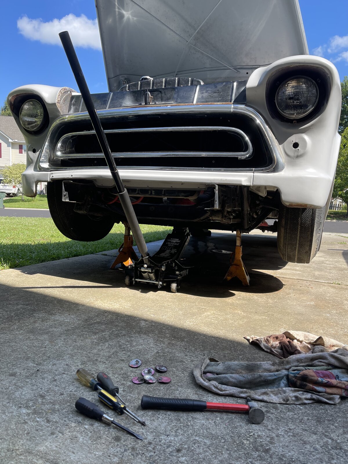

    So I had a bit of free time today. I jacked the truck up to get a good gander at the shifter cable and linkage. Nothing really stood out as a problem. I kind of tugged on it gently to see if anything was loose. Nothing there. So I cranked it up and was able to put it in gear and drive around my neighborhood. Upshift was fine, downshift was fine. Reverse was fine. Low gear was fine. I don’t know, I’m kind of shaking my head, but not questioning a good thing for now. I’ll post a video later tonight.
    Still need to address the leaking freeze plug before I get into some actual road testing to see if the trans issue was really real or just the truck being sad to be gone and happy to be home? For now, I’m just gonna chalk it up to the magic of the universe and positivity.

    So I have at least three leaking freeze plugs. I have a new replacement set from cad daddy. Might as well change them all if I’m already doing half. That’s next and should have me on the road. Took it around the neighborhood a few more times and did not experience any trans issues.
    Very near future plans after the freeze plugs will be clean the engine bay and tires, pull the seat and clean the interior, and fill some screw holes in the interior. I got a line on a proper bench seat. Then paint, insulation, all new knobs and carpet. Hope to have all this done in the next month or two.

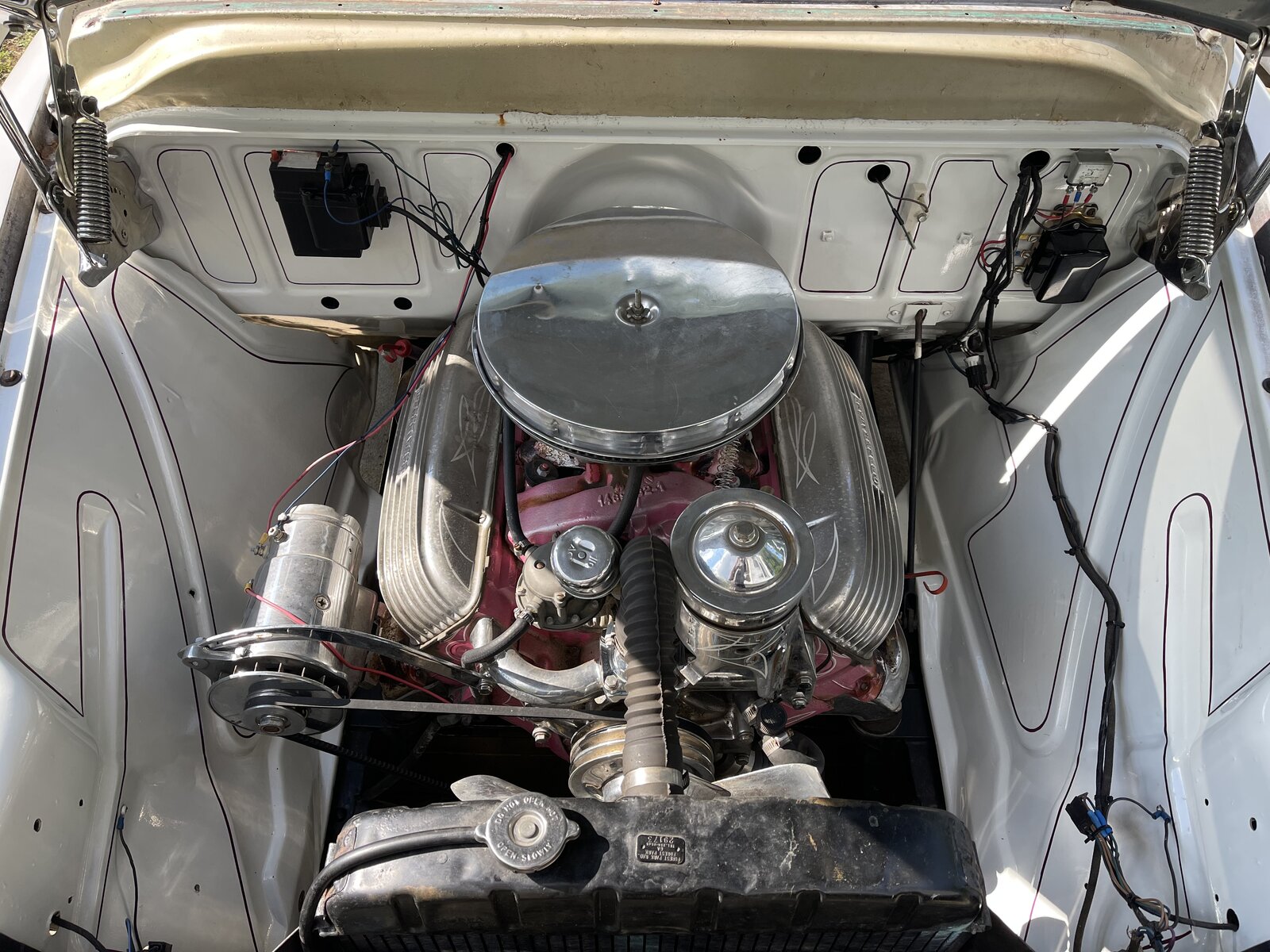

    I got the freeze plugs out, back flushed the block, and put new freeze plugs back in with no issues other than getting dirty. I filled the coolant back up and got it warm in the driveway to check for leaks. No water where it shouldn’t be. So I took it out on the road for a rip. So far so good. No leaks. Trans is doing what it should. First real drive for me in six years. First real drive for the truck in six years. Nice.
    Next up on the agenda in the immediate future is more driving around town to check for any bugs, but I don’t think there will be any. Also, the truck is filthy under the hood, under the body, the tires and wheels, all the chrome, and in the cab from sitting for a while. I mean, it’s not filthy, but it is dirty compared to what it was before sitting for so long. So I’ll be cleaning all that up.
    Once I have a fresh pallet to start with, it’ll be on to all new bright interior.
