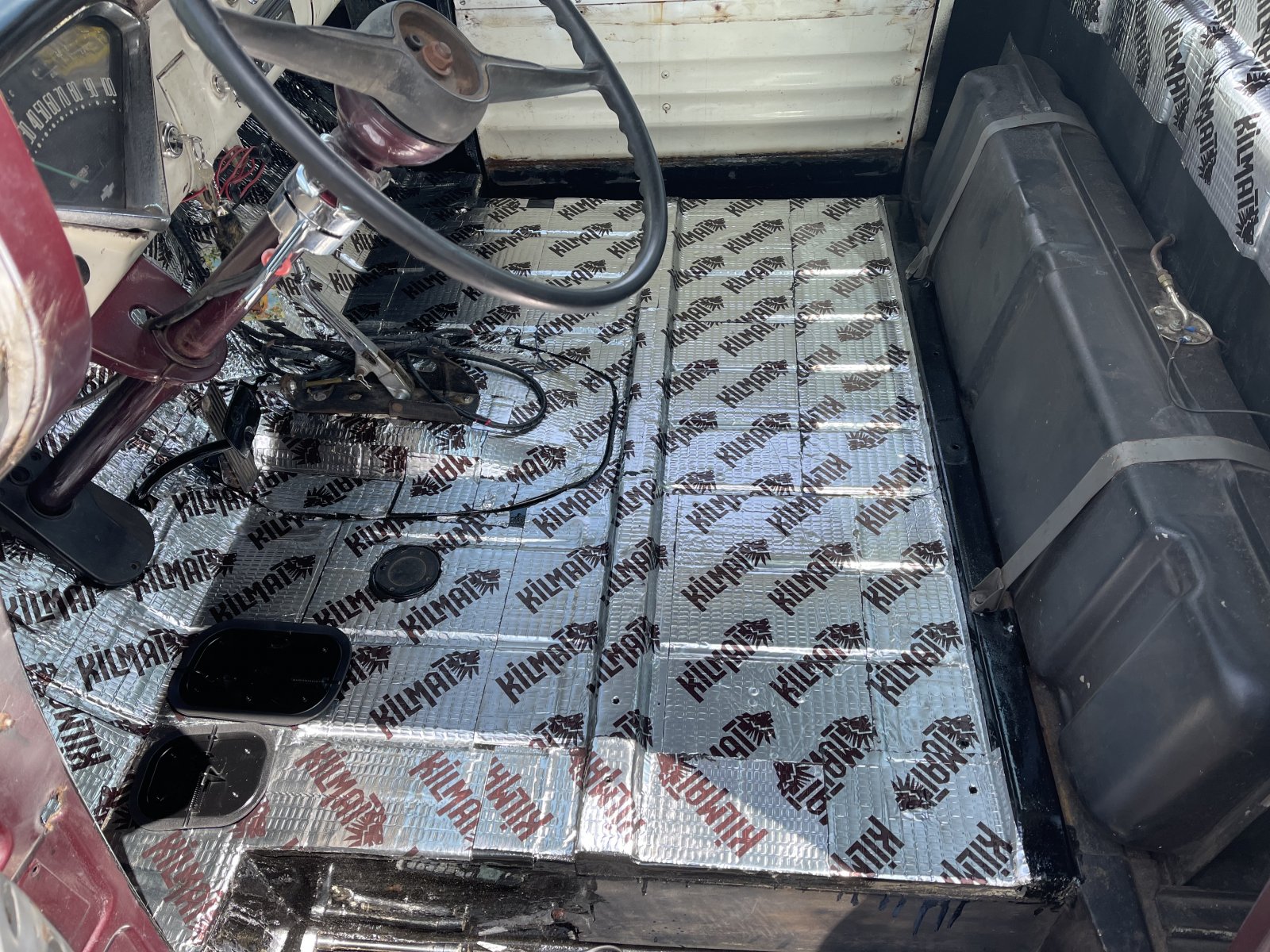

    I’ve put down the Kilmat everywhere I could get to on the floor except under and behind the gas tank. I need to run about a half a tank out before I try to remove the gas tank.
    Until then, next up is putting down Kilmat on the kick panels, installing the new kick panel vent doors (I painted them) and cables, and then laying down the double sided foil bubble wrap insulation. If it doesn’t rain, I’ll try to get all that done tomorrow.

    I can also report that the Kilmat on the floor and firewall has worked out pretty well. The cab feels more “solid” and the noise is reduced. Definitely less tin canny sounding and feeling. I still have a lot of noise in the doors. There is no window run felt, no weatherstripping, no door bumper rubbers, no real vent window rubber left, amd all the latch and window regulator components are slap worn out. I have all new stuff for that but I really want to get the cab and interior in good shape before moving on to the doors. It’s raining all day today so I can’t really get anything done. But I’ll try to get back on it tomorrow.
