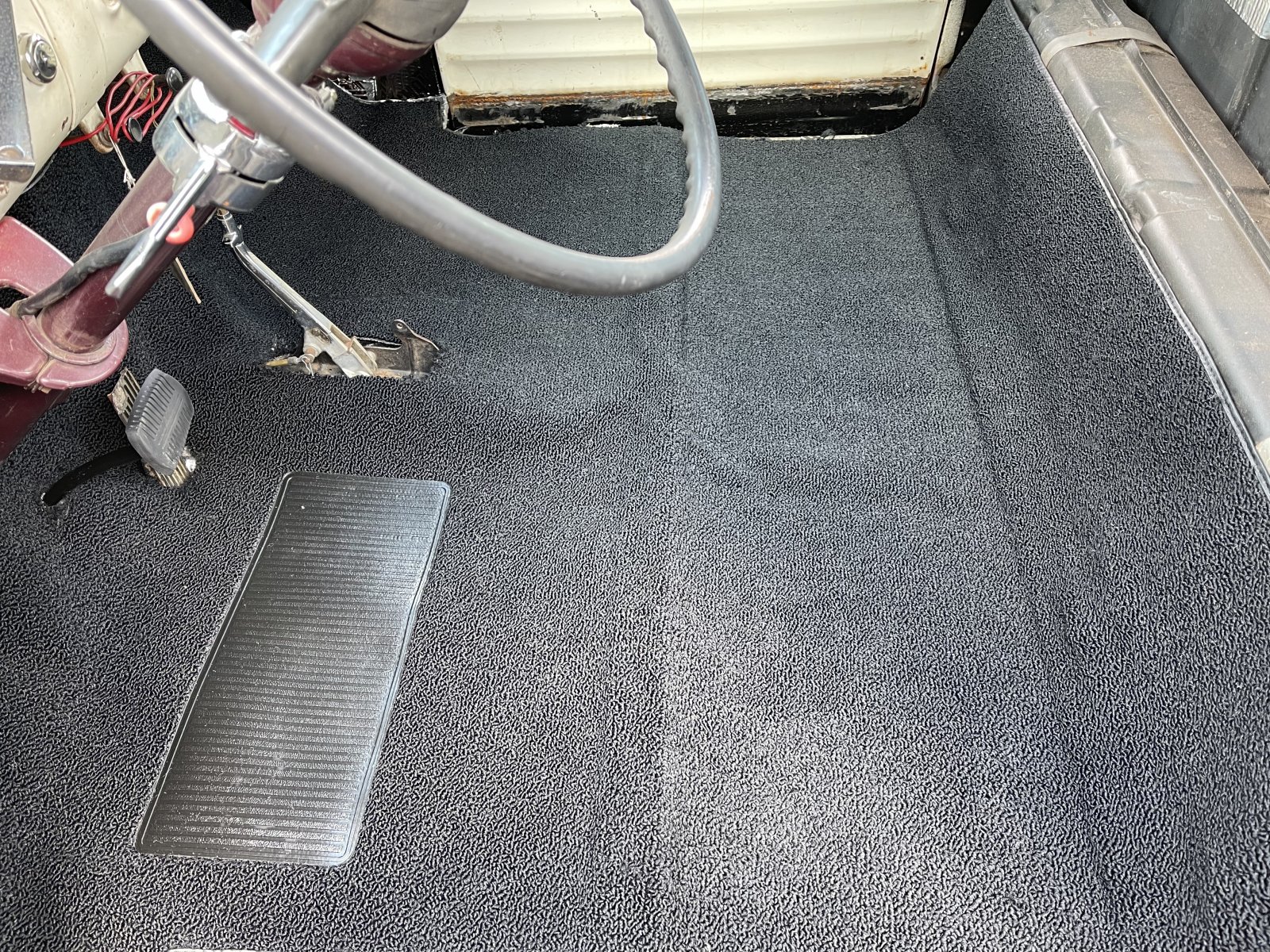

    Carpet is in. It’s pretty much too hot to do anything else. The carpet is from the Truck Shop, made by ACC. The rear part of the carpet sticking up will go under the gas tank whenever I get around to removing it. The carpet looks good in the pic, but it feels cheap. Decent enough for now though. Definitely feels cheaper than the ACC I got from the same place for my old 1983 square body Chevy.
    Still much the same immediate agenda. Remove gas tank for insulation, stereo install, new old seat recover and swap, then paint. Still waiting on in the kick panel vent cables to get here so I can ****on those up too. It’s taking longer than I’d hoped, but I’m getting stuff done pretty much every day so…

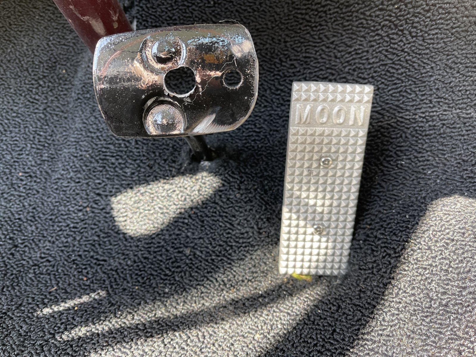

    So, ok, I tried, I really tried today. But it was so brutally hot. I didn’t get everything done I wanted to, but I did manage to get a few small things done. I got rid of the painted rear turn signal brackets and installed chrome. I mounted my license plate in the rear, no more hanging by chains. I installed chrome windshield wiper bullets from where I removed the wipers a long time ago. I got the dashboard smoothed out where I mig welded a patch a long time ago. And I got the Mooneyes gas pedal mounted and the brake pedal halfway mounted. Still need to shape the stock pedal from a rectangle shape to an oval to match the Mooneyes brake pedal. It was just too hot to keep going.
    Vent cables are still in fedex purgatory, hope they come soon so I can ****on up the kick panels. Hope to get the brake pedal finished up tomorrow, I really need to remove the pedal to make it easier, and so I don’t burn up the carpet grinding near it. Also still need the gas tank out soon.
    I think I’m gonna skip installing the black and white tuck n roll on the new old seat and skip directly to stage two full custom interior stuff.

  12. terd ferguson
    Joined: Jun 13, 2008
    Posts: 3,734
    terd ferguson

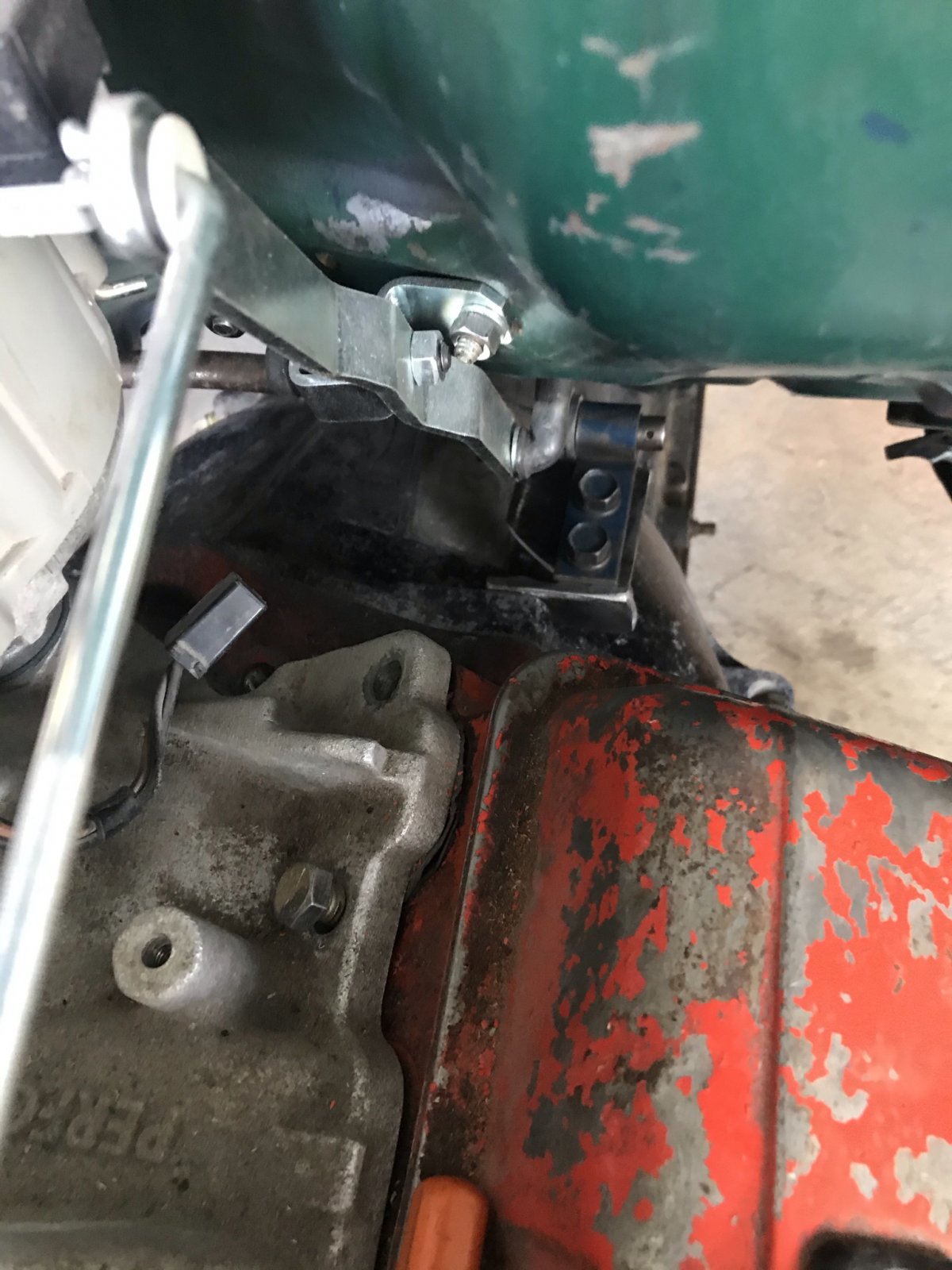

    I took the brake pedal off so I could finish mounting the Mooneyes pedal pad and then shape the stock pedal to fit it. Looks pretty nice now.

    What accelerator linkage are you using? Stock V8? Any pics?

    I like that carpet, you say it feels “cheap”, can you explain further? Also, unless I missed it, do you have a the column shift transmission cover(flat) or the granny/4 speed cover with the hump?
    Kinda looks like the 4 speed cover. Looks like a good fit.

    Mine is not the stock accelerator. But I don’t know what it’s from. It’s older, like 1960’s. It’s one a buddy had laying around that I could get to work with a throttle cable. Like I said, it’s got a throttle cable, it’s a Lokar dual cable setup. I’m not crazy about the look under the hood, but I couldn’t get the actual Cadillac tv Rod to work no matter how much I bent it. The Lokar dual cable setup just plain works. So I’ll live with it.
    The truck was originall a column shift three speed manual. The trans cover is a four speed and is a repop and was on the truck when I got it all those years ago. The carpet fits great, it’s made by ACC. It’s molded and they make it for flat or hump cover. It goes all the way to the back of the cab wall in the rear and about halfway up the firewall in the front. It’s the loop material that feels cheap, and there was a lot of loose loops around the edge. The binding is cheap. And the whole carpet itself is pretty thin, especially compared to the same style loop by ACC I had in my 83 square body Chevy.
    That said, ACC sells different materials. Their Es*** is a plush pile that looks nice. and you can get some of their carpets with a rubber backing good for heat and sound. And they have a Daytona fabric that looks super cool but I haven’t seen it in person. They have a lot of different options in their website.

    Much better than me pulling remnants and slicing and dicing and glueing it together. Thanks for the info!

    Yeah - thx! That looks like a stock V8 one without the throttle connection/lever. I have a Moon foot shaped pedal I want to use and am always curious to see how guys connect these as I have a stock V8 linkage I want to use. Although I think you bolted your pedal to a stock pedal, right? Likin' the details and enjoying the thread!
    On your gas tank, are you planning on keeping it in the cab?
    Looks like you even have the old foot starter mechanism too!

    Yes stock gas pedal and foot starter and tank in cab.

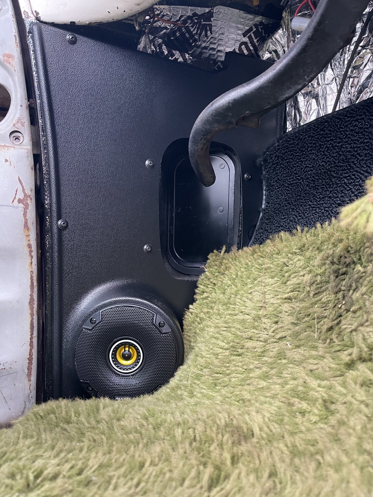

    I’m still waiting on those kick panel cables. They arrived in my town two days ago. I did manage to make the brackets out of metal for the rear speakers. Got them mounted and playing. I need to find some speaker box type carpet to cover the brackets, my local wal mart crafts department was out. I’ll get a pic up tomorrow, but they are small, low profile, and simple but effective.
    So now, just those cables and moving the gas tank. Then I can finally plan out how I’m going to go about stripping the dash of all the knobs and gauges and painting the cabin.
