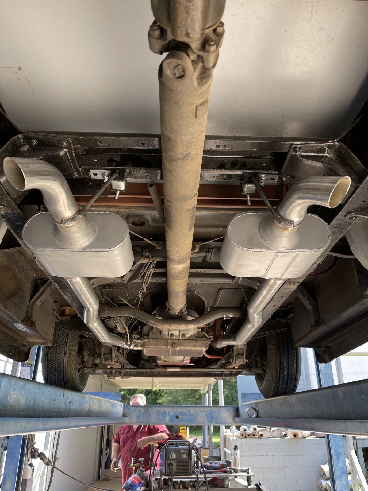

    The exhaust that was on the truck was decent, but was cobbled together at the last minute from what I had laying around and a couple of glass pack mufflers. It sounded decent, but was leaking near the front from u clamps. And it was not properly tucked and you could see the glass packs from the side through the front wheel well space.
    I had some success with a local exhaust shop that did some exhaust on my 83, so I went back to get some pro work done on the 55. The front where it connects to the short chrome down pipes that bolt to the stock chrome exhaust manifolds is now welded instead of u clamps. Went with 2 1/2” pipe that is now nicely tucked up by the frame and invisible from the side and rear at all angles. I used two tiny magnaflow mufflers between the cab and rear wheels with turn downs off the mufflers. The kickstand pipes are now just for looks.
    It sounds incredible.
